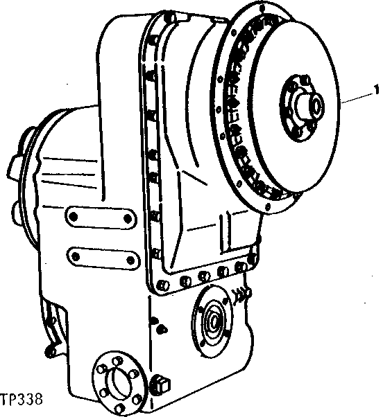

Post Options Post Options   Thanks (0) Thanks(0)   Quote Dnoym N. S. Can. Quote  Post ReplyReply Direct Link To This Post Posted: 02 Dec 2011 at 8:29pm
it sound like the allison
i will try to post a picture.you have
two oil level check plug they
are located at the lower-right front
you can see them in the picture
just above the drain plug next to
the screen cover plate with the six
bolts in it and they are about an
inch apart. to check the oil before
starting remove upper plug oil
should flow if not add till it dose
and replace the plug start the
engine and operate at 1500 rpm
in neutral 1 minute add oil till
level at the lower plug
low main pressure may be cause by
1  low oil level
2  clogged oil strainer
3  clogged oil filter
4  weak or broken main - pressure
regulator valve spring
5  inching control adjustment not
fully retracted
6  oil pump worn
7  air leak at intake side of oil pump
8  internal oil leakage
9  external oil leakage
10  brake hydraulic (or air ) pressure
applying clutch cutoff valve
hth   B:-)    Dnoym

It is not a hydro, it does resemble the one in the picture

Darrel there should be a name plate
on the lower left side of the transmission
with serial number ,part number,and model
number if you can find them post them here
that will tell us for sure  may not be off brand
Ac  545 , ford 655 and i think jd 444
all used the same allison tranmission
back in the mid 60
hth    B:-)       Dnoym
