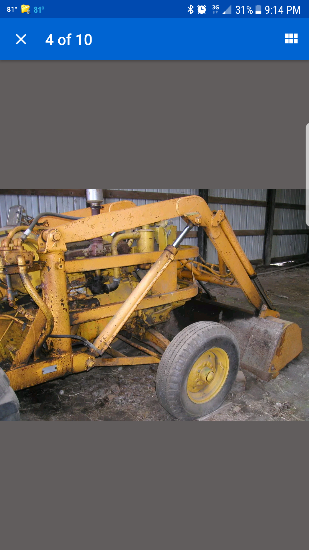

Does this loader have the oil resevoir in frame?

I do not see any reservoir and front pump.  Will it fit on a D15?  Couldn't tell you, but anything can be made to fit with enough welding/butchering.

the RH upright is also a oil tank you can see the pipe plug under the control valve and the bottom part of frame is also part of it, as can be seen with the large hose from the valve goes down to the tank/frame

all loaders have to be modified with dif brackets to fit any tractor!

 That 1/2" coupling with a plug in it that faces to the rear of the vertical reservoir is the oil level overflow.  You give a Farmer a nig welder, a cuttin torch and a 4 1/2" angle grinder,,,and  a couple three days and he'd have that thing mounted and workin,,,,no problem,,,,,ClapClap

Looks a little heavy...
