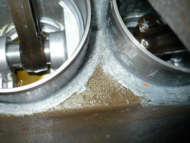

Here's a Wd45 gas engine that the owner tried to rebuild after reading on a diff tractor site just what to do, can you tell some of the things he might have done wrong. He is a nice guy just got some bad INFO and that's going to cost him more money. I hate to see this crap.

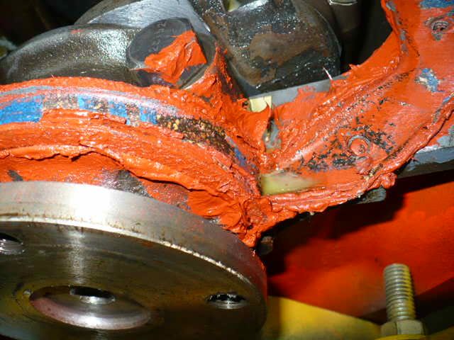

I forgot to add the oil pan still leaked after the goop spread on the block/pan.

What's that around the sleeves and on the freeze plug?
I don't know, but it sure looks like JB weld to me...
I've never done a wet sleeved engine, yet, but I have overhauled more than a few gasoline engines; both small and automotive. New gaskets peeking out look okay, globs of silicone oozing unevenly from various places ruin the pride of a job well done.

I am with you Don, hate to see it. Obviously the guy spent a lot of time cleaning and spent money on new parts then messed the whole deal up.
Many years ago a 350 HP 396 Chevy engine came into my shop that was in identical shape except the main and rod caps were all blue/  Most everything the guy spent $$ had to be replaced after  10 lbs of silicone and Teflon tape bits plugged up the oil screen on the maiden voyage.

Looks like Never-Seize on the liners?

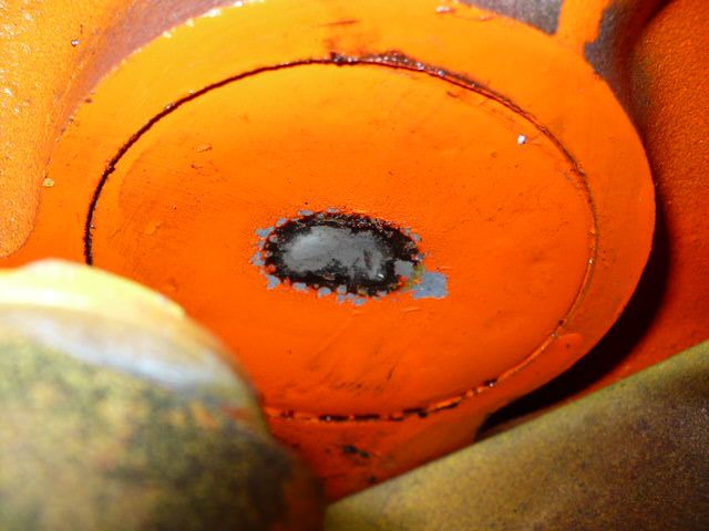

I have not pulled the cam to look at it yet but the one shot is the rear cam plug and it has had the paint burnt off it, so it might be just drove in to hard but it's burnt the paint and that's wrong. I know what site posted the use of silicone on sleeve installing (the clown said to use lots of it on and around the sleeves)and at the time I read this it was hard not to start posting on there just to stop this crap from being spread. the owner used Ultra Gray Silicone around the sleeves and in the O-ring grooves without using the O-rings. I'm not putting this on the owner, he was just doing what was posted to do and that's BAD INFO. The coolant was running down the sleeves after all the crap around the sleeves because the block was broken and had a bolt holding in place. The oil pump screen is covered with silicone.

I wondered what that burnt mark was on the soft plug. So that's from rubbing on the end of the cam?
Just some sloppy work with the silicone all over the block to pan gasket area.

Needed a couple more tubes of RTV and he would be good to go. I do find it strange that if he took the engine apart and found no RTV why he thought it was good to put it together with a gallon of the stuff. Even if he was steered in the wrong direction the engine worked for 50 years as is.
