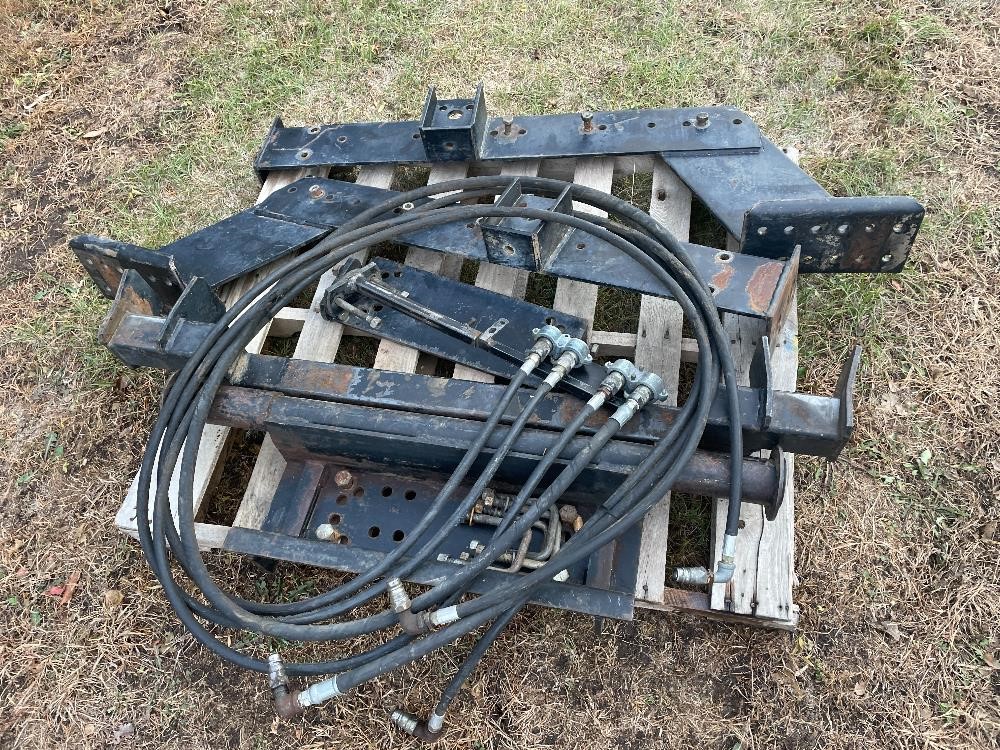

Would you be able to send me pictures of your kit? I think I need to manufacture a kit myself. Westendorf wants $2400 for a new set

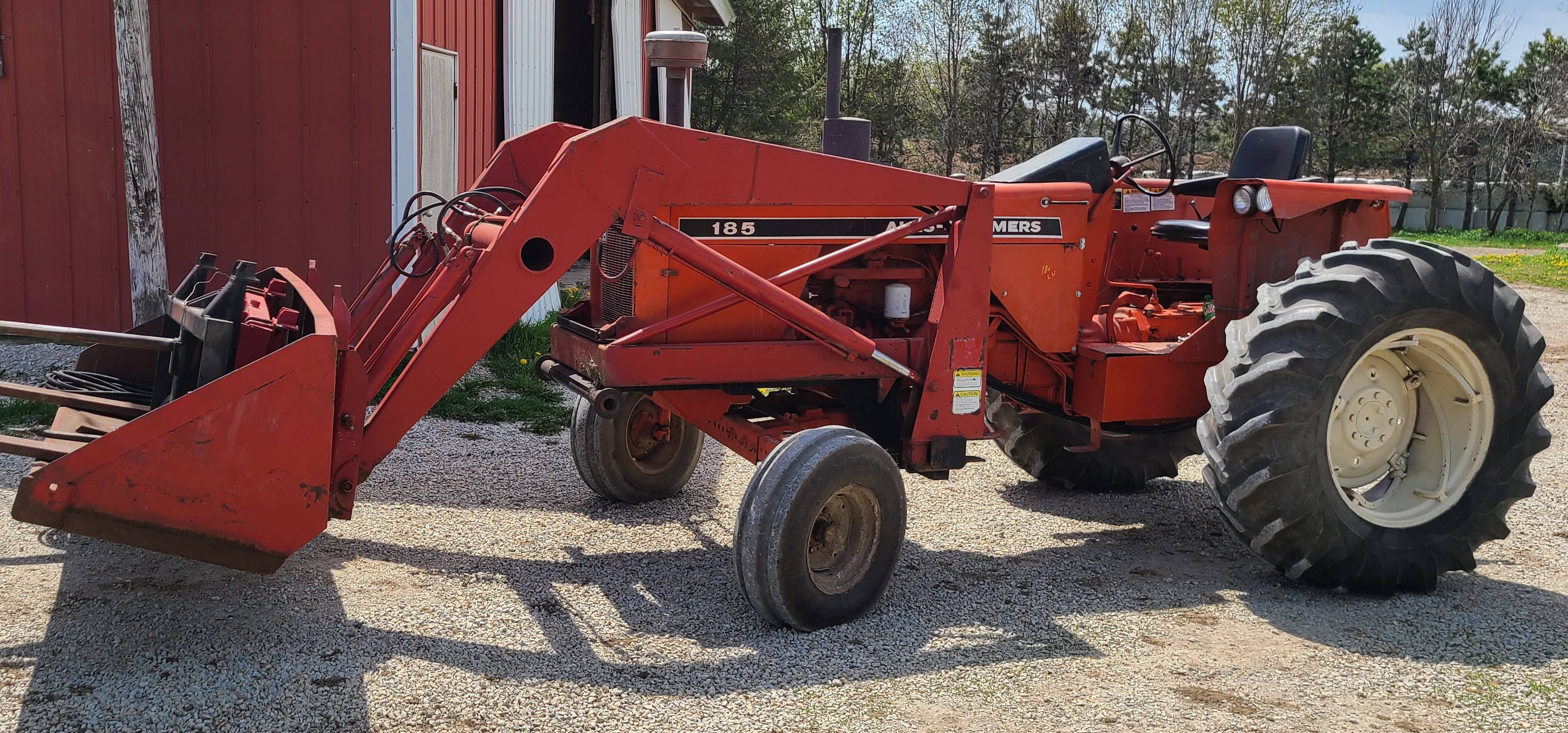

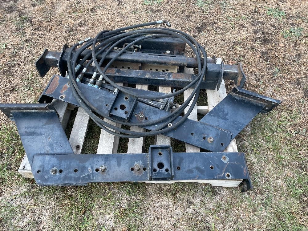

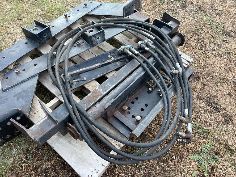

uploads/25332/TractorLoader-WestendorfWL42.jpgHere's the seller's photos from the kit which I ended up buying. It was immediately mounted on the tractor, so I can't provide any other pictures of just the mount brackets.

File upload on this forum is not exactly user-friendly. Give me an email address and I'll send three photos.
