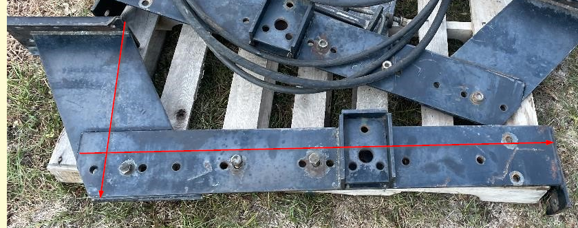

Would you be able to send me pictures of your kit? I think I need to manufacture a kit myself. Westendorf wants $2400 for a new set

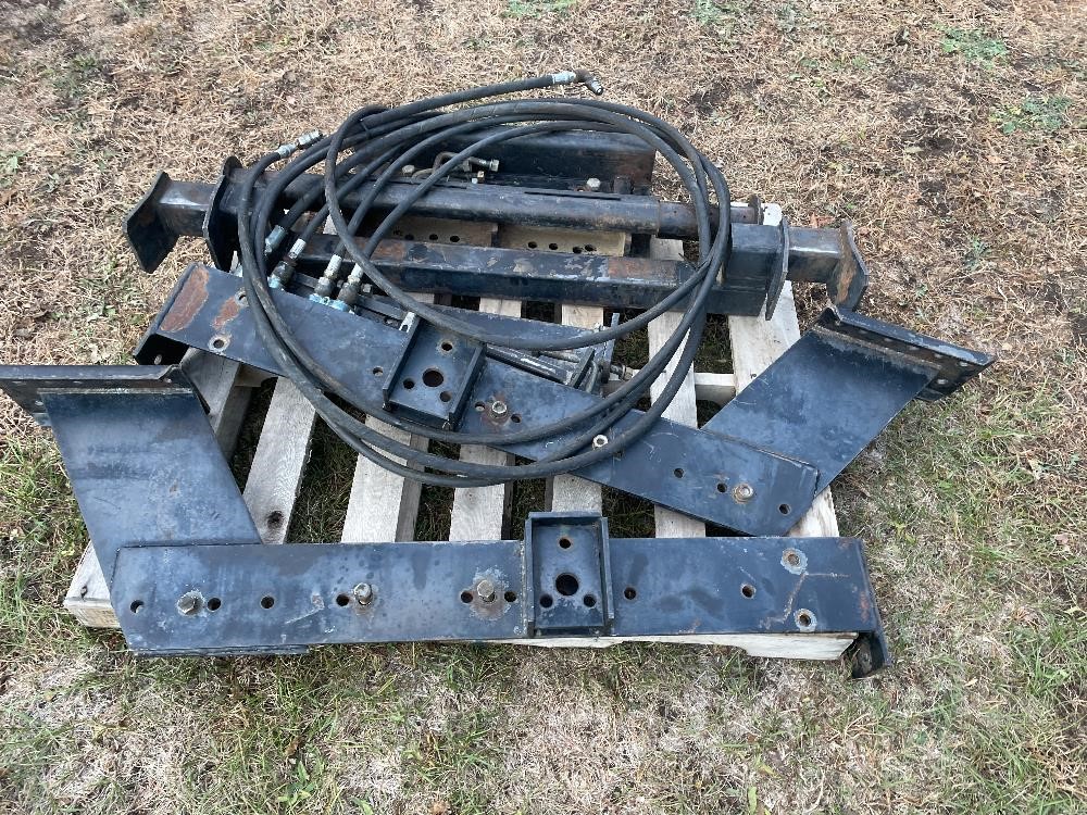

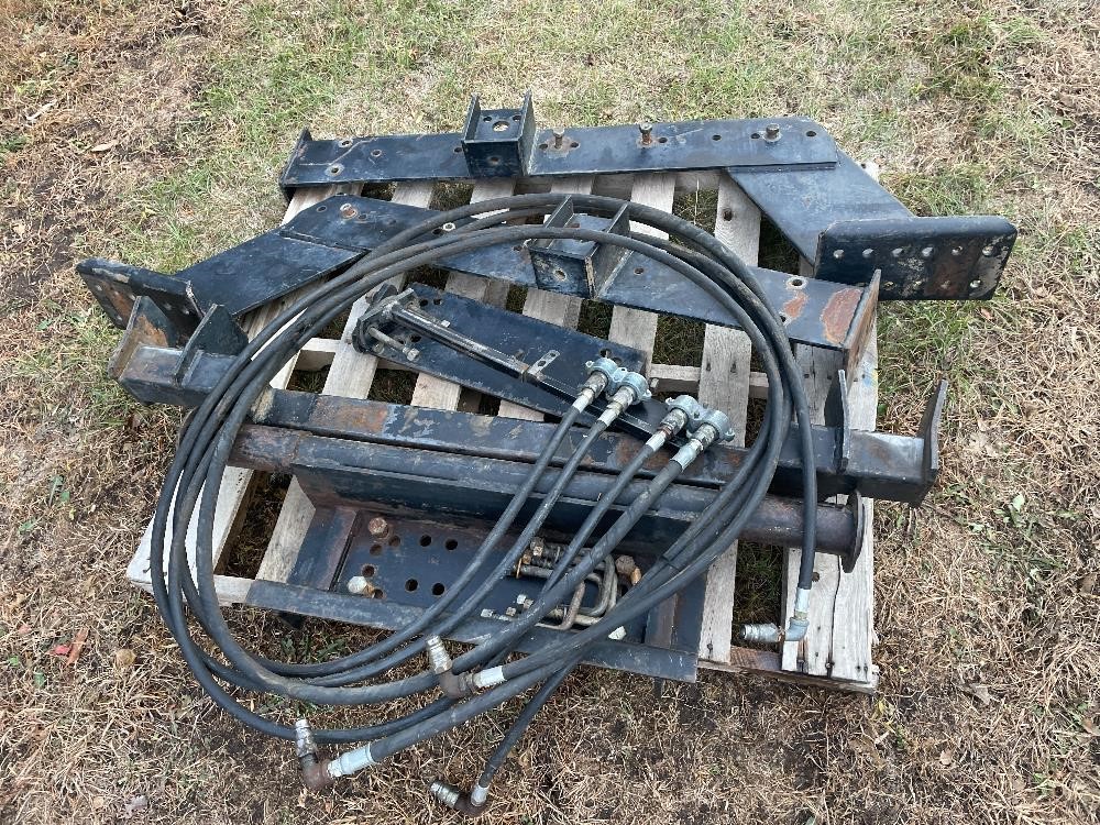

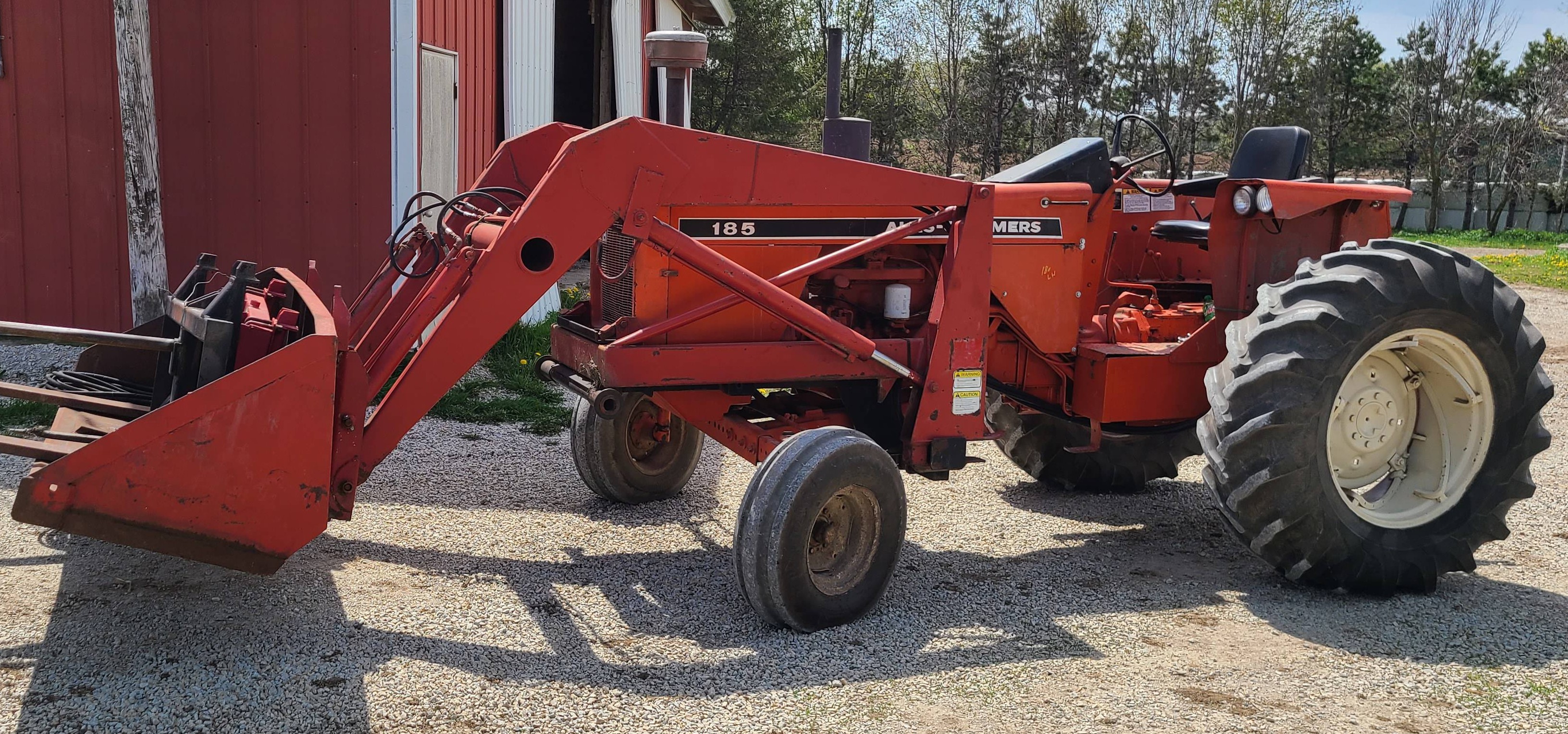

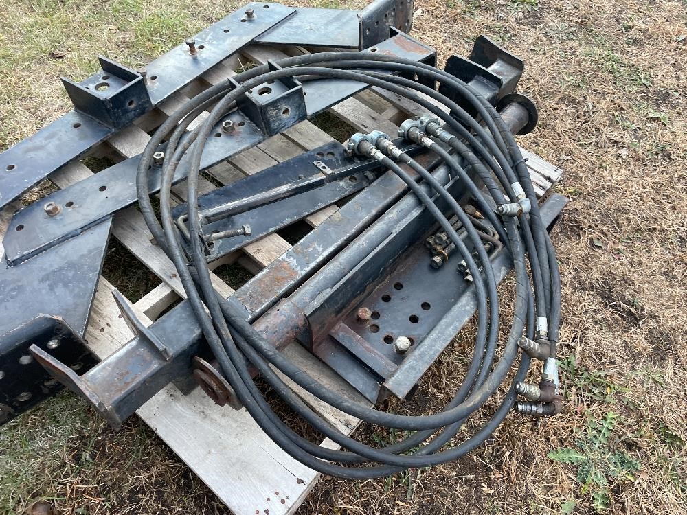

uploads/25332/TractorLoader-WestendorfWL42.jpgHere's the seller's photos from the kit which I ended up buying. It was immediately mounted on the tractor, so I can't provide any other pictures of just the mount brackets.

Don't suppose you could get me two dimensions? Then I should be able to fabricoble a plate and use the brackets I have. The vertical from top of bracket to where the square cross bar mounts, and the full from to back of the plate.
Also, what's the square block do on the sides?

I can take the measurements but it will be a while, my next visit to the farm is planned for April.

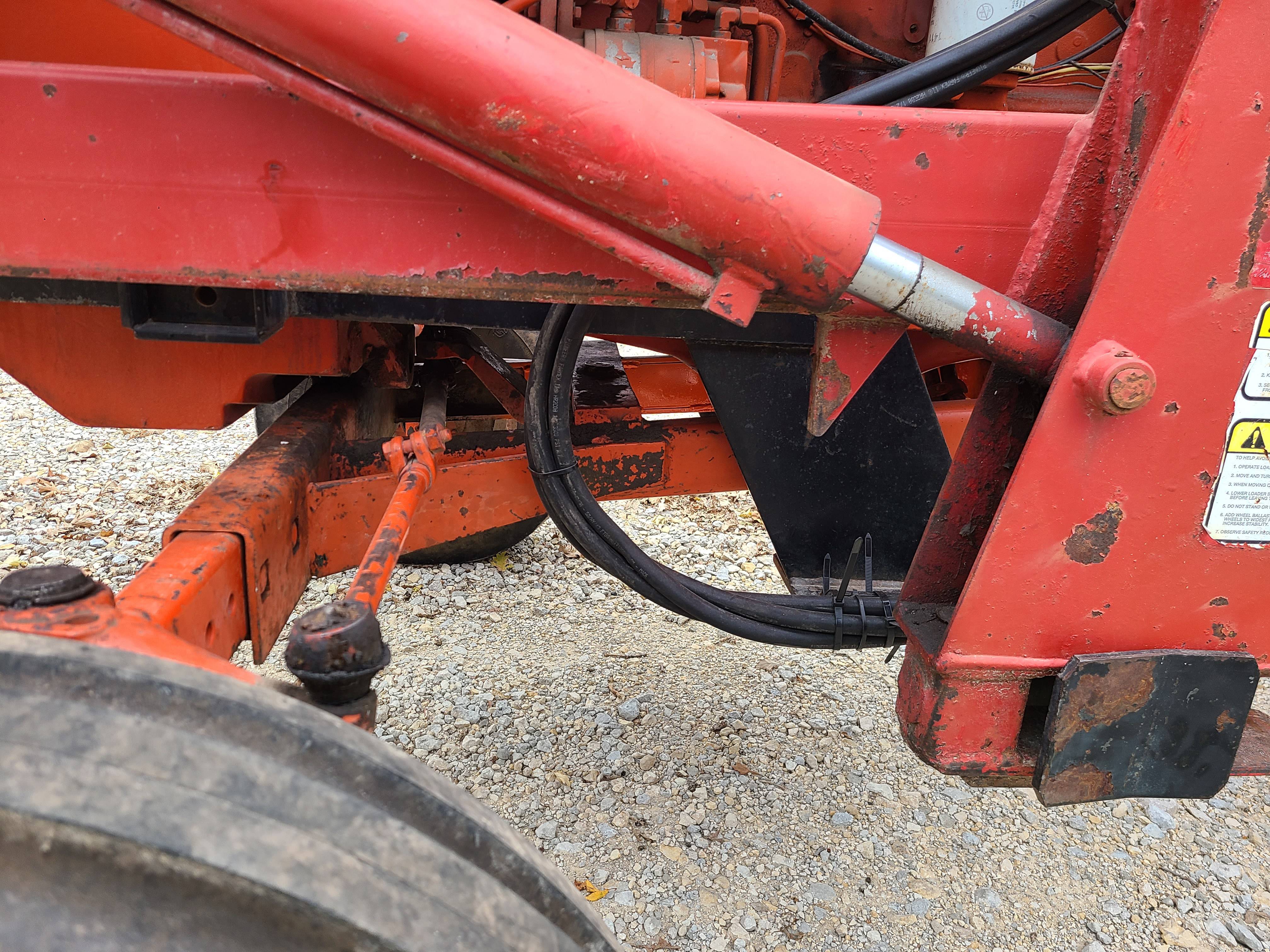

I think the square block is just a spacer to keep the mount from sliding left to right. I attached the best photo I could find. The bolt holes which are visible are not used.
I suppose another possibility is some other kind of Westendorf attachment bolts on here, but I can't think of any example.

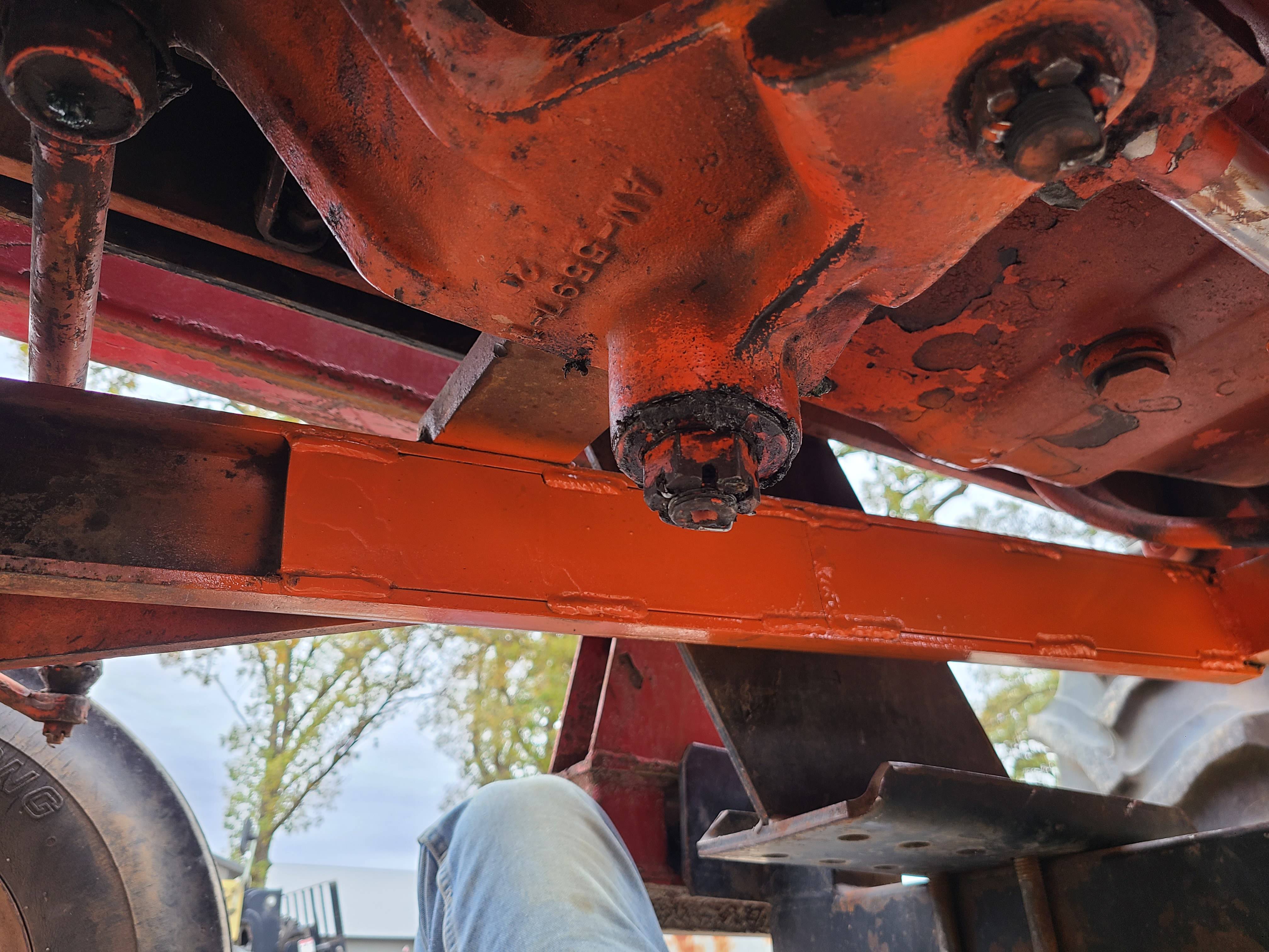

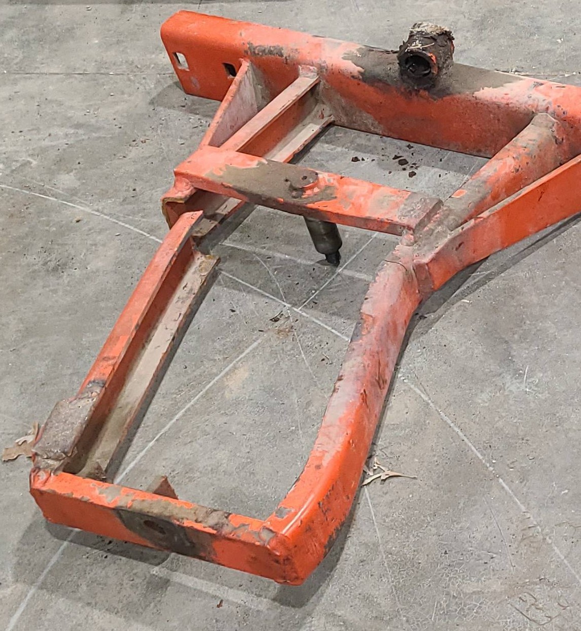

btw I think this loader is on the heavy side for the tractor. My bottom yolk cracked last summer and getting it fixed was not cheap. It cracked in a spot where had been welded before, so that part is apparently underengineered. We welded an extra plate all along the replacement part, should hold another fifty years.

I'll let an eye out for the yoke. I think mine has a weld already, it was a loader tractor with a different loader.

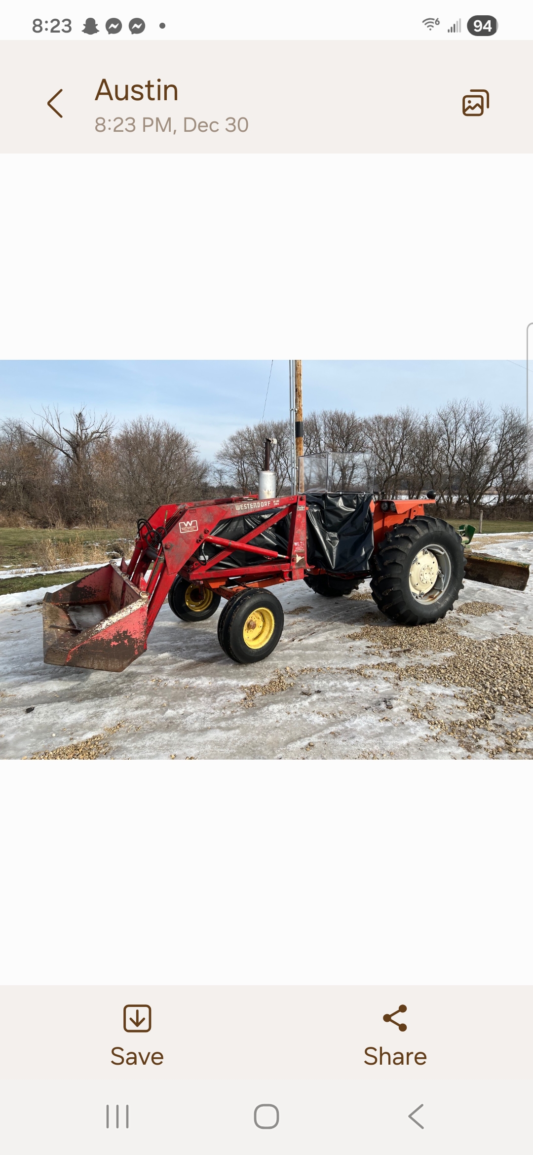

The ends of single steel piece next to corners seem to be the weakest. You can see where mine was welded once in the rear, then broke again in front. We beefed up all along the U-shaped steel where it was alone.
dcm View Drop Down
Joined: 04 Dec 2024
Location: Minnesota
Points: 9
Post Options Post Options   Thanks (0) Thanks(0)   Quote dcm Quote  Post ReplyReply Direct Link To This Post Posted: 30 Dec 2025 at 2:28pm
broken twice in different places
dcm View Drop Down
Joined: 04 Dec 2024
Location: Minnesota
Points: 9
Post Options Post Options   Thanks (0) Thanks(0)   Quote dcm Quote  Post ReplyReply Direct Link To This Post Posted: 30 Dec 2025 at 2:29pm
replaced and beefed up.
