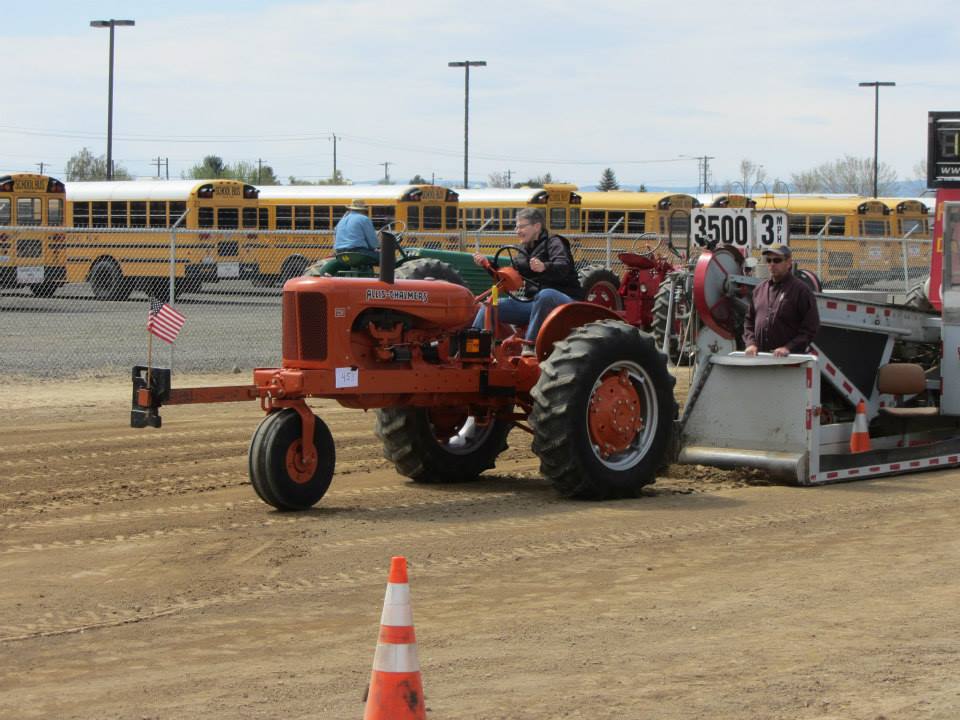

  I want to change my weight bracket set up on my tractor before the season begins. I want to mount the weight "side ways", instead of foreward and I plan on moving to battery up there also. I think I overkilled the one that is on it now. What do you guys use for material? I have eas some that looked weak that seemed to work.. Pics will help.

A couple of years ago I had Phil Brown  aka d17brown on here build me a wd45 pulling tractor.  He did excellent work. the weights are sideways and 11 feet out from the center of the rear wheels.

That is exactly what I am looking for! What thickness is the metal?

Whats on the back?

rear view the final drives are  taped for corn picker mounts so use them holes. the center is bolted to the  factory holes and the draw bar is a non snap coupler front half .

What thickness of material is the front bracket made of?

I'll try to measure it tonight. Last I know Phile had a steel one Just like this for sale. He made a Aluminum one fro himself.

The main beam is 1/2 "  you could build it lighter. mine is 150 to 200 pounds I'd have to weight it.

Thanks for the help on the weight bracket! I posted pics on the facebook page. I added several pounds to the tractor. The bracket was made from 3/8 instead of 1/2. I probably over killed the bracing, I always do. total weight is 125#. The origional that was 16" shorter weighed 65#. Trying to figure out how much I could loose going to 4x15 aluminum wheels instead of the 4x16 steel, with 5.50x16 tires.

I know this was posted a while back, but does anyone know the exact dimensions of the weight rack in that picture? Thanks!

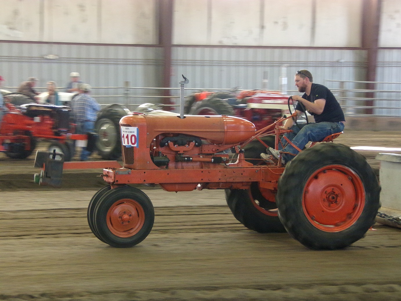

I must've just hit the lottery with my WC. i stripped of the PTO and clutch pulley, built a home-made adjustable hitch, and with me on it, i can put on 80 lbs, and still in 3000lb class. (i'm 205 so thats not a factor). Running 13.9x28 rears with the cast centers. no major modifications done

What is holding that weight in front of that tractor? Is it flying?
rowcropmafia View Drop Down
Points: 208
Post Options Post Options   Thanks (0) Thanks(0)   Quote rowcropmafia Quote  Post ReplyReply Direct Link To This Post Posted: 17 Apr 2014 at 12:23pm
Now I see the bracket. I guess im a little more color blind than I thought lol

Post Options Post Options   Thanks (0) Thanks(0)   Quote Brians1946 Quote  Post ReplyReply Direct Link To This Post Posted: 23 Apr 2014 at 10:19pm
That bracket did the job, until in the next class i piled on more than i usually do, then bounced the front end and lost some, DQ'ing a full pull, DOH! so this year i'm going to borrow some from this idea
And as far as the hood, Its almost time to start teardown for paint
