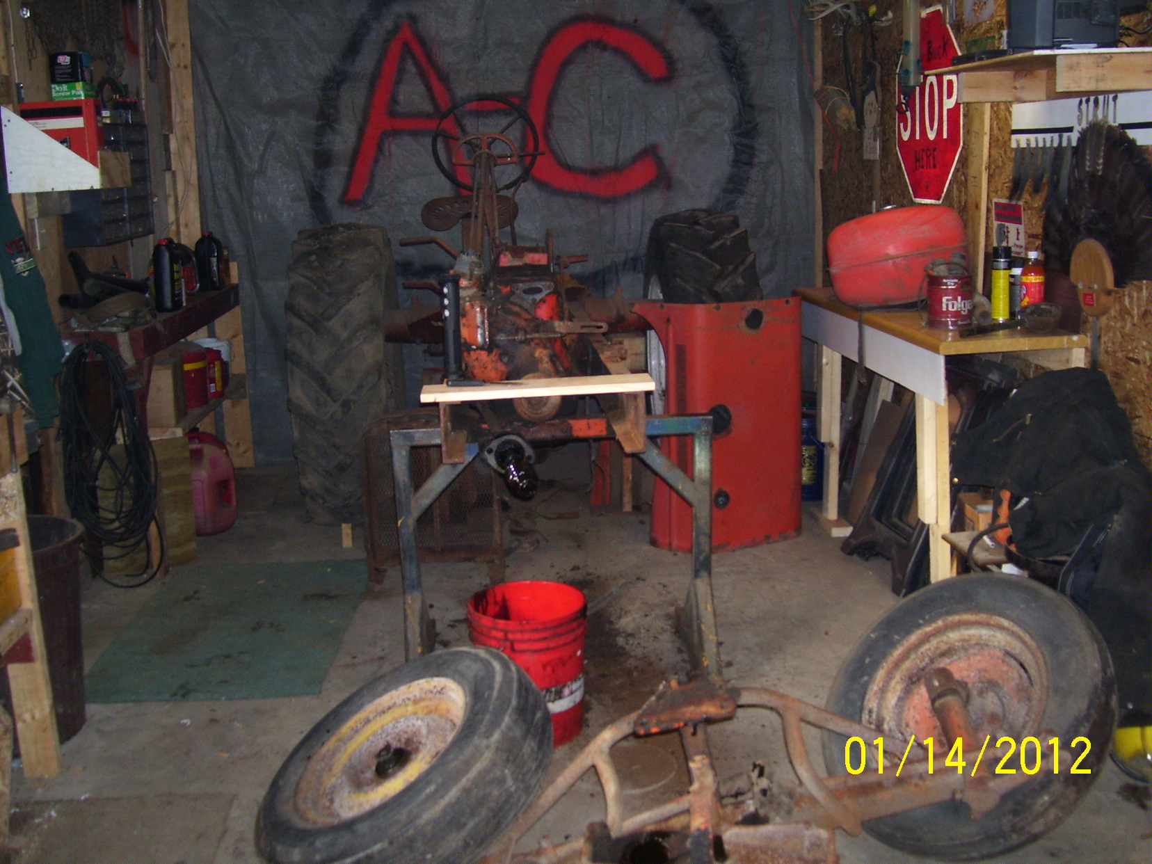

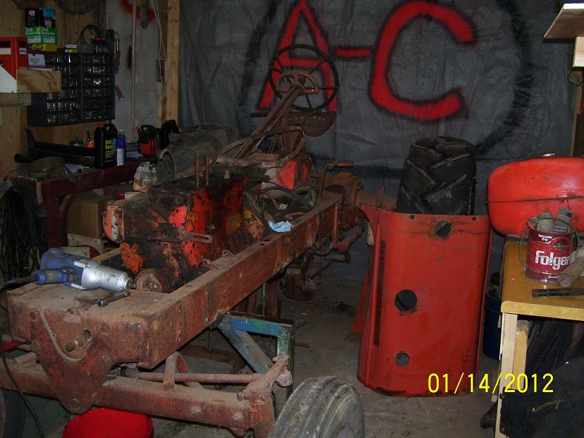

I picked this tractor up 4 or 5 yrs ago and she was tired, saved it from going to the junk hope to get some Pic's of it on here as work progess go's along, it's a tough looking  old wd45 ser#234678 beleive a 1956, 4 bolt wide front, I have been picking up a part here and there, So I think have enough to work on her and maybe bring here to life!
I'll surely be asking for HELP on this one as I go along, My nephew said last night WOW you'll have your work cut out on this one as we loaded it on the trailer at Dads to bring it to my place.

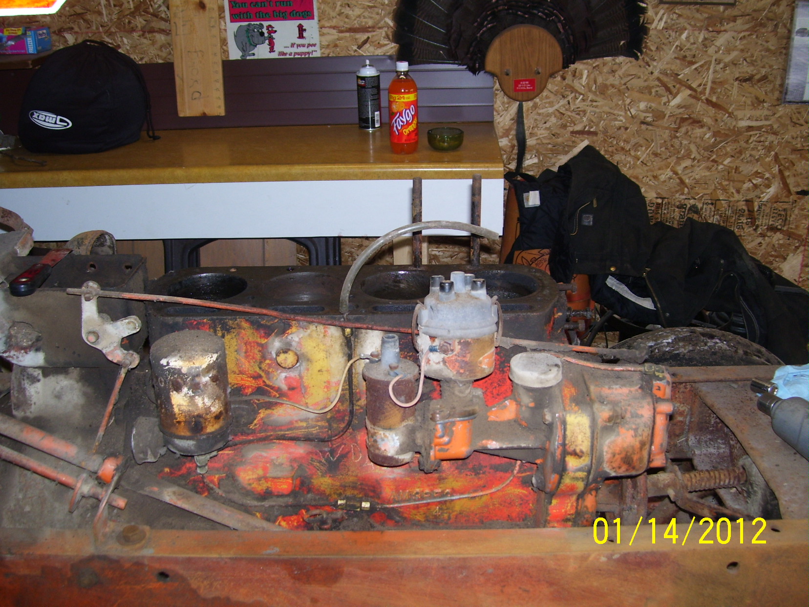

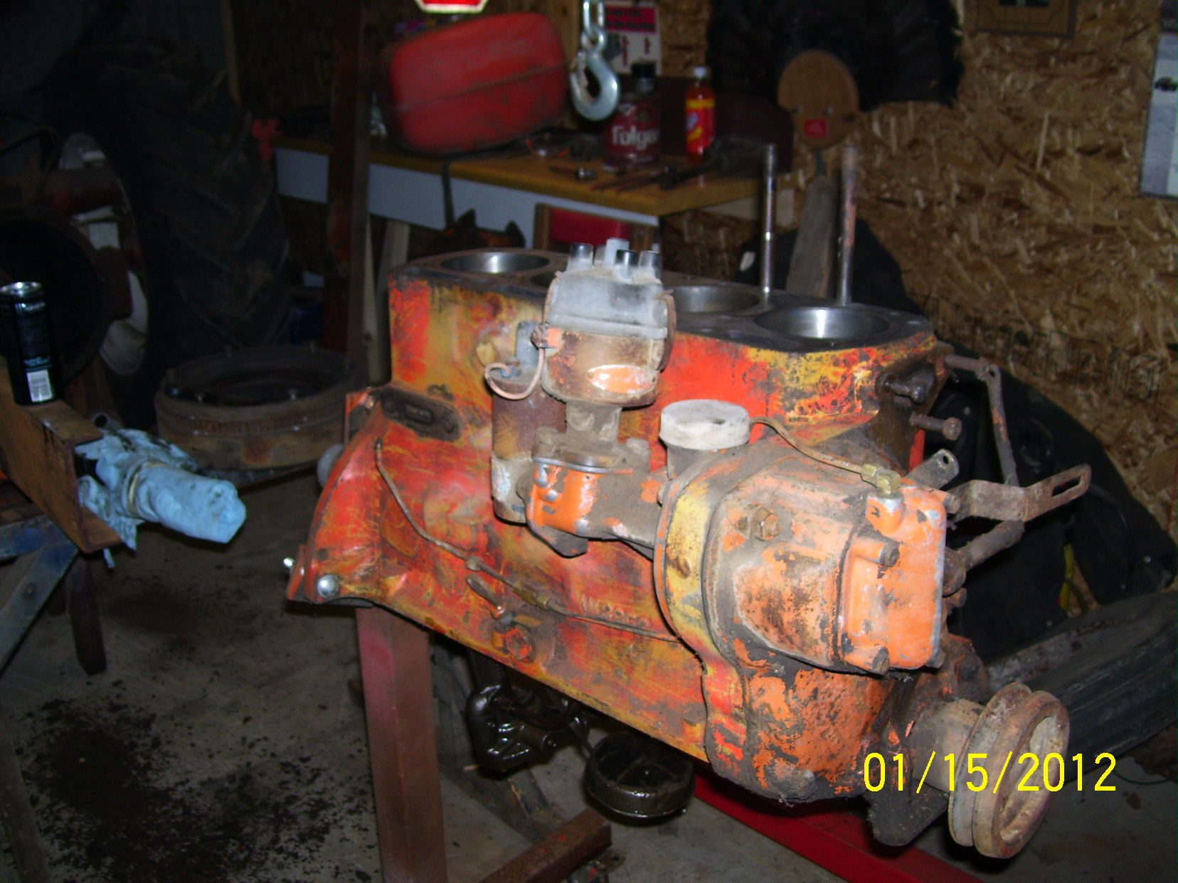

Ok I got Started working on the WD45, Here is some Pic's I was going to just pull the old Engine and put in one that already runs, but this one wasn't as bad as I thought it would be, Already has M&W kit in it so I'am going to run some of the pic's then ask some Qustions on the last couple pic's.

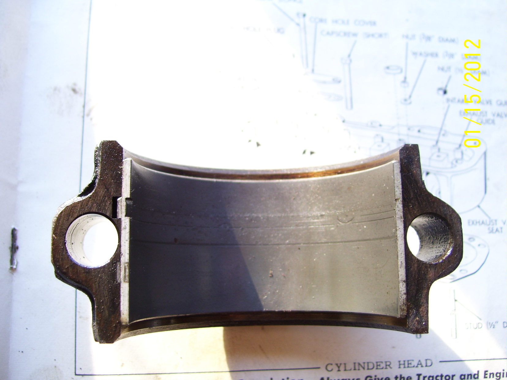

And last but least crank looks fine and has been redone, but I believe the bearings are 30 over, this was what I found on the bearing.
DAB 72
67-25
7440=T
030
and I'am going put in new bearings.
