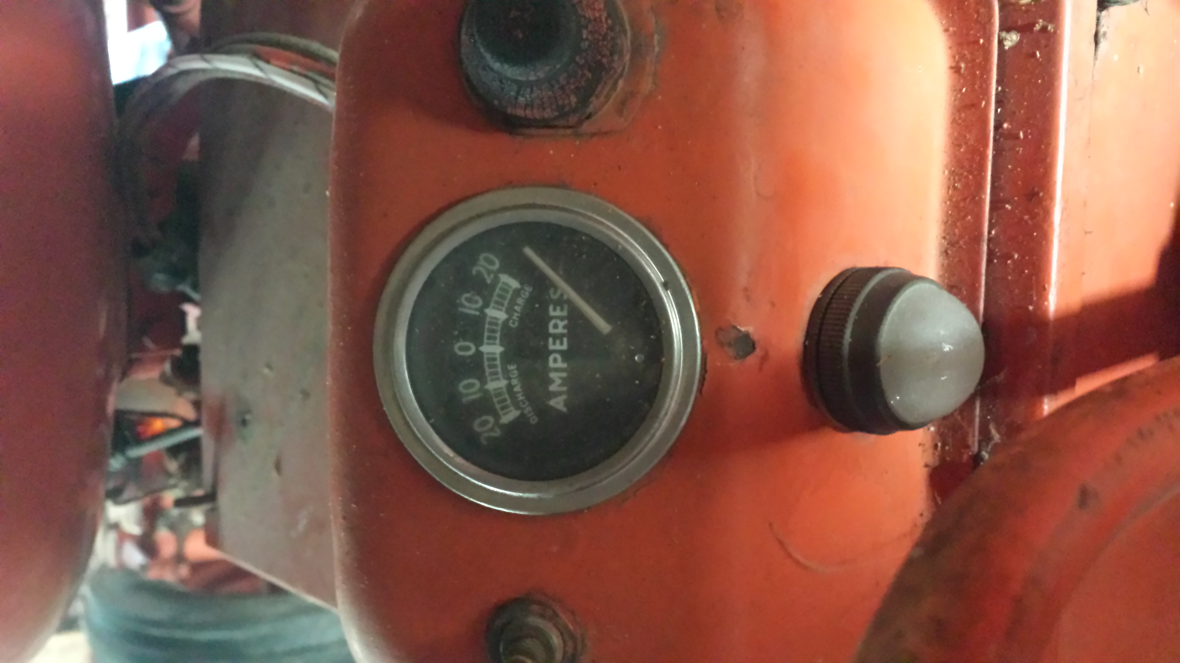

Post Options Post Options   Thanks (0) Thanks(0)   Quote banjerpicker Quote  Post ReplyReply Direct Link To This Post Posted: 24 Aug 2015 at 7:54pm
Got it too full throttle, and the needle went crazy. Looks like the alternator is good.
DougS View Drop Down
Joined: 03 Nov 2011
Location: Iowa
Points: 2490
Post Options Post Options   Thanks (0) Thanks(0)   Quote DougS Quote  Post ReplyReply Direct Link To This Post Posted: 24 Aug 2015 at 8:34pm
That's why you want a larger ammeter when you install an alternator. You may want to consider something as large as a 60-0-60.
