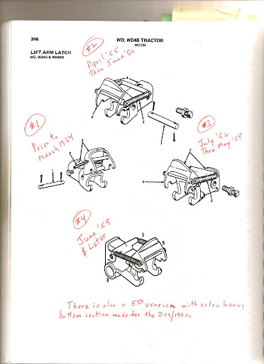

Just checked my Feb. 1957 `45 parts book, and it shows 3 different designs used on the WD/ WD45.  The first design appears to be all steel, used prior to 1954.  The second design is steel with cast covers used Jan 54 thru March `55.  The third design is all cast, used April `55 thru June `56.  Hope this helps.  None have the bottom loops  as seen on the D17 for the solid  connecting bar between the latches.

From my WD-45 Parts Catalog; I believe my notations are correct.
