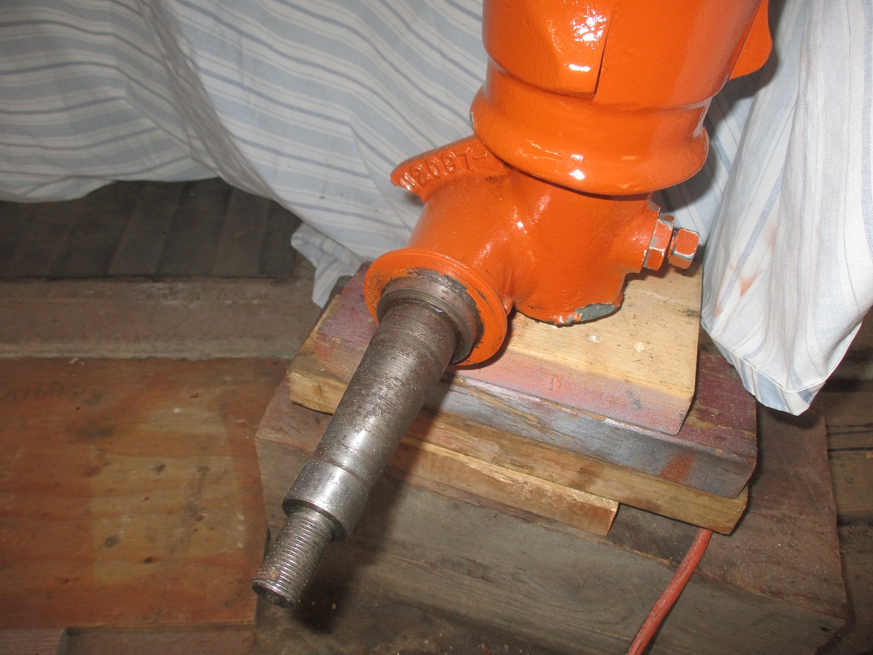

Post Options Post Options   Thanks (0) Thanks(0)   Quote IBWD MIke Quote  Post ReplyReply Direct Link To This Post Posted: 22 Mar 2021 at 8:02am
The spacer is there. I have a couple of threads regarding this. You can see a spindle without the spacer in. Going to post an update in the gauge wheel thread directly.
Here is a link to the spindle removal thread, it doesn't really show the pieces like I thought. I'll take a picture of the parts and post it here in a bit.

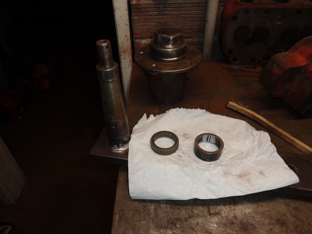

Post Options Post Options   Thanks (0) Thanks(0)   Quote IBWD MIke Quote  Post ReplyReply Direct Link To This Post Posted: 22 Mar 2021 at 8:20am
Here is a picture of the spindle, (welded in a piece of plow frame) the original spacer in question, and the additional one I needed for the gauge wheel.

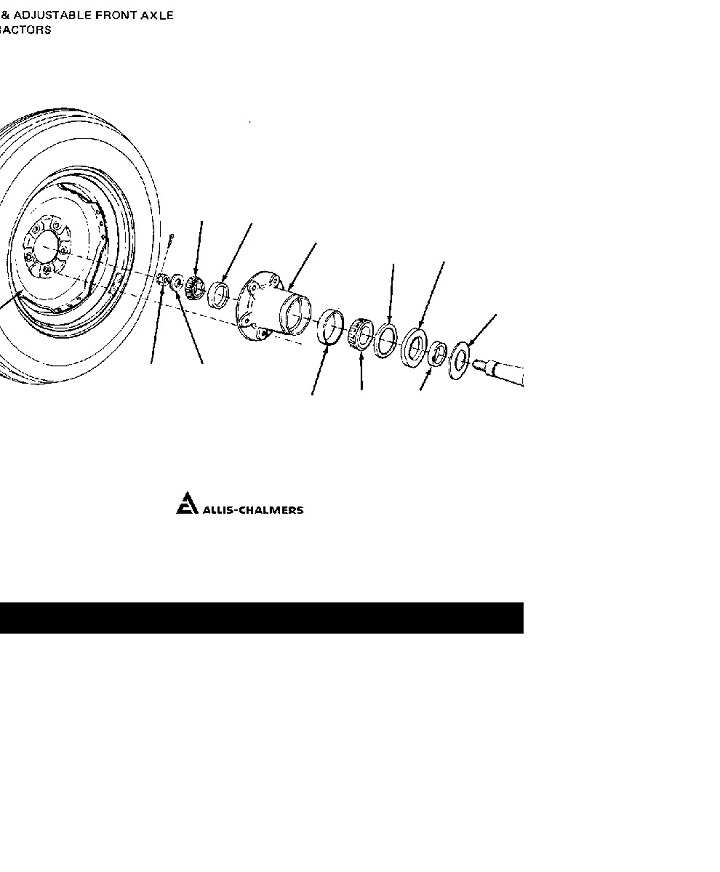

Post Options Post Options   Thanks (0) Thanks(0)   Quote ac45dave Quote  Post ReplyReply Direct Link To This Post Posted: 22 Mar 2021 at 9:01am
Tim, maybe this will help

Post Options Post Options   Thanks (0) Thanks(0)   Quote Tim NH Quote  Post ReplyReply Direct Link To This Post Posted: 22 Mar 2021 at 9:24am
Thanks both of you guys. I thought those bushings that are on there are all I needed. Mike , when you got the spindle block off, can you see the seal up in there to change out.
  Tim
IBWD MIke View Drop Down
Joined: 08 Apr 2012
Location: Newton Ia.
Points: 4143
Post Options Post Options   Thanks (0) Thanks(0)   Quote IBWD MIke Quote  Post ReplyReply Direct Link To This Post Posted: 22 Mar 2021 at 9:37am
Tim, I never removed the spindle block. Pulled the spindle from a junk pedestal that was just sitting on the ground.
