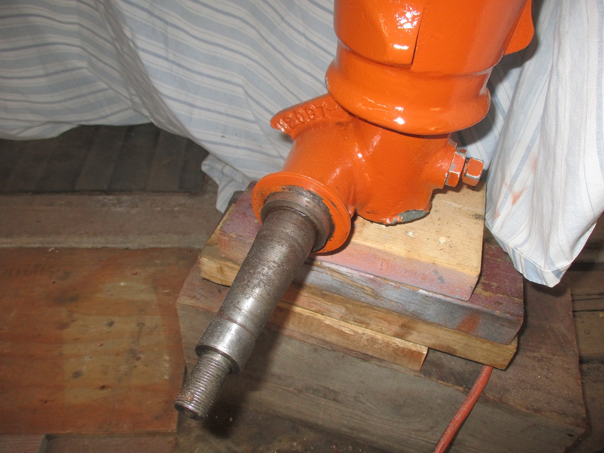

The front spindles require bearing spacers. My question is are they on there already, or what looks to be spacers just part of machining the spindle.
  Tim

The spacer is there. I have a couple of threads regarding this. You can see a spindle without the spacer in. Going to post an update in the gauge wheel thread directly.
Here is a link to the spindle removal thread, it doesn't really show the pieces like I thought. I'll take a picture of the parts and post it here in a bit.

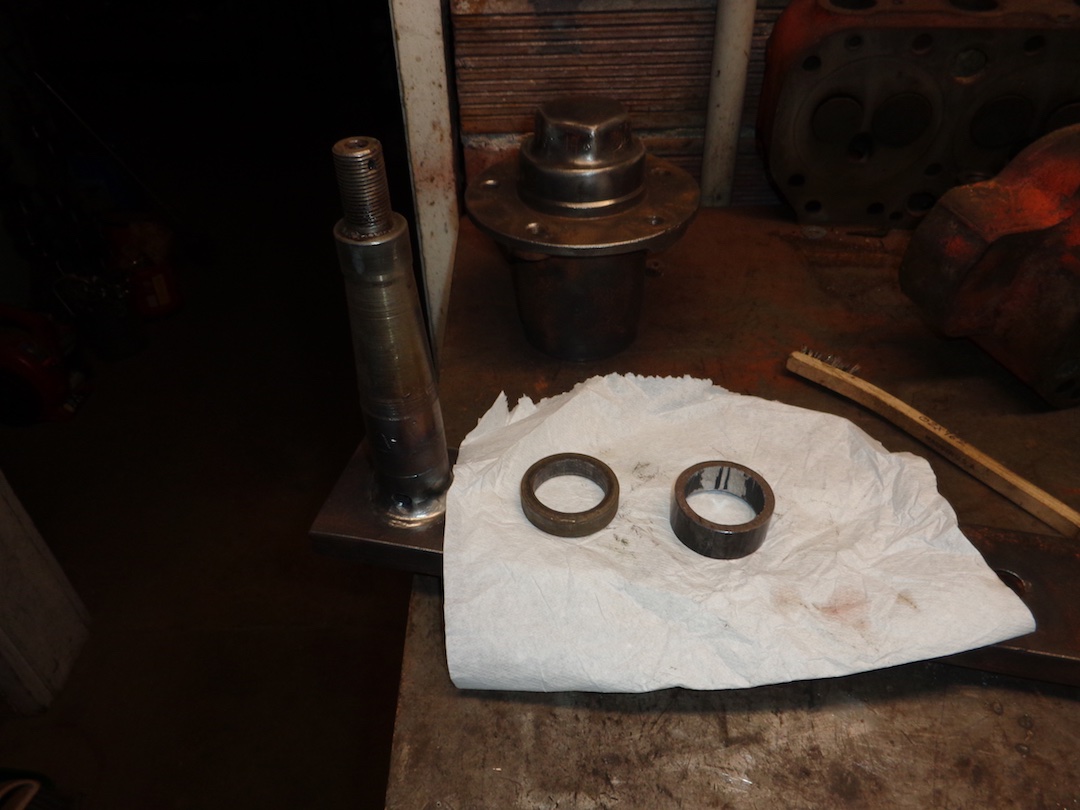

Here is a picture of the spindle, (welded in a piece of plow frame) the original spacer in question, and the additional one I needed for the gauge wheel.

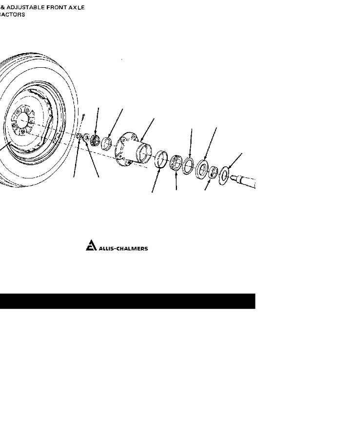

Tim, maybe this will help

Thanks both of you guys. I thought those bushings that are on there are all I needed. Mike , when you got the spindle block off, can you see the seal up in there to change out.
  Tim

Tim, I never removed the spindle block. Pulled the spindle from a junk pedestal that was just sitting on the ground.
