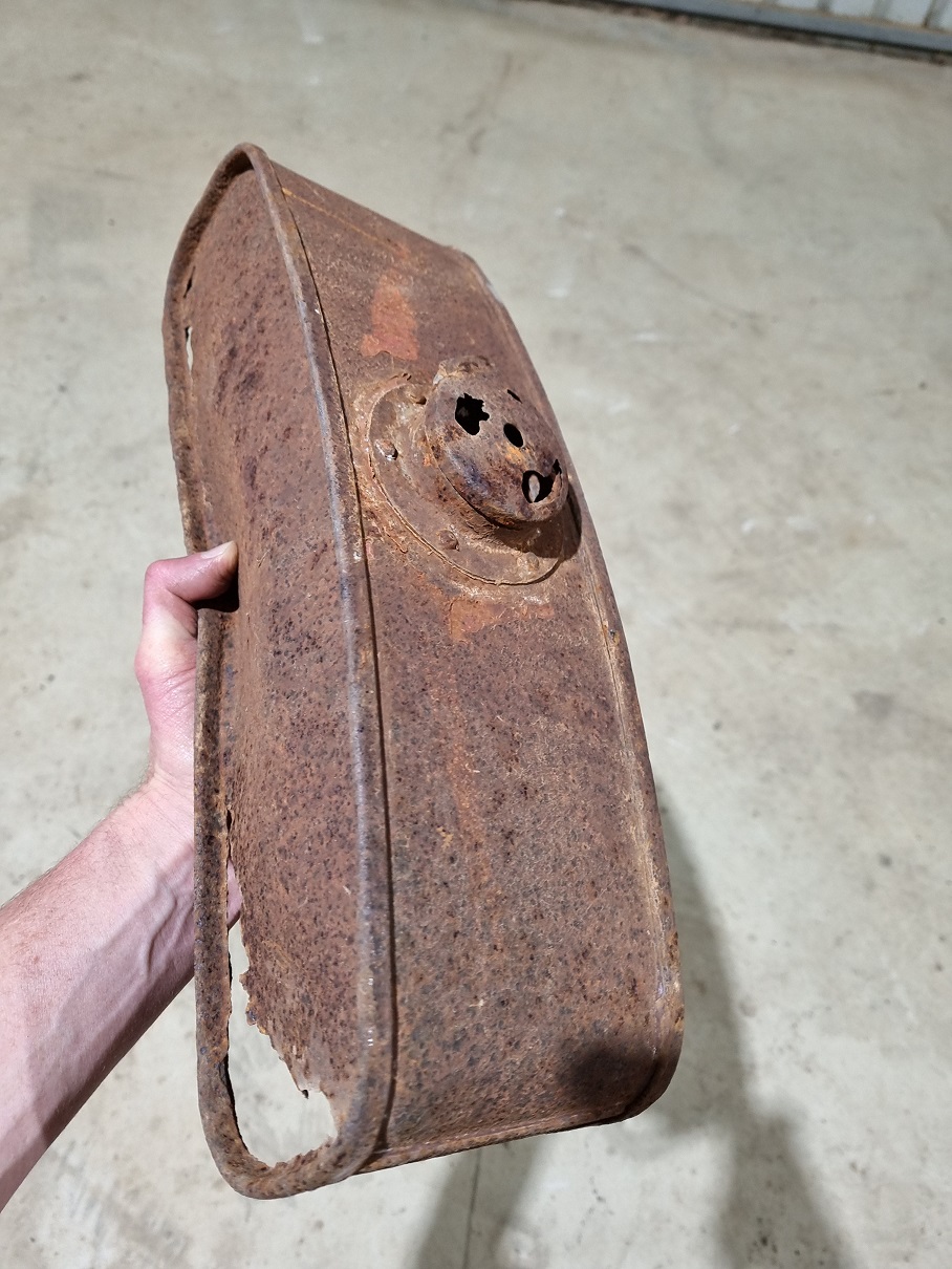

Well thanks to this forum, Mark and I agreed on price and today the tank arrived! I will get some photos over the weekend as I have also had a few other items arrive for this project.

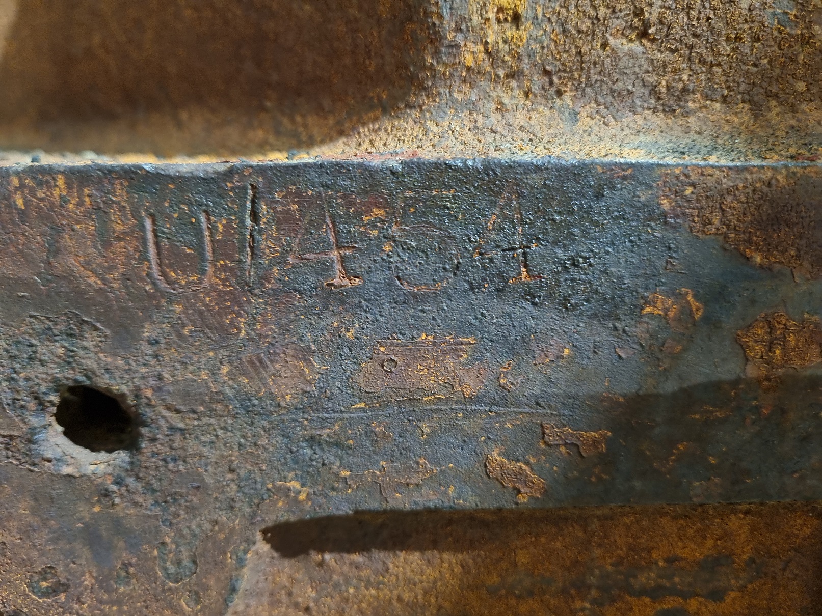

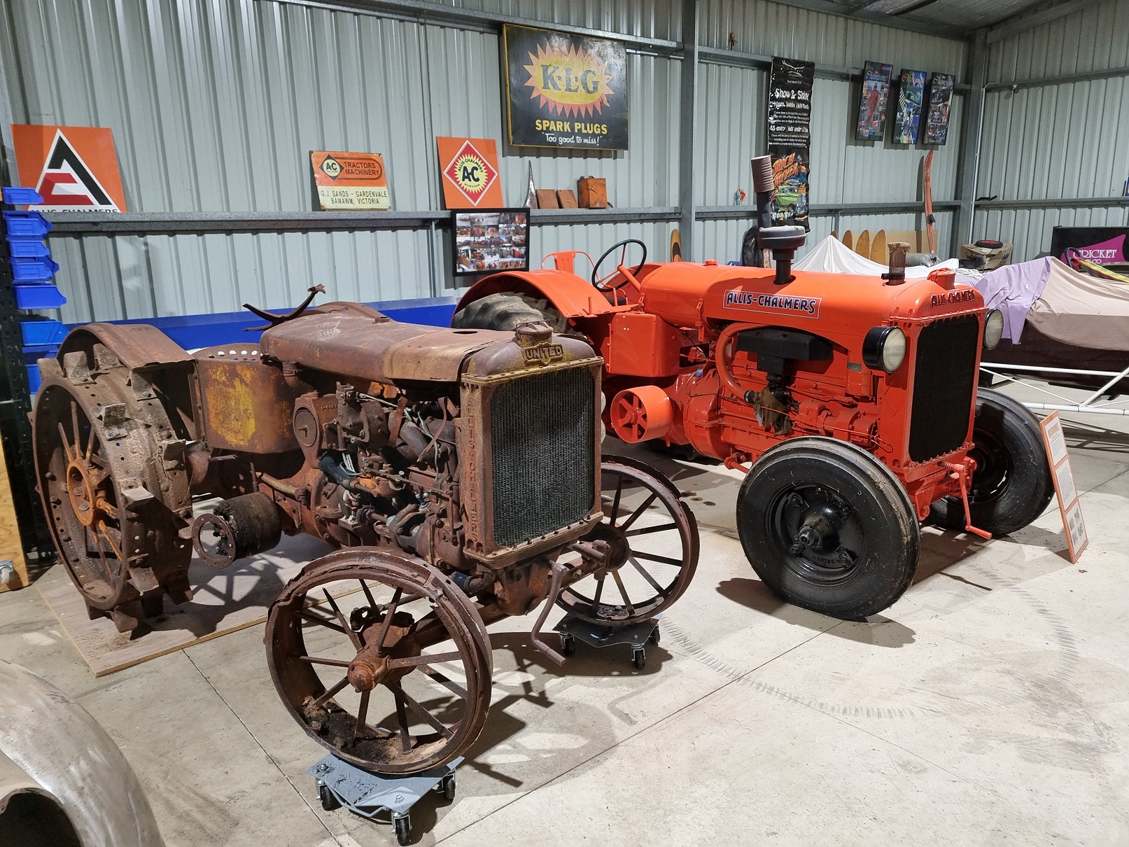

Originally posted by Layne Layne wrote:
Nice tractor! Your serial number is 1454. The brake should prove that, as they switched from a brake pedal to a hand lever at #1008. Mine is #1005 and has the pedal. Mine also has the 1 made with a chisel instead of a proper number stamp, just like yours. Later ones I've seen had a proper number 1.
Thanks for that, I suspected it was a rough 1 given how untouched the tractor is but given how crude it was I couldn't be certain.
Thanks Layne!

You two are worlds apart Mark, but I'm betting he'll want your tank!
Its good to see a younger man want to tackle something like this project Travis!  Keep the pics coming and GOOD LUCK with this vast undertaking!

I have a good one of those tanks

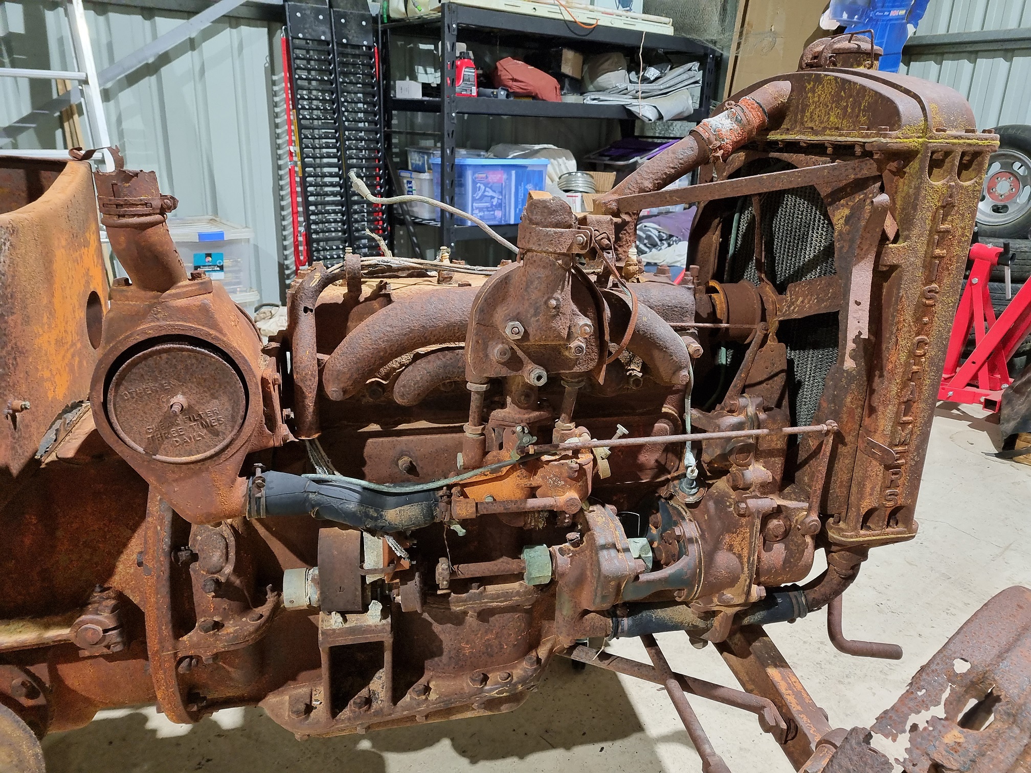

Very interesting low grade fuel manifold and carburetor.  Similar design to a distillate manifold used on 20-35's that seems to more common outside the US, but still very rare.  Will be interesting to see it disassembled.

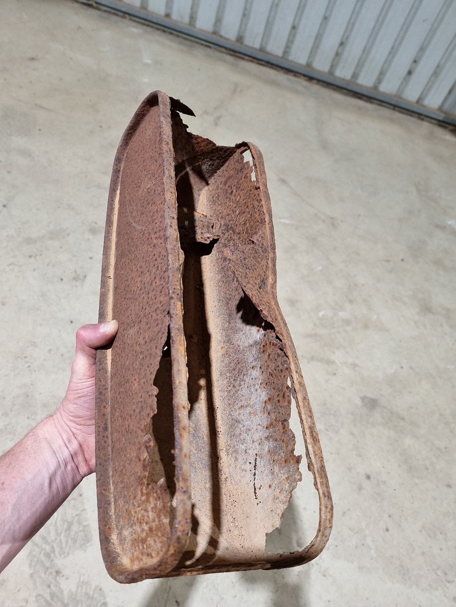

The starting tank has seen better days, but on the plus side I have a template!

Originally posted by Jacob (WI,ND) Jacob (WI,ND) wrote:
Travis, I'm humbled at the fact that you are inspired by my crazy projects.  But I guess that is what it is all about, trying to encourage others to tackle a project a little bigger than you are comfortable with.  That is how you learn and increase your skills.  I know I have the last couple of years.  It's funny how you mention me, because as I look at your pics, I am drooling, this is exactly the kind of piece I am drawn too.  A project!  You have absolutely nothing to loose by taking it apart and fixing it, because it is no good the way it is (besides yard art, and it's too nice for that).  Keep us posted, I'll be following this with much interest!
To me the serial number looks like U1454 ?
I'll be the first to admit that I don't know much about the U world though, I have yet to dive down that rabbit hole.  I guess I better be careful, you may make me want to get a U after watching your restoration....
Thanks Jacob, although I don't think it will be as fast as your 6-12 restoration!
With the serial number I posted it as I am unsure, the 1 seems to be punched at a different angle and could be a / ? I have a UM powered U and the number on it is very clear and no / . Hoping someone may know for sure.
Apart from the rear wheels being free, nothing else is so far. I will start a rough plan of attack and hunting a few basic odds and ends soon.

The serial number below appears to be U454?

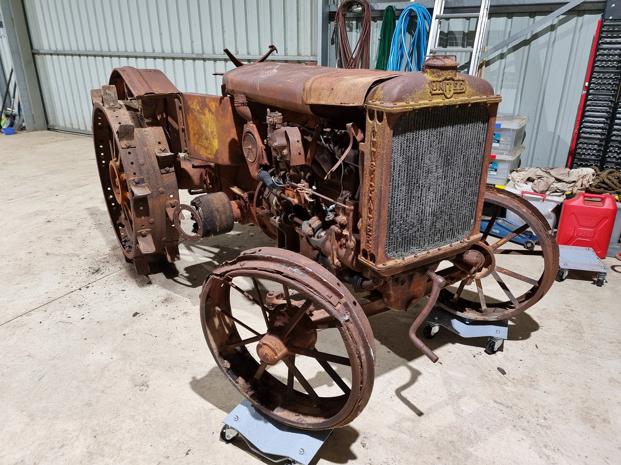

Originally posted by ac hunter ac hunter wrote:
     Wonder if anyone ever cleaned the filter 3 times a day.
      The Chrysler is an interesting looking vehicle.
     The center of the engine tag is interesting too. "Powerful as the nation".
     We will all be watching for updates to your progress on this project. Thanks for the info and pictures.
I certainly think it's overdue now!Wink
      The Chrysler is an interesting looking vehicle. I have seen a very few Airflows but didn't recognize yours as such. Guessing that is the source of your forum name; obvious now. Hope you can find all the parts you need.

Clean filter three times daily? That would've been fun. I guess I've never paid attention to the air filters on these before as I've never had anything older than a late '39 B with the more standard oil bath air cleaner style from on up into the '50s.

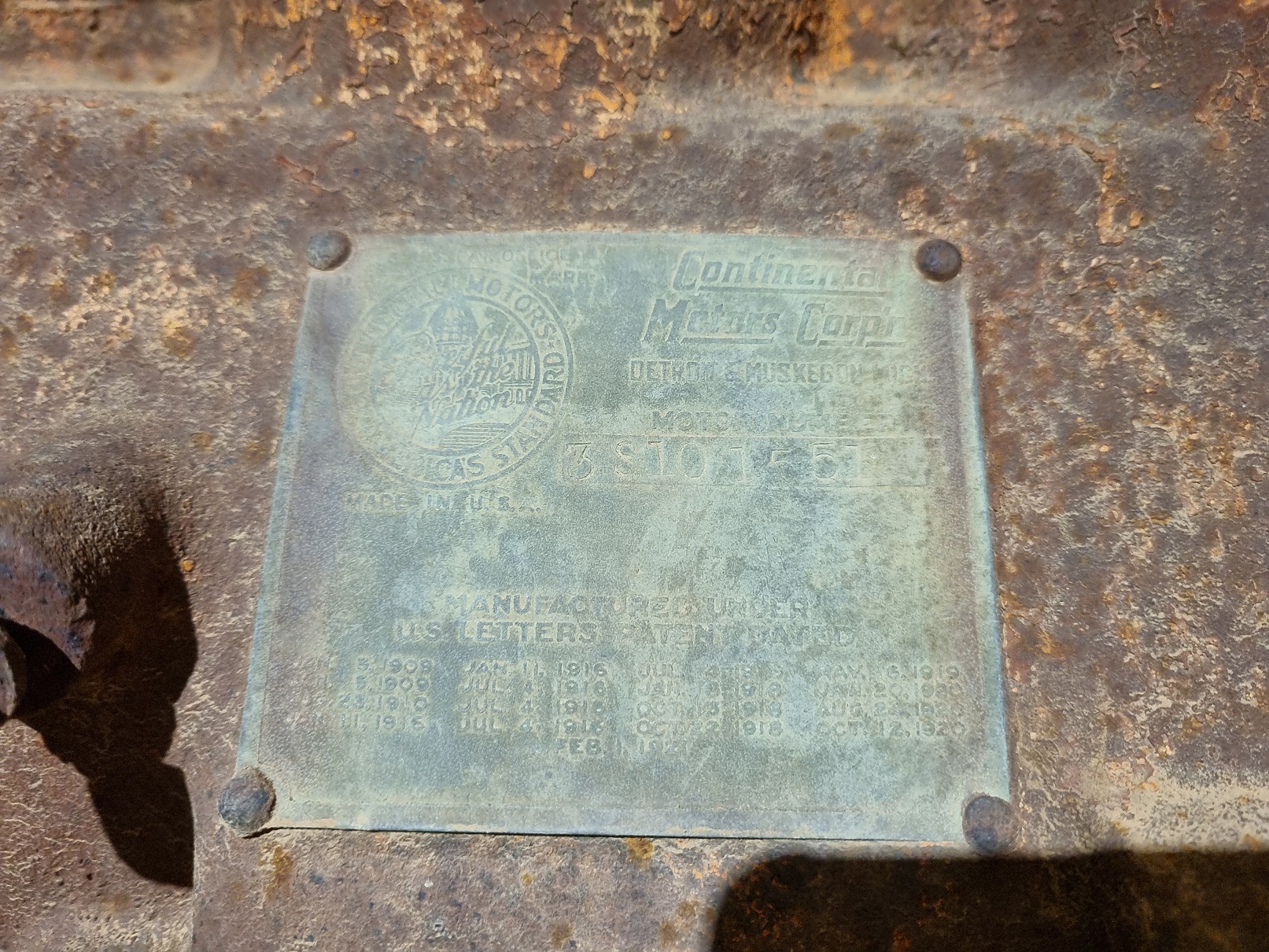

Thanks for the picture of the tag. Appears to be standard earlier S10 markings.

Originally posted by GreenOrange GreenOrange wrote:
How is the Continental engine tag stamped? Any different than a gas model?
Here is the tag;

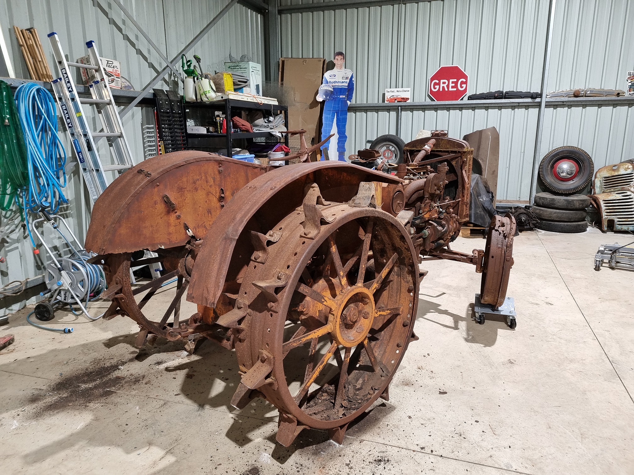

     Very nice looking A, bet you enjoy it a lot.  Hope you keep us up to date on the United restoration now that you have our attention. Seems you have at least a couple of rare items on that tractor.
     I see in the background of a couple of  your pictures some AC orange chairs and an unusual, at least to us here in the US, looking automobile. Looks like you may be working on that too. Can you tell us what it is?  It's more efficient to have more than one project at a time you know.
     Thanks for the pictures, Russell.
Hi Russell,
The car is actually a 1934 Chrysler Airflow sedan, factory RHD. So far I have completed some bodywork on it but most of my time since finishing the model A has been located missing parts for it. The Airflow is a long term project. The United has just jumped the queue!

GreenOrange View Drop Down
Location: Wisconsin
Points: 851
Post Options Post Options   Thanks (0) Thanks(0)   Quote GreenOrange Quote  Post ReplyReply Direct Link To This Post Posted: 14 Jul 2021 at 1:40pm
