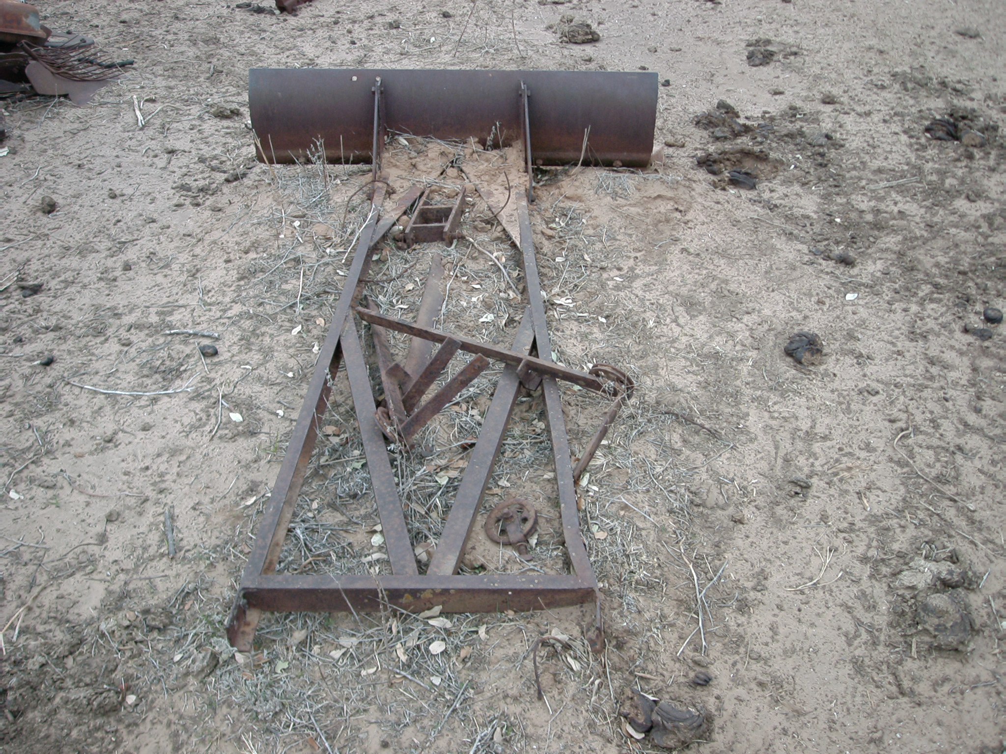

Got one, but I've never seen it mounted.  My Grandad said he used it to build a small stock tank and some terraces.
