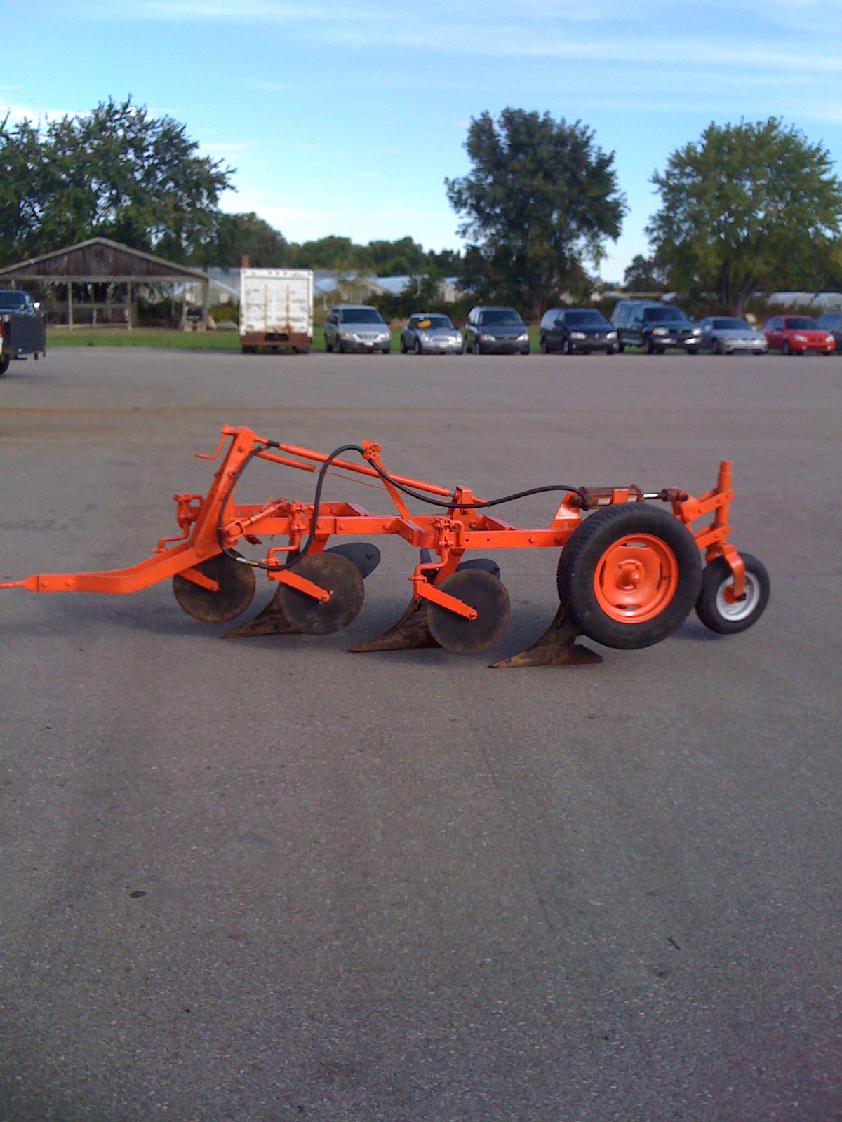

Roddo View Drop Down
Joined: 16 Jul 2010
Location: Brant, Ontario
Points: 466
Post Options Post Options   Thanks (0) Thanks(0)   Quote Roddo Quote  Post ReplyReply Direct Link To This Post Posted: 03 Jun 2011 at 9:18pm
The rear bottom and 2nd bottom have the same land side length.
This is what it looks like.  Before I beat the hell out of it in this sod....

Now to help you. I asked about a 4 bottom and a d19 a few weeks ago. I got them to work good to Okay, still not doing a good job on stony ground in sod. I just plowed this spring ground that had trees (small), blackberries, all types of weeds and grass, and wild roses.  Brush hogged down first. Plowed about 5 acres of this stuff. Take hatchet to cut the roots out, that plug the moldboard. Hears what I had SC  80 framed plows with 375 moldboards, moldboard extensions, and what I'll call cover boards and coulters.
 How long are your shares??  Had to cut the oliver shares down to make it work right.  The sod has to have the right hinge to turn over on.
How level is your ground?  I would think any plow should turn over sod on level ground.  How clean are the moldboards, do they need scoured?
Your picture:
 Can you set the coulters a little lower?  Maybe get them closer to the shin,  just a question here, see if it may help.
Do you have two links that adjust? If you have only one you need to switch them. You need to adjust the farrow side.
