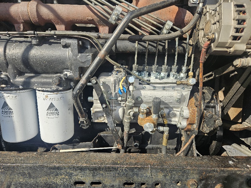

Not related to your problem, but I noticed this on an 8070.[IMG][/IMG]20260302_151404_2026-03-19_18-41-32.jpg20260302_151409.jpg20260302_151404_2026-03-19_18-41-32.jpg
