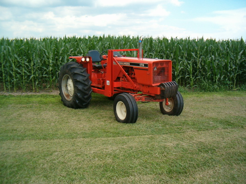

Post Options Post Options   Thanks (0) Thanks(0)   Quote Chad (MN) Quote  Post ReplyReply Direct Link To This Post Posted: 21 Nov 2010 at 9:53pm
I thought I would try suitcase weights on my 220.
