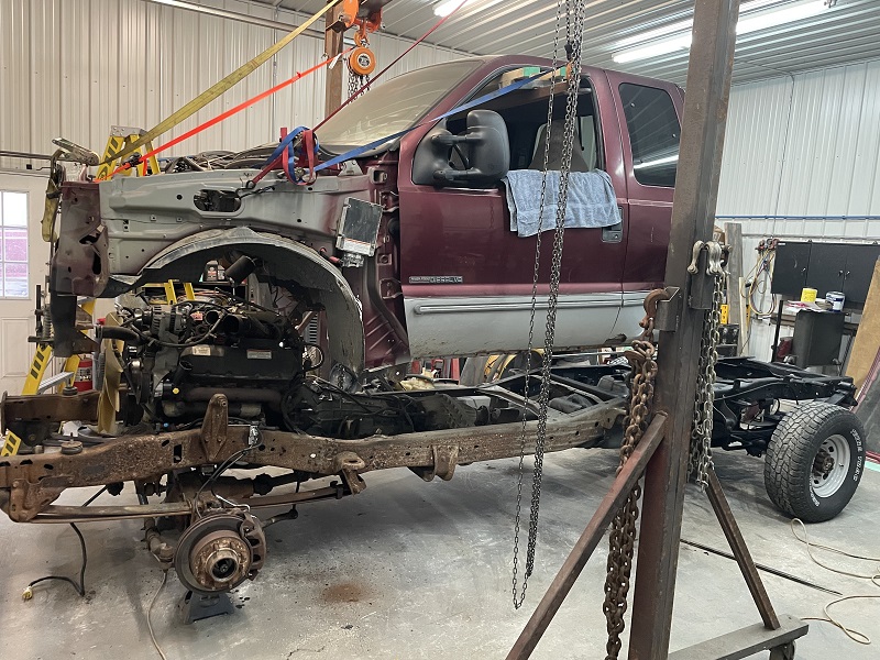

If is as my Super Duty was, this was ONLY way to change Turbocharger.  Core Support panel and Internal Fender system does not come off.

Dmiller, you certainly do NOT need to pull the cab on a 7.3 to change the turbo or even pull the heads.

  Yep, pulled the turbo on my 97, was no fun though for a couple bolts.
