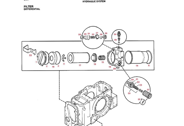

This is just a comment on several issues we have had in the past year. For some reason we are having problems after a filter change - with after market and OEM filters - with customers having a complaint of no hydraulic flow. About 10% of sales. The problem is either the filters are a very small degree shorter, or are 'crushing' a very small amount and not allowing the 'trap door' to fully open.  What we are doing is removing the cork gasket from the old filter and glueing it to the new one. That is working. IF too thick a gasket is added it collapses the filter. IF the cork can't be removed a 'made' thin gasket will work.   The symptoms are noisey cavitating remotes, especially when cold, and steering issues.

loc-tite products or just a 'thin' coat of silicone. Doesn't take much.
Points: 22770
Post Options Post Options   Thanks (0) Thanks(0)   Quote DrAllis Quote  Post ReplyReply Direct Link To This Post Posted: 19 Jan 2025 at 10:41am
We always use to roll on an Oring of the right size diameter onto the screen and then place the screen in the end of the filter as usual. Oring fatness was approx 1/4" to be sure the door got opened plenty. Oring for reused for the next filter change. I'd been doing that for 40 years because we had some problems a long time ago, so it became just a standard practice for us.

Everything hydraulic begins at the left-hand belly filter. If that spring loaded door isn't being pushed open enough, there will be nothing but trouble. Thee most common issue is the screen not being transferred over from the old filter to the filter.

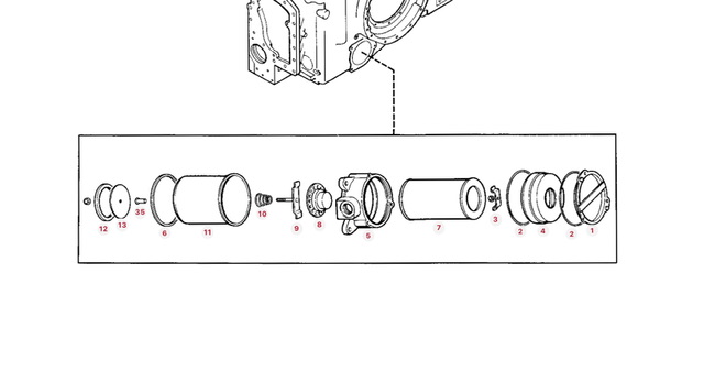

7000 and 8000 series had different sealing Orings. The 8000 are larger in diameter than the 7000 series. Make sure you have the correct ones, I learned this the hard way. Even had a parts guy tell me there isn’t a difference but there definitely is.
Points: 22770
Post Options Post Options   Thanks (0) Thanks(0)   Quote DrAllis Quote  Post ReplyReply Direct Link To This Post Posted: 20 Jan 2025 at 7:34pm
For 45+ years I've done it like this.  7000 series ...if either Orings aren't damaged, I don't use the new ones. Wipe the outer Oring with a rag that has brake kleen on it to get all oil residue off that area. Wipe the filter cover LID with the same rag with brake kleen. Run a bead of RTV silicone around the lids edge and put it together. You will have no leaks.

Oil would have to be drained to change the filter housing seals. I’ve got a 7045 that they leak and need resealed. Just hasn’t been a priority project

If the hydraulics and power steering have been working correctly, it is highly doubtful that anything is wrong. Be sure to remove #8 screen from the old filter and transfer over to the new filter. Do NOT assemble either side bass-ackwards. Your owners manual has good pictures showing which way things go. If there were no leaks at the covers, I never use new Orings and lightly RTV the lid.
