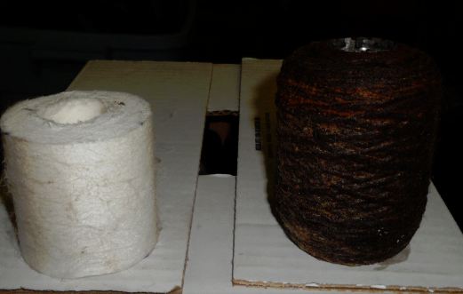

I bought a 2 micron filter and cut it down into 3 pieces - 2 parts will fit the filter housing as needed and other piece is thrown away .  The string wrap filter was used as a oil filter on centervac units in commercial buildings and also on some oil burner guns .

I now converted the old canister filters to spin on by making my own mount to hold filters
