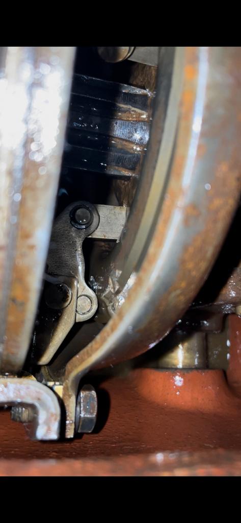

I’m having some trouble with the handclutch of my WD. It kicks out if the tractor is not under load. I have removed shims, but it stil kicks out when not under load. When it is under light load, driving uphill, it stays engaged.
It looks like the plate where the rollers need to roll over is worn out. But I’m not shure if that could be the problem? Maybe i can adjust something else?
Thanks!

Engauge clutch, remove front snapring (wire ring) , Engauge clutch, rotate over center plate to new location. Engauge clutch, replace snapring and your ready to go. Over time it may work itself back. While top is off, make sure no pins have come out of linkage.                        MACK

Probably need to put the shims back in too..

Great help, thanks! Will try and let you know.

Problem solved! Thanks!
