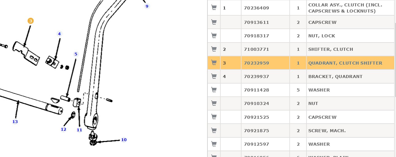

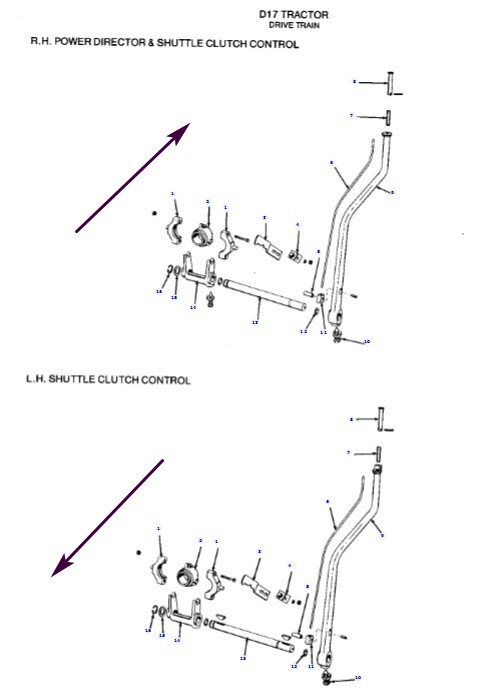

Don't know if this will help, but here's a diagram from the AGCO Parts Books.
(enter as Guest, at prompt enter D17, click on D17 Tractor (Prior to Series IV, page 246)
Shows the Right-Hand version and Left-Hand version of the PD.
Note that the view for the RH version is looking FORWARD from operator's position;
the LH version is looking AFT
BTW, Item 3 for the LH version is not the same part as Item 3 (70237176) for the RH version

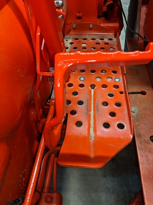

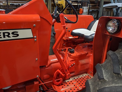

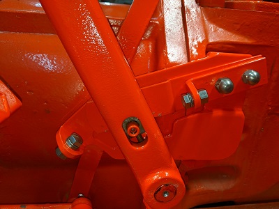

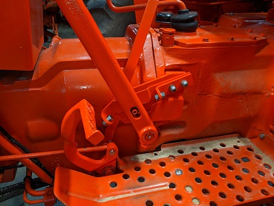

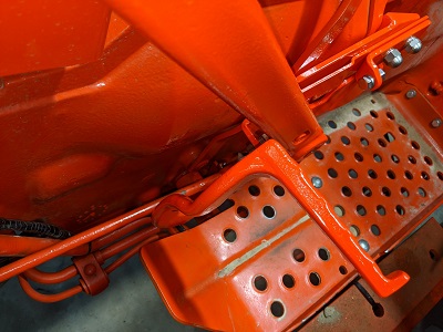

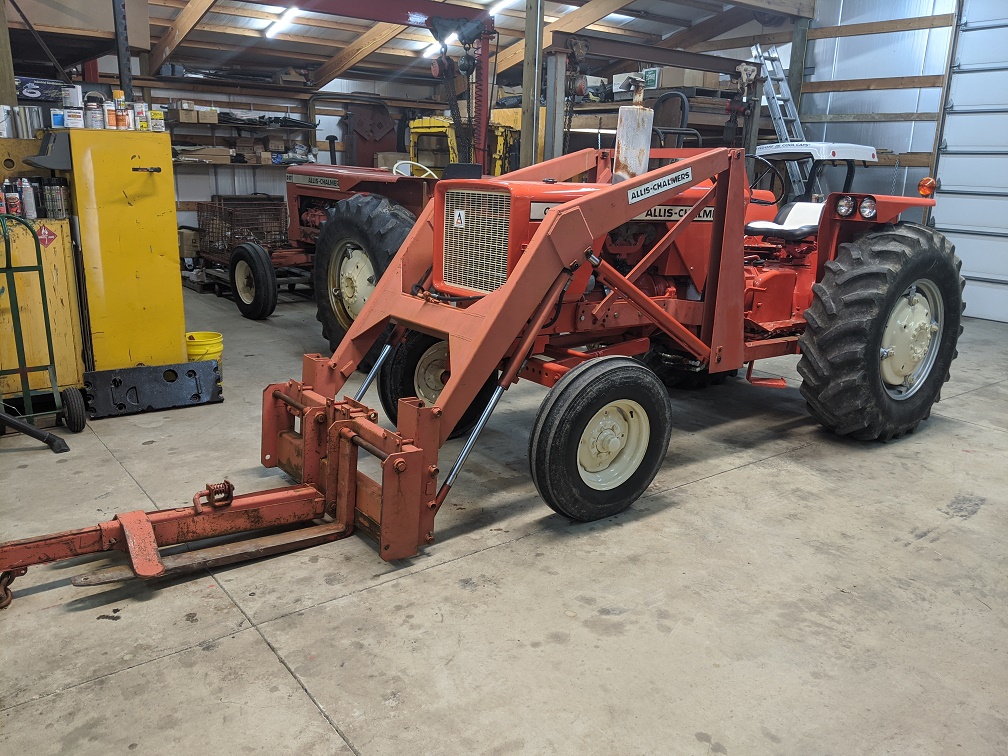

Here is my solution to the Left Hand Lever.  I built a bracket of my own design using the quadrant and rear stop from the right side lever setup.  I modified the lever shaft by adding new keyways for the clutch fork and moving the oring groves and snap ring locations sideways by .395 thousandths. This set the lever to the left enough to get the fabricated bracket behind it.  I also had to modify the clutch pedal with the offset so there would be no interferance with the lever.  Allis made a special clutch pedal for this application but that also has been impossible to locate.

The One-Seventy I converted is still a Power Director, but as Gatz stated, I changed it so I could use the hand clutch with Left hand and hyd. with the Right.
Eventually, if I can find all the parts I will build a torque housing with all the shuttle gears and switch it into the One-Seventy.
The 170's from the factory had a 2 speed PTO, which made it useable at normal speeds but for me it doesn't matter as I don't use the PTO on this tractor for anything.

Nice looking 170. How about more photos?

@Bret(OH), Is that lever an actual left side reversing lever meant for shuttle ?
Good job on making the offset clutch pedal...looks factory
Nice One-Seventy btw

I agree! We need many more pictures If Bert is getting down to .395 thousandths he is doing some detailed work! And by the teaser pictures it sure looks good!

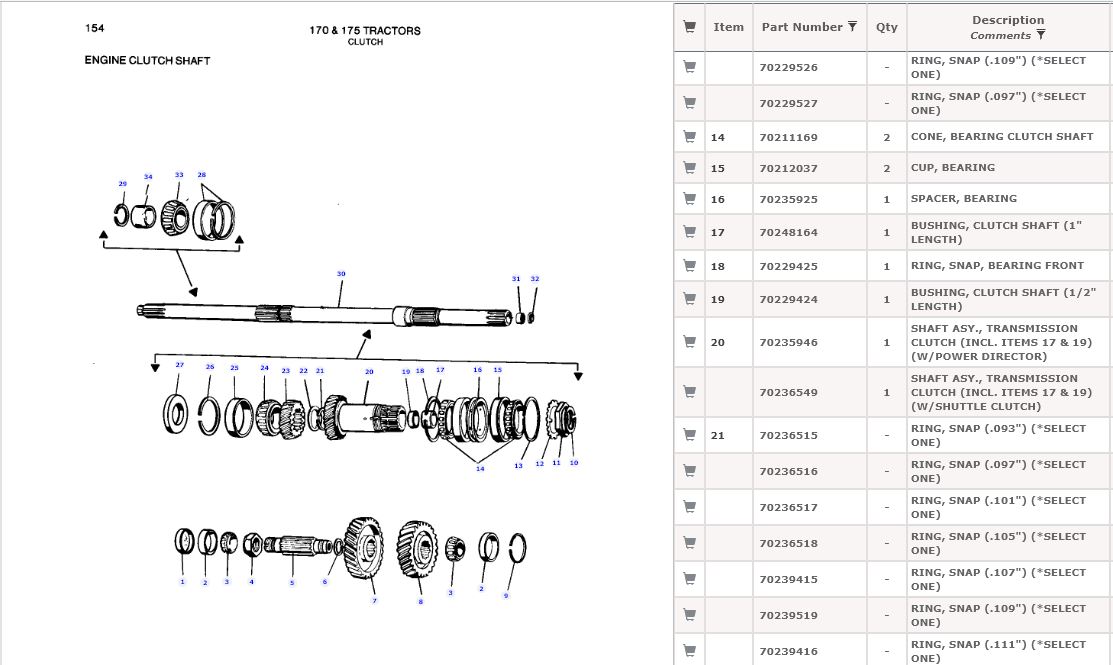

I am (1) gear away from having all the parts necessary to build a Shuttle Shift torque housing for the One-Seventy, but it seems that I may never achive my goal, as that one gear seems as elusive to me as a Unicorn's Wisdom Tooth.
The gear I need is the Hollow Shaft Gear coming forward from the Transmission Clutch, Part # 70236549.  I believe it is almost exactly the same as a Power Director gear except that the Helix of the Teeth for the Shuttle is a mirror image of the Power Director.  Many salvage parts outlets show this part # in inventory but all so far have been mis-numbered in their inventory and are in fact Power Director gears.
This gear, as far as I know, is used only in the D-17, D-19, 170 and 175.  Seems that most of the Shuttle tractors are ones based on the D-15 driveline, and this gear is different in them.
If anyone knows where I could look for or find this gear I would appriciate the information.
