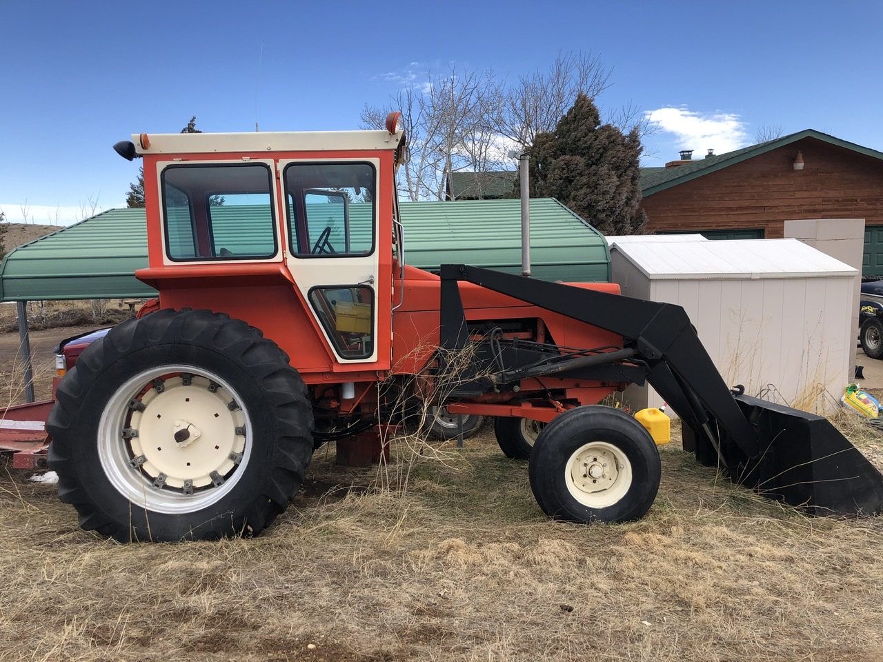

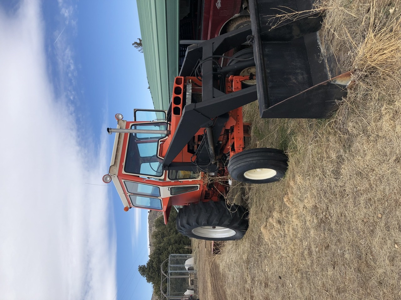

Hi there, new to the forum. I was hoping to see if anyone can tell me what kind of tractor I have? We inherited the tractor from my in laws . All I know about it is that it’s been about 7-8 years since it has last run and according to my wife her dad rebuilt the engine and painted it. It is a 6 cylinder gas engine. I have tried researching and looking on google images and my best guess is that we have a 190? However on the image search I don’t see any 190s with the same grill (4 holes). Can anyone identify what I have or tell me where to find model numbers? I need to know so I can know what parts to look for. I need to replace all of the fuel lines because they are badly dry rotted and leaking. The other problem I have is there is no battery in the box. What battery do I need? I pulled the battery from my ford bronco to see if it would turn over and the 750 cca was not enough. Sorry for the long post, I’m just hoping to get some information so I can get this thing running soon. It could really come in handy for some chores around the property this spring. Thanks in advance!

It is a 190, missing the grill, that is why the four holes show.

Welcome to the Forum. That's a nice looking tractor and loader. Was it sitting inside or out for those 7-8 years?

that's a real sharp looking tractor! good paint for sitting outside all that time! i'm jealous!

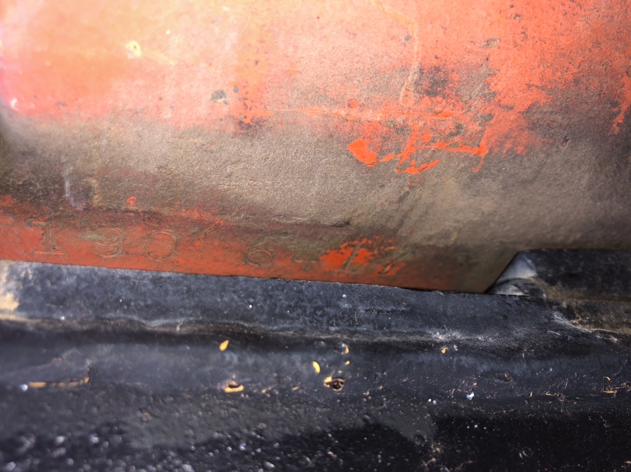

The serial/model number is on the left side of the clutch housing.

Wow!! That is one really nice looking tractor. I have no idea what it is since I stopped selling in 1962. I cannot believe that it has been sitting outside for that long.
It is a family tractor and deserves excellent care.

Looking at the pictures again, that may be a 200. That looks like a 200 cab without air conditioning.

Definitely a pre 1968 190 or 190XT because it has the early style side panels under rhe hood and that is not a 200 factory cab. Looks like a Year-A-Round or something similar.

It's hard to tell for sure but the axle looks to be the small axle which would make it a 1964 190 or a 1965 190 or 190XT.
If your axle measures 2-3.4" it is a '64 or '65. If it measures 3-1/4" I'd say it's a '66 or '67 model.

I, like Bill Long, don't have any idea what it is, but that is a VERY nice clear picture.  I too  can't believe that it has sat outside all that time and looks that good!!
Check for the serial number, that'll help define which tractor it is.

Burton Bronco, welcome to the AC forum. Your photo’s number is a part number, not a serial number. On the left side, try looking where the rear of engine plate bolts to clutch bell housing. If it’s a One-Ninety XT diesel, then it’s serial number will be stamped into the clutch bell housing & read from its top or mid section, going downward. Mine reads like this
190 14445 XTD.

From a closer view of one of your tractor’s side photos, it’s loader’s rear frame may be close or possibly covering your tractor’s serial number on its left side?? So try looking just behind the loader for it.

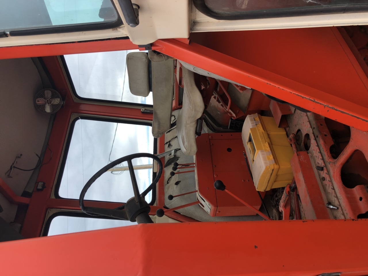

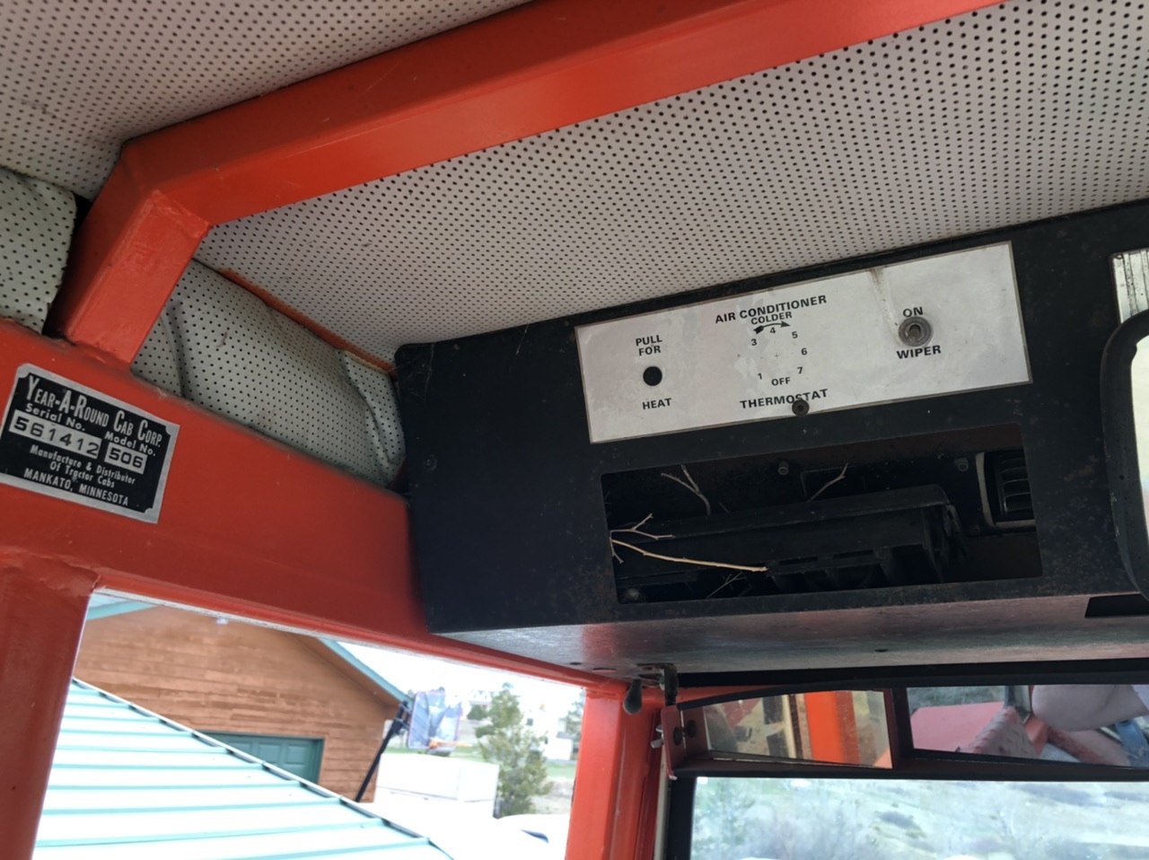

here are a couple more pictures. It is a year round cab and looks like it has air conditioning!

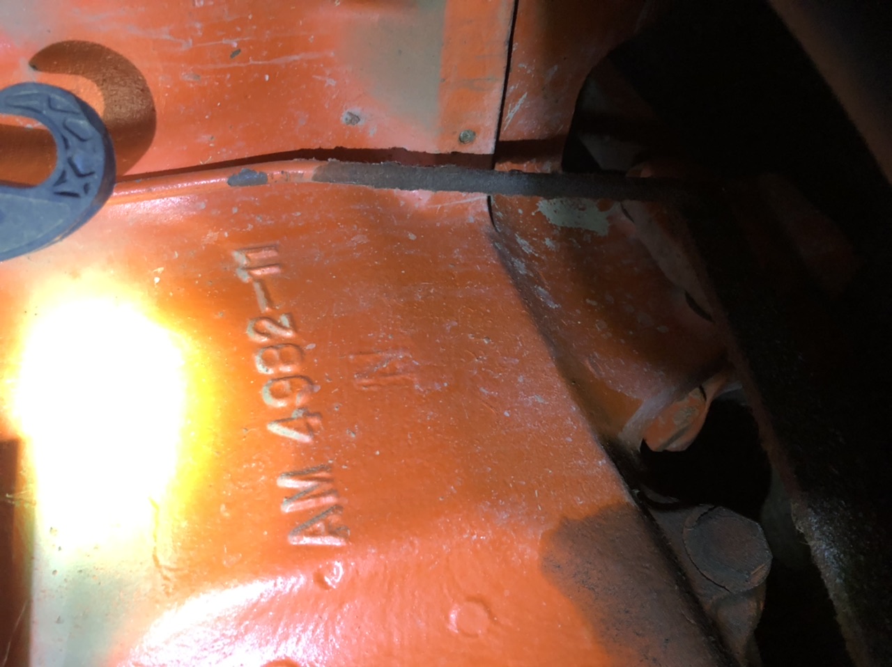

So I’ve replaced the fuel lines and fuel filter. Before filling it I wanted to see if I could get it to turn over. I threw a battery in and still can’t get it to crank. When I turn the key and hit the button you hear it click and then a buzzing sound. After a couple tries now it does nothing at all. The cables and connections seem to be in good shape, so do I have a bad starter?

Good job finding it! It’s a 1965, series one(I). Heres the serial numbers per years. You might try cleaning beyond the 6417 to see if it is a “XT” &/or “D”.
Series I
1964 1001-2484,
1965 2485-8218,
1966 8219-8626.    9004-13272(TI)
1967 13273-17784,19001-19261II
1968 19262-22153,23001-23233III
1969 23234-25900,
1970 25901-29135,
1971 29136-31056,
1972 31057-31117,
1973 31118-31140

That is one nice looking first series 190 AND WITH AIR! If it has the original PTO engaging lever you will hate that part. I think you can upgrade to the longer lever style pretty easily.
