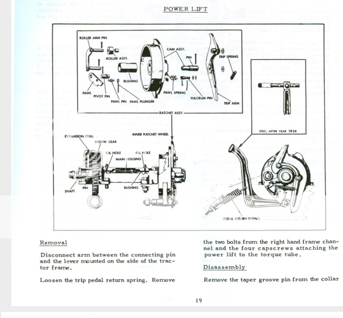

manual I have gives a little on disassembly-
