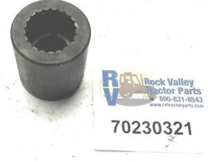

i have heard that i can couple and delete the power director with a coupler out of a 7000 if so what coupler is it. i have also been told that i can made a manual shift coupler out of parts out of a d17 if so what parts do i need

For the direct coupler you can use a coupler from180,185,200 dual speed PTO

It’s located in the TQ housings if I remember. below the PD. Part number 70230321

will that give me the hi side or low side

4 high side gears. It connects the input shaft of trans and clutch shaft of motor together. Direct drive. You remove power director all together
