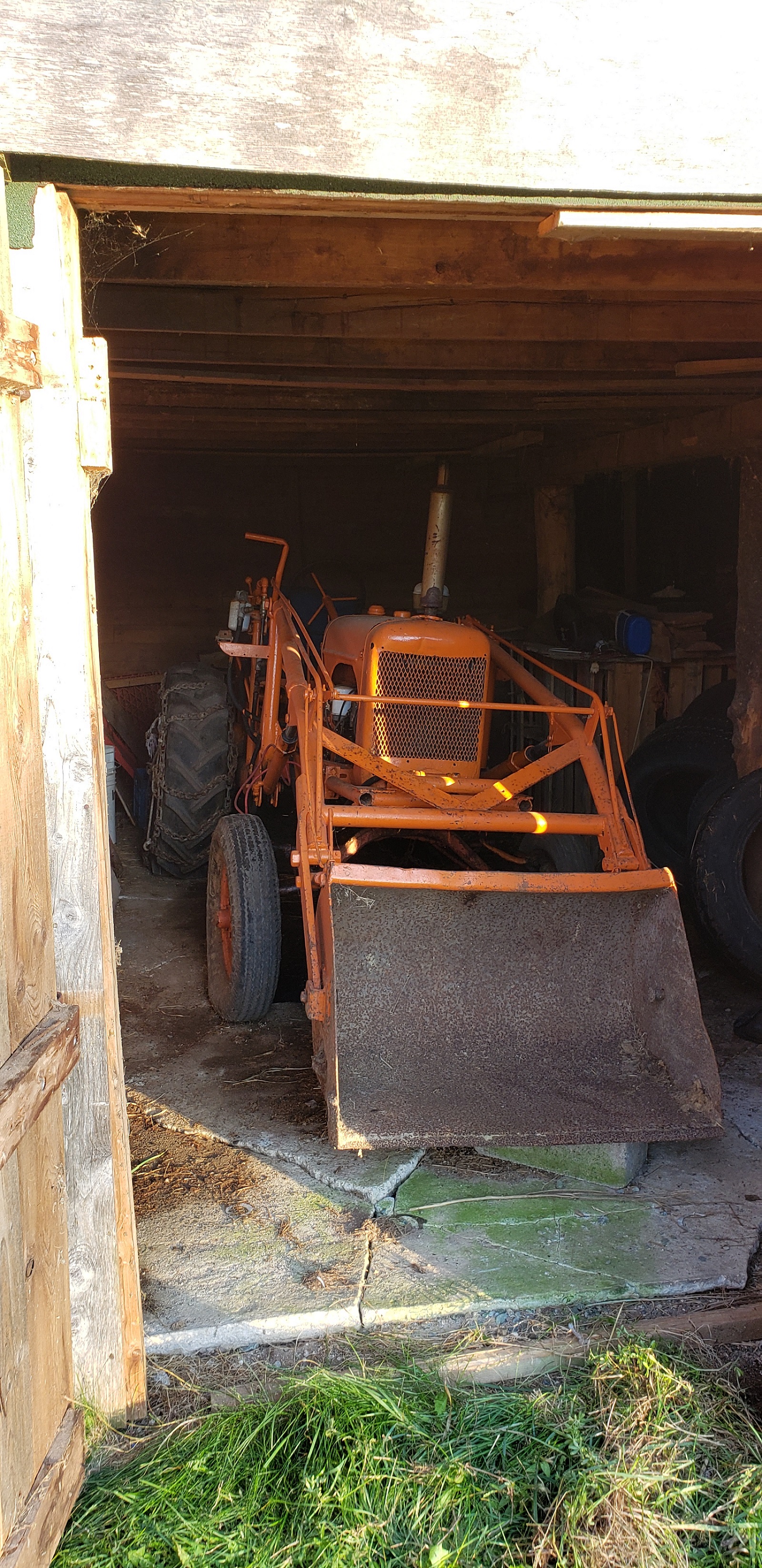

I assume if there are enthusiasts and experts around, the answer will be yes. From some digging online, it looks like it could be a model B. I didn't know where to look for a model # until I was already back home, which was annoying because I was so close to the spot, even have the "Tractor No" imprint in one of the photos. I also didn't know it was an AC until I saw the name on the oil pressure gauge (think that's what it is). This was all last night.
Here's the short story I have for this tractor. It is/was my wife's grand fathers. He passed a few years ago. The guess in the family, is the tractor has been sitting in the barn for ~10 years. The barn is now being torn down. No one wants the tractor. I've never owned a tractor, but would love to. That bucket would be very handy. And think it would be fun to work on with my son (when he's older). I also do not have a mechanical background, but I also don't think I'm an idiot on the matter.
The left rear wheel is rusted through in some spots, and the tire is rotten, so it needs to be replaced. The other 3 seem ok. There is a definite oil leak. Hard to say if it's from the gasket around what looks to be an oil pan, or elsewhere. Didn't see any visible cracks in the engine.

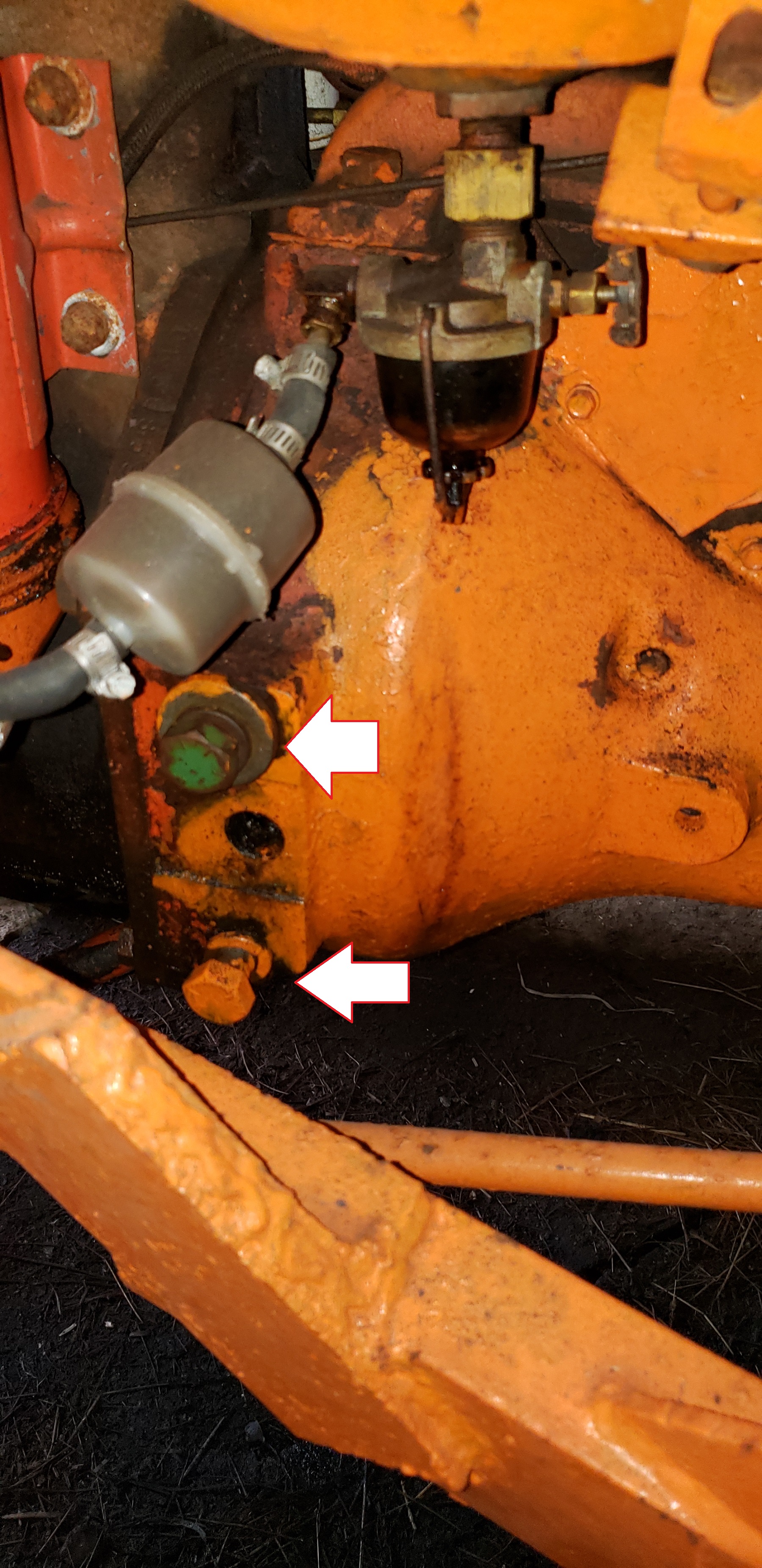

Also wondering what the bolts are for? (picture with arrows) There are two on either side. All backed partly out and loose. I assume to connect something to. But it looks like when they are out, you can see right into the transmission??

Model B
Have fun!

The bolts are the locations for mounting implements. Be careful, if nothing is attached don't screw them all the wall in as they might hit the flywheel if they are long bolts.

Yes you can see the flywheel when they are removed. Most of the time they are removed. I would leave the tractor as is, use it and have fun. You will learn a lot with this tractor. The hydraulics will only work with the clutch released. If you press the clutch, they stop (Thus the loader will not rise)

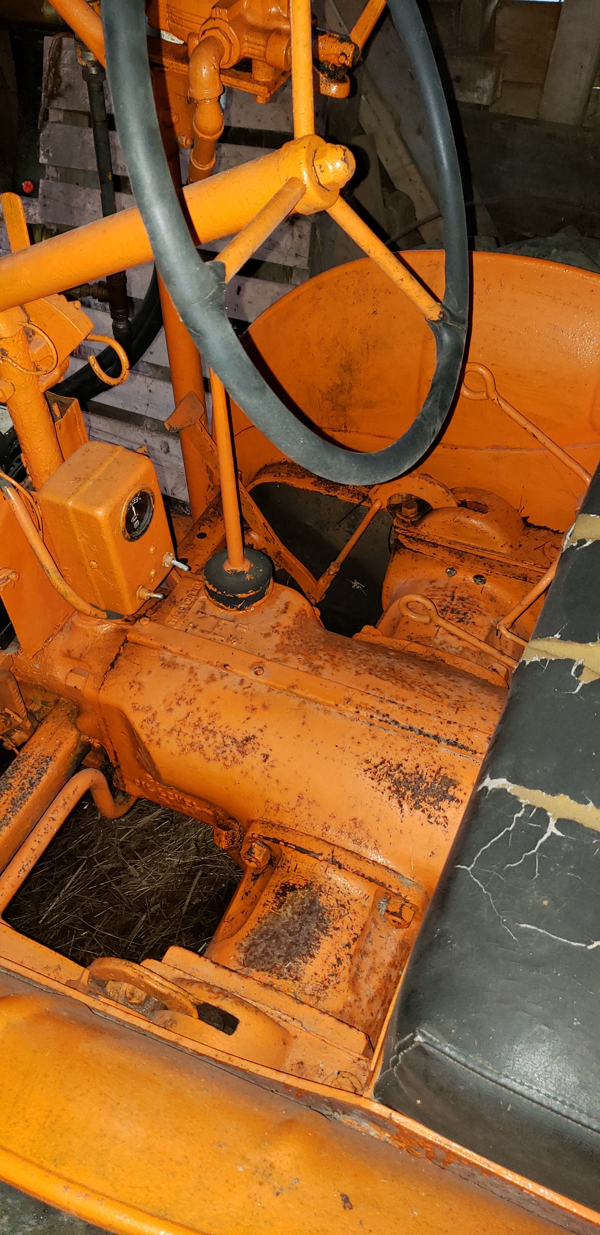

Having never used a tractor, I'm quite unfamiliar with which pedals and levers are which. For the time being, if I'm going to move this thing, I figure I should know how to operate the brakes. Is that pedal controlled? If I recall, there was one pedal on the left and 2 on the right.

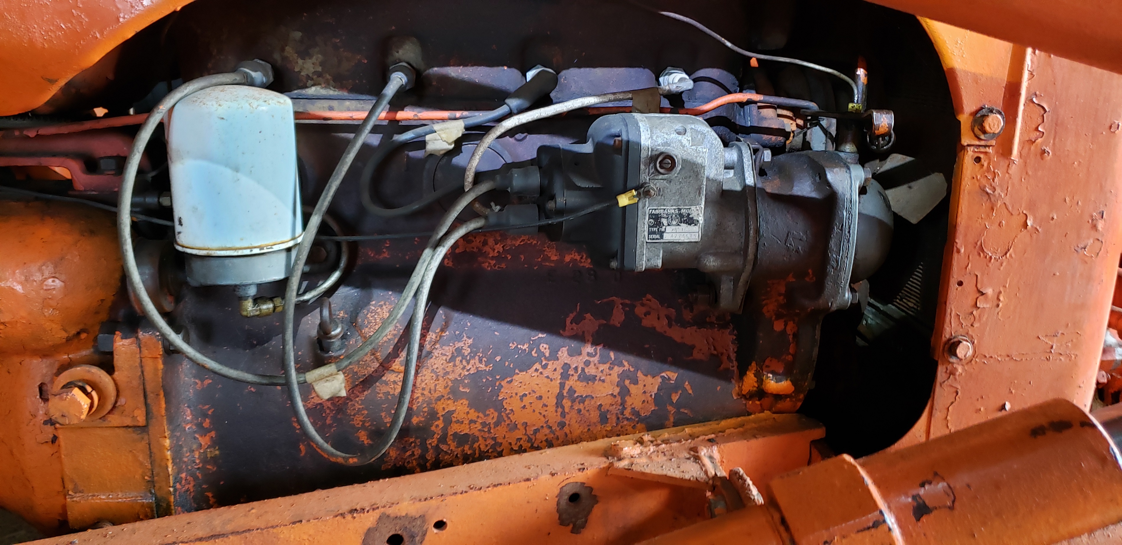

I've read that this has a magneto that'll power everything once up and running. Would this mean I don't necessarily need a battery, and a jumper/booster pack would work? When/if i get to that point

Yes, this is a magneto, so it will run and function very well without a battery.  You will need to crank start it though.  Make sure you learn the proper way to use the crank, if you don't, you may end up seeing your favorite doctor.  If done properly, it is easy.

Looks like it has a starter as I can see the starter bulge on the bellhousing in the last two pics.  You could use a battery and jumper cables to start it or one of those booster packs.
The starter is a 6 volt, but will handle a 12 volt boot for a while.  It's obviously been used with 12 volts for a while as it has been fitted with an alternator.

Make sure you check to see which is grounded, the positive or the negative.
Positive is the default grounding for these, but due to the alternator it may have been changed over to Negative grounding.

It's got a alternator on it so it's been converted to 12 volts

yep, that's a B.  Alternator means it's been updated, probably to 12v negative ground, and a 12v battery will whip that engine into action in a heartbeat.
Magneto means it'll hand start with a dead battery.

The bolts on the sides of the bellhousing are there to hold spare washers, just in case you'll need them.  One of those bolts is an extremely rare, and commensurately expensive one, as it is wearing green paint.  Green paint on tractors is ghastly expensive, and reserved only for those who bleed money.  Because of the green paint on that bolt, it is automatically rated to five times' normal strength, and it's replacement cost is ten times' that of an ordinary fastener.  I suggest you carefully remove, clean, and put that one on Ebay, and replace it, and the washer, with a plain Grade 5 fastener, and torque it to zero inch-pounds with first finger and thumb, and put the difference in a long-term investment.

Under the steering wheel, small looped handle on right by throttle is the choke.  Loopy pedal-thing under your foot is the starter switch... press it, and the battery energizes the starter motor, cranking the engine.  Doesn't matter if the magneto is on, or not, the engine will crank.
Once you have that, it's time to clean out the fuel tank and sediment bowl.  That picture shows yours as being deep reddish brown, so it's nasty.  The fuel filter is probably there for a reason... so you'll be cleaning it a bit.  If it were me, I'd nix that extra filter, replace the hoses (eventually, replace them with proper metal lines) and unthread the sediment bowl from the tank to get it ALL rinsed really well.  I'd probably also drop the carb bowl and clean out any crud in there, and on the carbeurator fuel inlet, unthread that fitting and clean out the little catch-screen in the fitting (if there IS one).  After that, add a little fresh fuel, make sure the carb bowl fills (and hopefully, doesn't overflow), and then fire it up.
Left hand pedal is the engine clutch.
There's a small looped-end lever down there... controls the Power Takeoff.  You'll probably need to press the foot clutch in, and lift this lever to engage the power takeoff, in order to make the hydraulic pump operate.  You'll know when PTO is engaged, because the PTO shaft under the seat will start spinning.  Keep your trousers away from it.
Lever with loop to the right of your right leg is the hydraulic control valve.  With engine running, and clutch released (but leave trans in neutral for testing), lift the lever... after a moment or three, the bucket should start to raise.  Move lever to middle, it should hold.  Down should drop it.
Bit lever up on the loader arm releases the bucket.  it's a 'trip bucket'... that means gravity makes it dump.  To reset it, lower bucket to the ground, and back up... bucket will roll to horizontal position, and the trip latch SHOULD reset.  Oil and cussing may be required to make it operate well.
