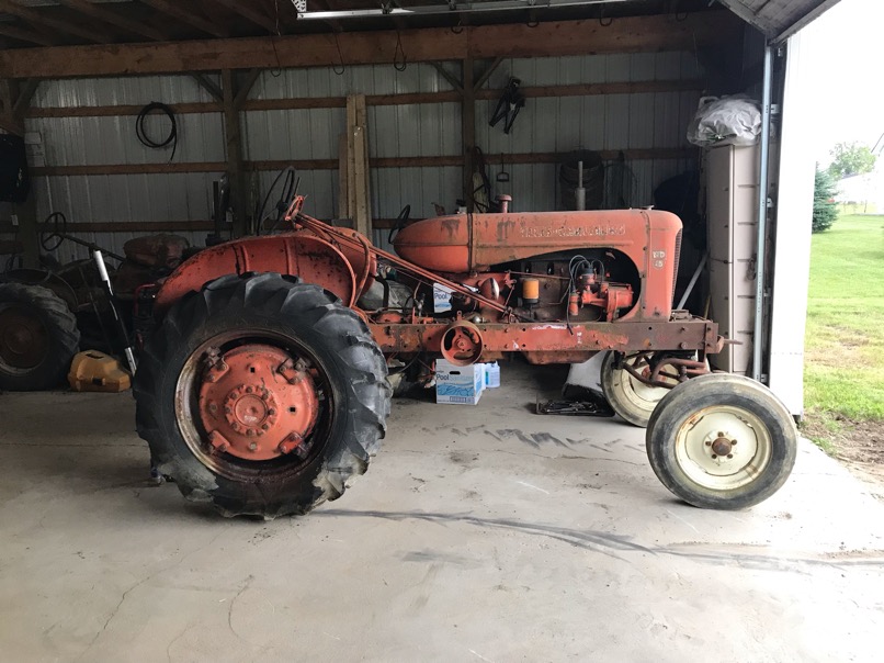

Got my wd45 I lost at the auction back in November the man who out bid me and lost interest put it on the trailer and sat there until now. Took off and sold loader and the other bad thing was told that the trans and rear end where seized up but it was both brakes froze up the trains and rear are of the cleanest I’ve ever seen. Motor on the other hand is wow bad so as soon as a get a couple extra bucks I’ll get new sleeves and pistons. Reason I wanted this tractor so bad is the backstory. The coolest thing that not many tractors have is the complete history from new. This 1954 wd45 was bought new late summer of 1954 in Yale Michigan at tenniswood equipment. The original owner had a chopper that him and a neighbor bought and his John Deere b and the neighbors framall h couldn’t run it good enough. So the owner to a trip to Yale and they had this in the showroom and he told them to bring it out and if it would run the chopper he’d take it. His son said it came about dinner time and the salesman told him to eat dinner he would hook it up and adjust everything and have it ready when he was done. It was awesome and it stayed on the same farm in avoca mi until now. It was rebuilt in the 1970s and was given d17 engine upgrade then I was told. But not used to much after that. It had sat in the bushes completely covered from the late 90s till now. I’m going to stop and visit next week and see if I can find out any more info on the tractor from it’s work days. But I do know it will be getting a new rebuild and will run for the first time in 20 years. And next year will get some nice new paint.

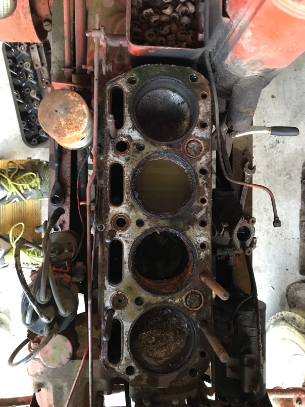

Given a "D-17 engine upgrade" is interesting. Those look like WD-45 pistons to me unless they are 4 1/8" bore. A D-17 gas engine as-is will not fit in a WD-45. The water pump and crankshaft pulley have to be changed, along with the flywheel and clutch assembly.

The pistons have a smooth easy bowl not like the wd45 where there is a large around outside of piston then drops off deep fast. These drop of right away but are gradual like lenses for glasses

Not deep either so I assume that would raise compression and give you more hp

WD-45's are a smooth "cereal bowl" design. The D-17's were a flat bottom with a thick ring around the outside. Are they 4 inch ?? or 4 1/8" ?

I will have to measure at work right now but ya I would say cereal bowl.

Maybe a case of not remembering or someone got ripped off but as drallis says it looks to be regular wd45 motor stuff and it is a 4 inch bore

But I learned some stuff today I once had a wd45 that had the deep bowl pistons and I thought that was what a wd45 was supposed to have but I see now that the 45 has the easy slope pistons

The original design of the famous "Power Crater" bowls in the WD-45 were the smooth cereal bowl dish design. When the D-17 came along they redesigned the bowl to be flat on the bottom and the ring design on top.  There have been after-market pistons made with the smooth cereal bowl design, but they are usually 4 1/8" bore.

Your piston top looks exactly like the ones in one of my stuck 45's.

Mines not stuck anymore knocked out sleeves and pistons today no cracks between the cylinders
