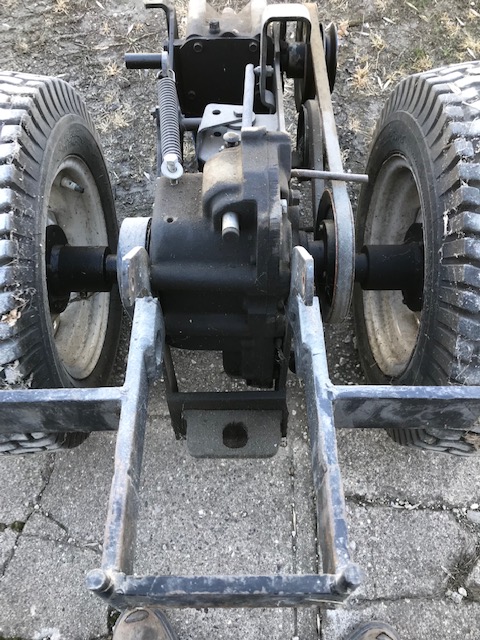

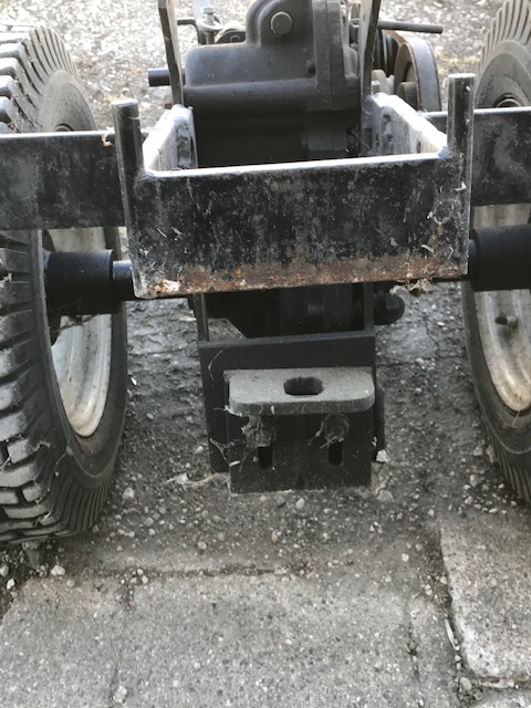

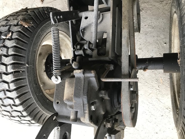

I have exactly what you are looking for. 3 speed transmission with solid rear axle. Heavy duty hubs with adjustable hitch and weight bracket. Cost $500 to build axle and hubs. Would take $250 for the whole rear end (wheels not included).

716 six speed. Quite pulling and put a hydro back in it.
