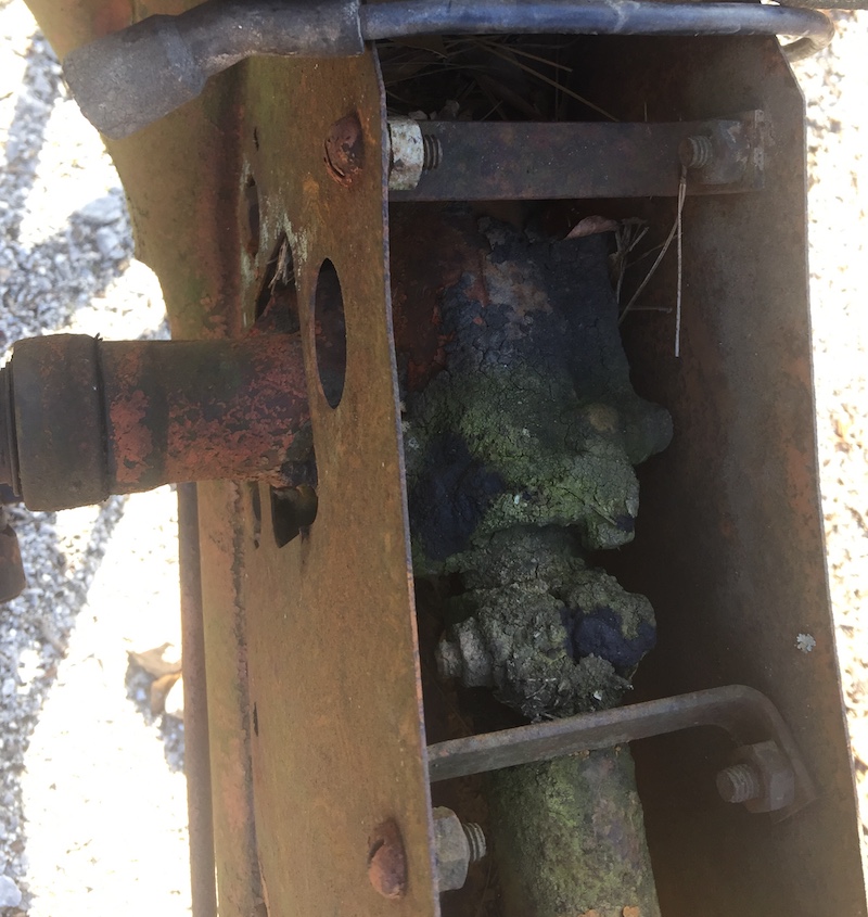

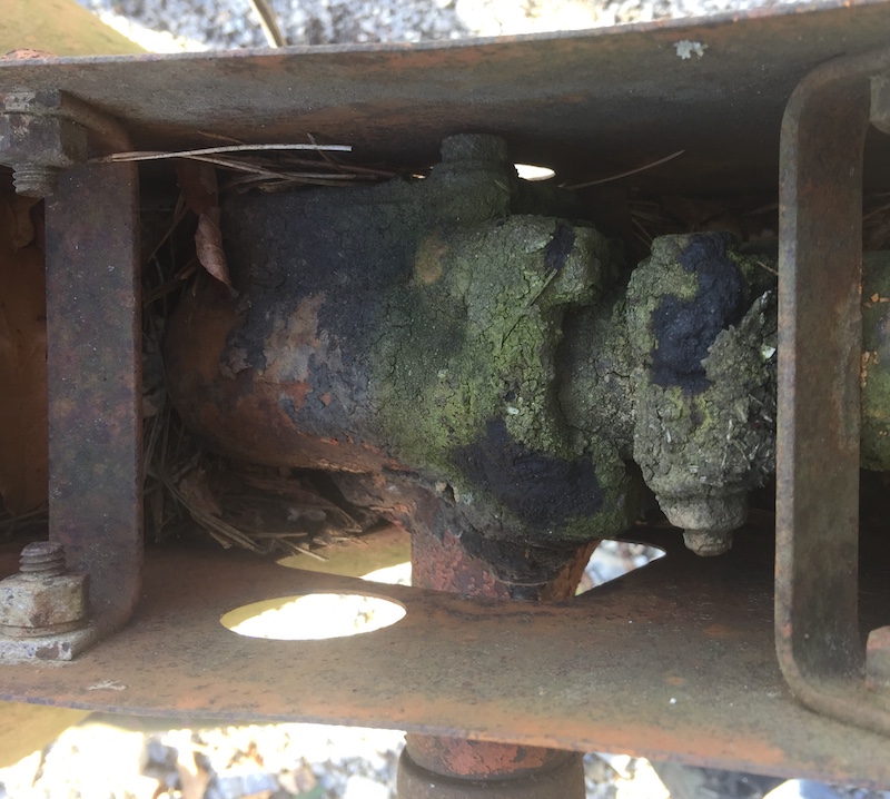

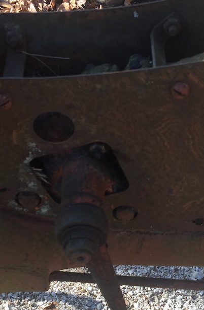

OK, here are 3 views of the steering gearbox on my spare B. If this is what you need just ask and it's yours.
