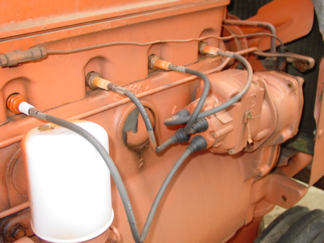

Top Dead Center
Distrubuter pulled out and turned to #1
Cap replaced on distrubuter, wires double checked
Can't fix stupid

How old are those plugs and wires? The plugs look like they still have the original orange paint on them.

"distributor pulled out and turned to #1"............ and rotated and locked in position so that the point is just starting to open ??

Plugs and wired are getting great spark at the plugs. Ive checked three times. Carb is off a running tractor. Just ran that tractor 10 min ago. Plugs have been getting hints of gas on them.
