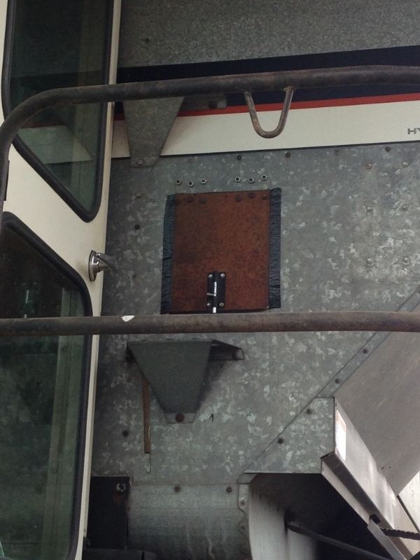

I even thought about finding an old satellite dish (the screen ones) set it on top and trace the bin edge out, make a frame to fit that edge and bolt it on. I don't have to get in the bin anyway, I fixed that problem, made me a fold in door in the side of the grain tank and bolted a piece of channel at an angle that ends close to the door(like the JD's have). And I'm wanting to put a Loup system on it anyway for moisture

Post Options Post Options   Thanks (0) Thanks(0)   Quote shameless (ne) Quote  Post ReplyReply Direct Link To This Post Posted: 18 Dec 2016 at 6:59pm
lets see a pic of that door

Post Options Post Options   Thanks (0) Thanks(0)   Quote bakwoodsfarm Quote  Post ReplyReply Direct Link To This Post Posted: 22 Dec 2016 at 5:26am
Sorry Shameless, forgot how to post a picture.

Post Options Post Options   Thanks (0) Thanks(0)   Quote bakwoodsfarm Quote  Post ReplyReply Direct Link To This Post Posted: 22 Dec 2016 at 5:30am
finally remembered how
