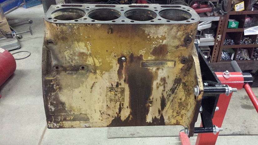

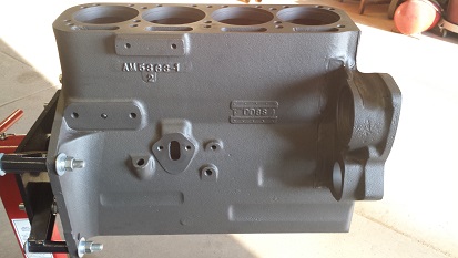

All,
Starting a build thread for my H3 160 cu in gasser.  I think there may be some differences from the tractor D15 II.  Check it out.
For staters, my engine had to pistons stuck, which can be found in an earlier thread, but this one is for the rebuild.
Here is the block stripped and ready to be sent out to get cleaned and cracked checked.

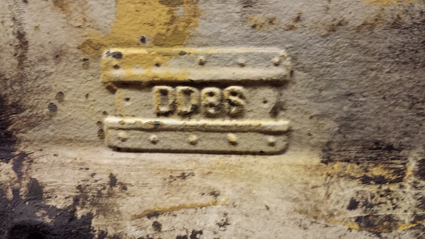

Post Options Post Options   Thanks (0) Thanks(0)   Quote OldSchoolRecovery Quote  Post ReplyReply Direct Link To This Post Posted: 19 Mar 2016 at 9:36pm

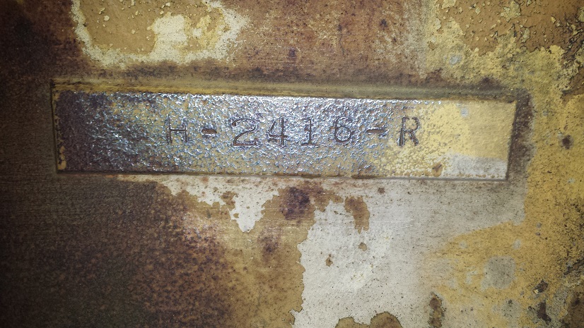

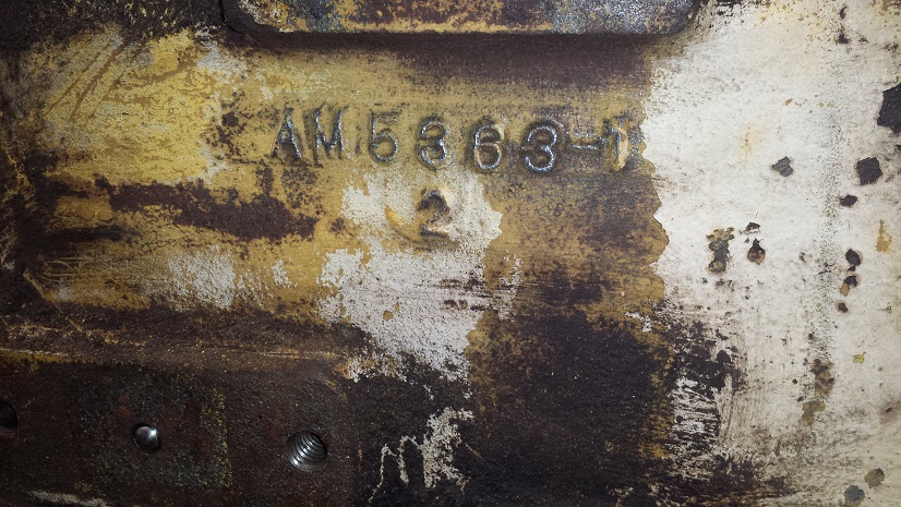

Here are all the casting numbers and stampings on the block.
OldSchoolRecovery View Drop Down
Joined: 06 Nov 2015
Location: Eagle River, WI
Points: 301
Post Options Post Options   Thanks (0) Thanks(0)   Quote OldSchoolRecovery Quote  Post ReplyReply Direct Link To This Post Posted: 19 Mar 2016 at 9:37pm
More

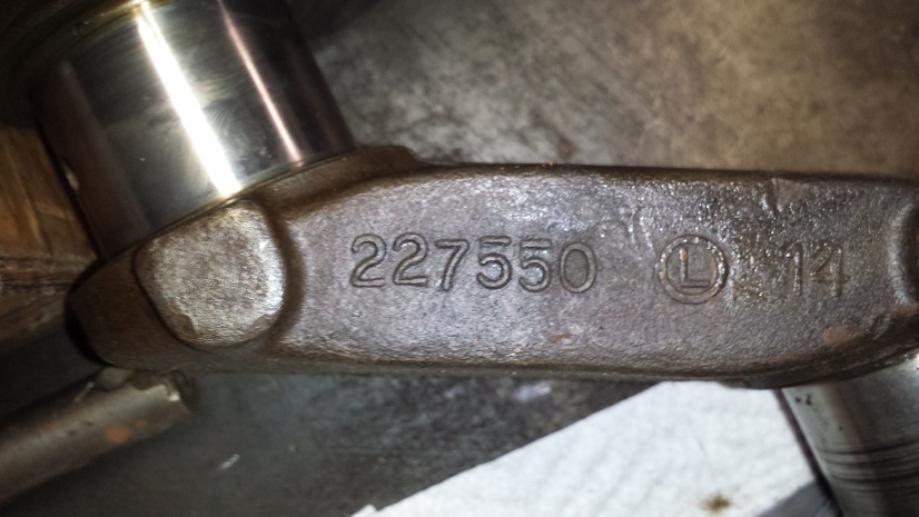

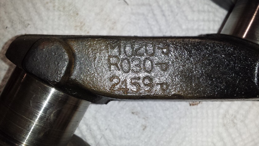

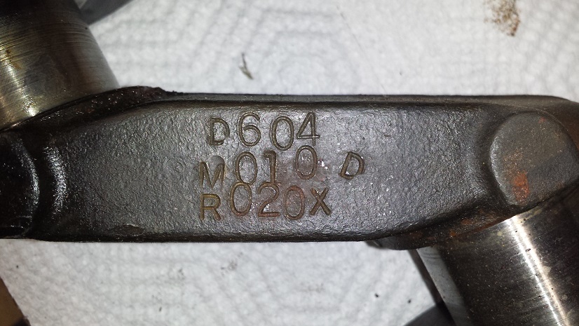

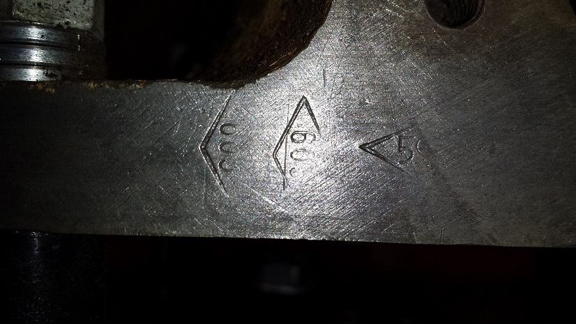

Appearently this motor has been rebuilt at least twice before.  Not sure about the crank and another regrind....
Joined: 06 Nov 2015
Points: 301
Post Options Post Options   Thanks (0) Thanks(0)   Quote OldSchoolRecovery Quote  Post ReplyReply Direct Link To This Post Posted: 19 Mar 2016 at 9:43pm
Second grind
Joined: 06 Nov 2015
Points: 301
Post Options Post Options   Thanks (0) Thanks(0)   Quote OldSchoolRecovery Quote  Post ReplyReply Direct Link To This Post Posted: 19 Mar 2016 at 9:44pm
Crank casting number

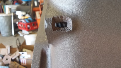

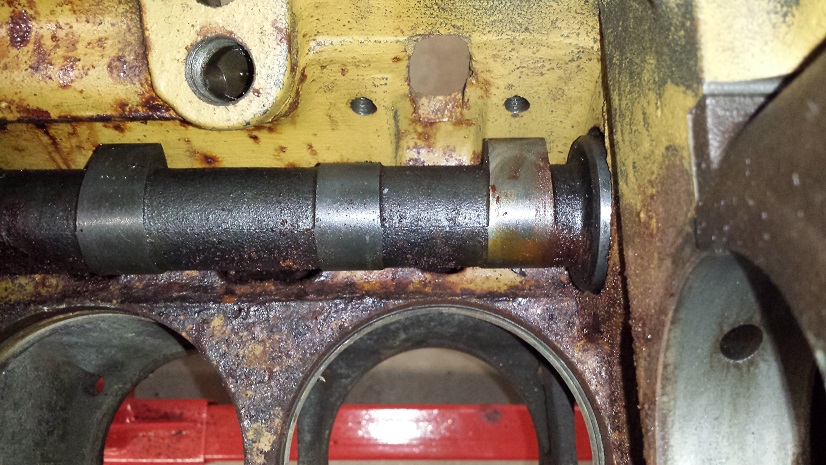

Here is where I see a problem with my dozer.  Looks like someone put a tractor cam in it as there is no lobe for the mechanical fuel pump.  The previous owner blocked this off and used an electric pump.  I dont want to use a electric pump.  Where do I get a cam with the fuel pump lobe?
Joined: 06 Nov 2015
Points: 301
Post Options Post Options   Thanks (0) Thanks(0)   Quote OldSchoolRecovery Quote  Post ReplyReply Direct Link To This Post Posted: 19 Mar 2016 at 9:48pm
Exterior fuel pump boss and hole, and cam without corresponding lobe??

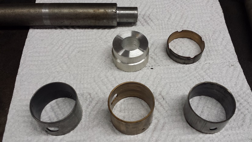

Oh, and a tool I made with my $500 auction lathe from last summer, for driving out the cam bearings...
Is the middle bearing supposed to be copper and the outer two babbit??

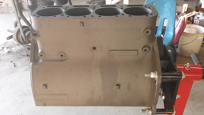

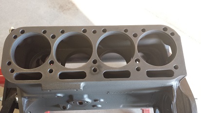

Block back from cleaners.
Joined: 06 Nov 2015
Points: 301
Post Options Post Options   Thanks (0) Thanks(0)   Quote OldSchoolRecovery Quote  Post ReplyReply Direct Link To This Post Posted: 18 May 2016 at 10:37pm
Next picture

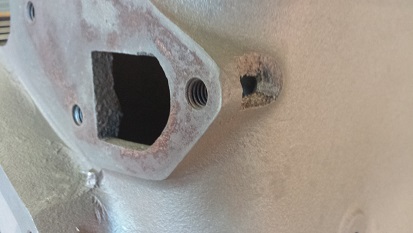

Post Options Post Options   Thanks (0) Thanks(0)   Quote OldSchoolRecovery Quote  Post ReplyReply Direct Link To This Post Posted: 18 May 2016 at 10:40pm

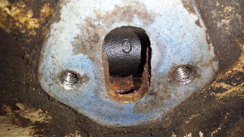

Here is a picture of damage from past owner using a bolt a little too long.  Will need to fix this..
Joined: 06 Nov 2015
Points: 301
For mounting the water pump..
