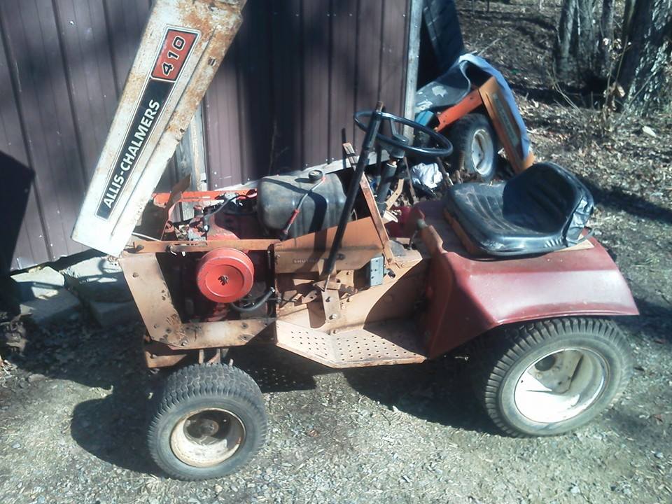

Hello! New member here. I just bought a 410 shuttle. The previous owner has swapped out the original motor for a 12 hp. That's not a big deal to me, what's stumping me is no fire on the plug. I've checked all electrical connections. The only thing I've found is what I believe to be an incorrect solenoid. My 312 has a "one post" while this one has a "two post". In other words, a post for starter and a post for ignition. Any suggestions would be helpful. Thanks!

No fire on the plug. At first it wouldn't turn over and I figured out p.o. had attached starter wire to the ignition side of the solenoid. I hooked that up and the starter works by the switch now. Right now there's no wire on the ignition side of solenoid. A picture/diagram of your set up would be great! Thanks! Neutral safety switch under seat has been jumped already, looks like permanently but I will check it anyway.
