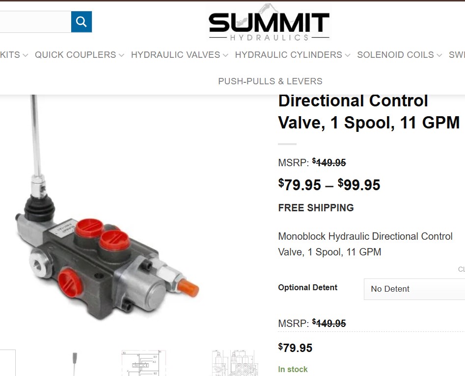

youi need a valve with an OPEN CENTER... The pump can run continuous and will pump THRU THE VALVE back to the hydraulic case ( you will need a return hose).... You can get a single valve or double if you need two seperate "LIFT" systems ( like a dump bucket)... If all you need is the RAISE cylinders, then a single valve with OPEN CENTER will do the trick.
Points: 88631
Post Options Post Options   Thanks (1) Thanks(1)   Quote steve(ill) Quote  Post ReplyReply Direct Link To This Post Posted: 27 Nov 2024 at 9:14am
some external valves will be RAISE / HOLD / FLOAT.... others will be RAISE / HOLD / POWER DOWN ....... if you get the POWER DOWN valve, you will need to route that hose back to sump... If you havae the FLOAT valve, with open center, your OK.
Points: 88631
Post Options Post Options   Thanks (1) Thanks(1)   Quote steve(ill) Quote  Post ReplyReply Direct Link To This Post Posted: 27 Nov 2024 at 9:26am
Benefits:
  • 1 Spool valve with compact design allows for installations in tight areas
  • All spools are standard double acting with spring return to neutral position which are ideal for double acting cylinders
  • Used for open center systems (Pump to Tank Flow) – closed center option available
  • Anti-drop load checks on each spool
  • Precision ground and hard chrome-plated spools assure a long life
  • High-tensile strength cast iron monoblock construction
  • SAE O-Ring ports ensure solid seal and prevent blockages
  • Capable of closed center or Power Beyond (conversion plug required)
  • Vertical or horizontal handle mount
  • Adjustable Relief Valve Range:  1500 to 3625 PSI
  • Preset Pressure Relief: 2610 PSI
  • Used as motor or single-acting spool possible (#8 SAE port plug required)
  Features:
  • Max Operating Pressure: P = 3625 PSI, T = 725 PSI, A & B = 4350 PSI
  • Flow Rating: 11 GPM (40 l/min)
  • A & B Work Ports:  #8 SAE O-Ring (3/4”-16) Thread
  • Inlet Port: #10 SAE O-Ring (7/8”-14) Thread

Benefits:
  Features:
  • Outlet Port: #10 SAE O-Ring (7/8”-14) Thread
Thank you sir. The information from your posts is very much appreciated. I am starting to get a good picture of how I can make this work.
Would you happen to know where the return could be run to on the pump housing or transmission to get it into the sump?
Points: 22171
Post Options Post Options   Thanks (1) Thanks(1)   Quote DrAllis Quote  Post ReplyReply Direct Link To This Post Posted: 27 Nov 2024 at 10:02am
Remove the drain plug to the hydraulic sump, install a tee, return oil into the side of the tee and still have a drain plug on the bottom.

Originally posted by banjojelly banjojelly wrote:
Ah. Yes, engineers have a different view than fabricators. Engineers design first, build second. Fabricators tend to design and build as the same process. I would put myself fully in the second category.
Yup.
Before I switched careers I worked in sawmill maintenance for 30 years as a saw filer. I have a fair amount of experience from both perspectives
...As for the second part, can I run the return straight back into the fill hole? ...
Yes.
But Dr Allis' suggestion is better, and Steve has the correct valve configurations.
This is a great idea. Thank you. I was thinking I would need to go in from the top. I was not thinking about the drain plug being an option.
