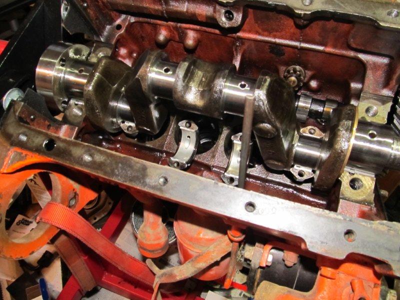

Post Options Post Options   Thanks (0) Thanks(0)   Quote Warren(Oh) Quote  Post ReplyReply Direct Link To This Post Posted: 04 Feb 2012 at 12:23pm
Figure I'd better get a picture before I forget. Just set the crank in place, in #1 and #4 rod, still got to rotate it to catch 2 and 3. Sure moves slick now ! Probably ought to get the other thrust bearing on, I guess...
Infernal thrust bearings and shims ! Still might not be right...

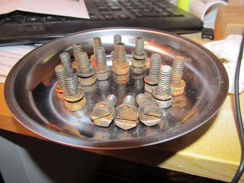

Got the day off so back to the N62.
Cleaned the oil pan and bolts. Found something neat in the bolts ! Looks like someone had the forethought to cut slots in the heads of the 3 front pan bolts. 3 longer regular bolts must have been in the rear three holes. The rest must be original bolts as the washer won't come off, easily anyway.

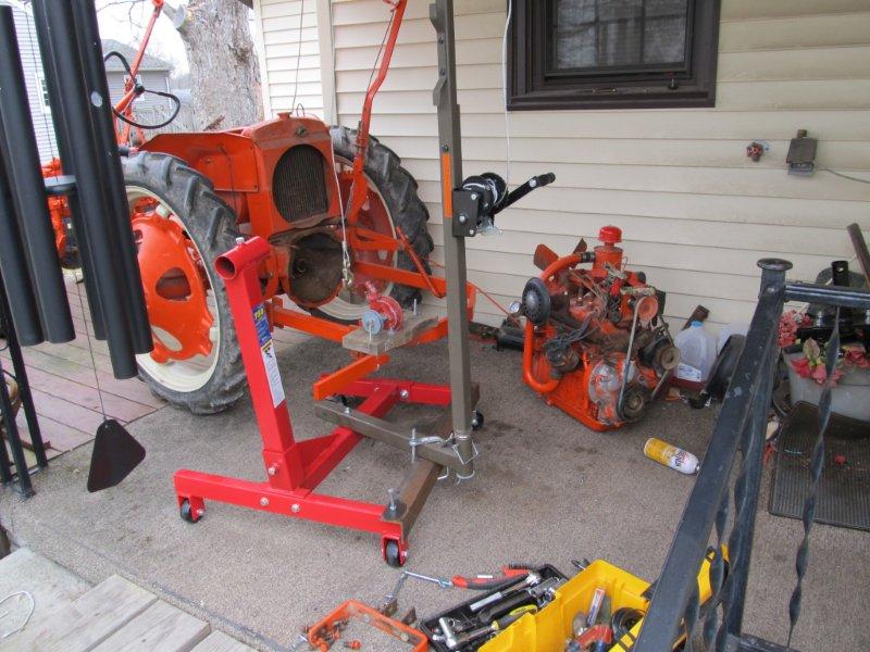

Third times a charm, maybe.
Well, it's ready to move out.
Just hanging loose
Anyone know if there is a particular torgue for the flywheel bolts ?

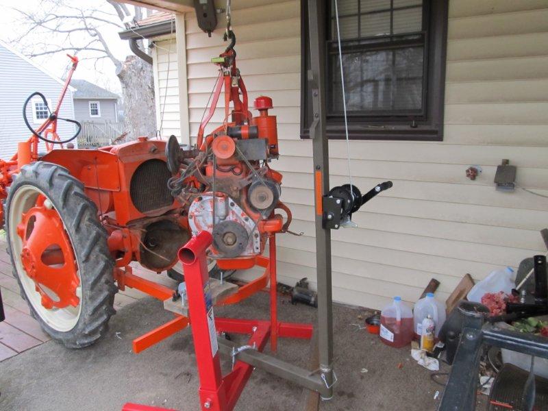

Post Options Post Options   Thanks (0) Thanks(0)   Quote Warren(Oh) Quote  Post ReplyReply Direct Link To This Post Posted: 10 Feb 2012 at 11:16am
On a good note, I now know I can lift and set down a complete G engine....

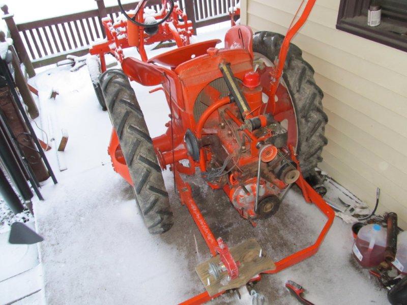

Post Options Post Options   Thanks (0) Thanks(0)   Quote Warren(Oh) Quote  Post ReplyReply Direct Link To This Post Posted: 10 Feb 2012 at 12:31pm
Back where it belongs. I did bend the throttle rod but that shouldn't be to bad to fix.

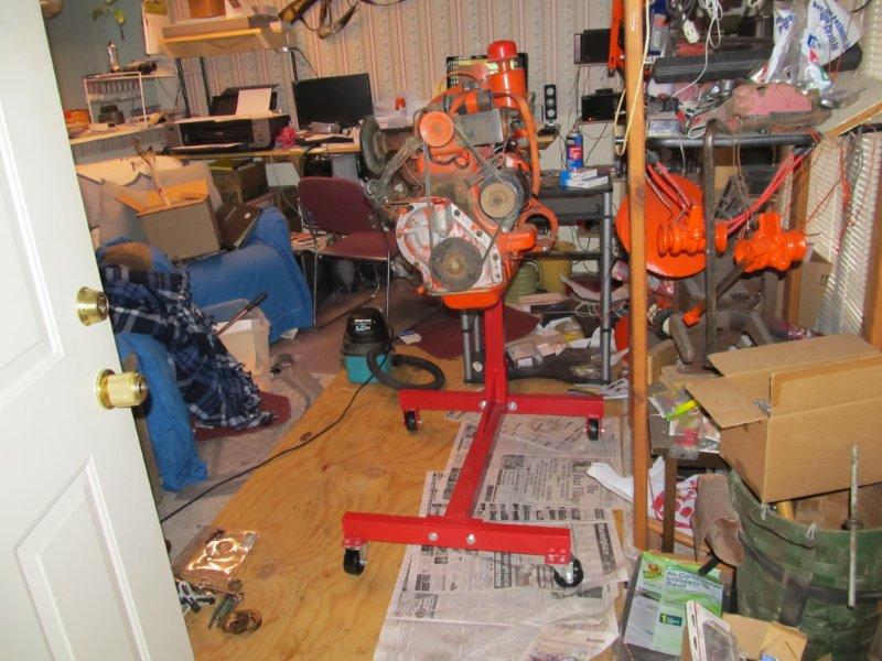

I don't think I'll be doing much on it today, see picture (reason 1). 18 degrees (reason 2). After picking the engine up twice yesterday, I'm in pain ! (reason 3!)
