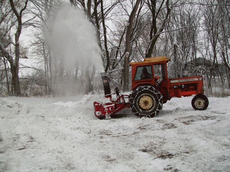

We have had a 6ft Loftness blower on D17's since 1988 and have had no problems. Its been on 2 series 1's and currently is on a series3 so its a aftermarket / homemade 3 point not factory. It can get a little light in the front and you have too slip the hand clutch to regulate the speed but works good.

I agree with the others. Nothing to worry about. I have a 6ft other brand(brand name I forgot but popular) on my 45 with modified aftermarket 3pt. little light on the front with 2 F&H rear wheel weights mounted on the front but no issues for many years.
