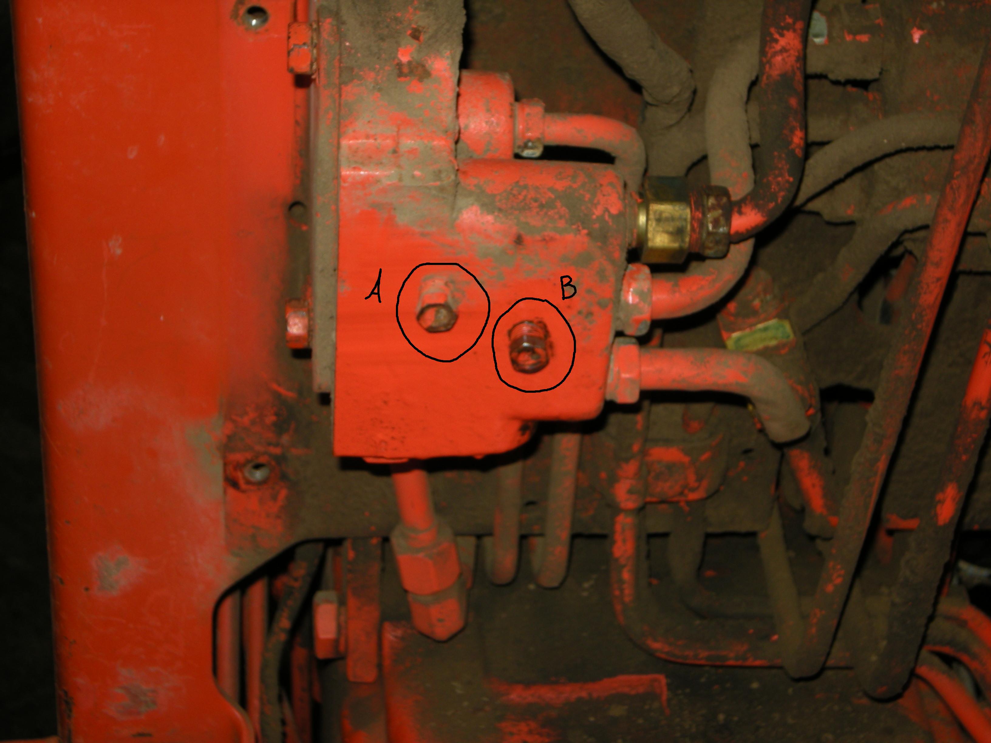

Hi guys,the PD clutch seems to be slipping in both Hi & Low range @ low rpm. If I rev the engine up to 800 - 1000 rpm it works ok. I&T book says to check pressure at 2000 rpm & it should be 290 psi. What pressure should it be @ idle. And can I check psi with gauge @ either A or B socket head plugs on the pto control valve showen in pic. Thanks Dave.

Sorry about tht over size pic, Try to do better next time.

Regulating valve in the PD valve is stuck, remove and polish up and I bet it won't slip any more. You can check pressure at those ports.
