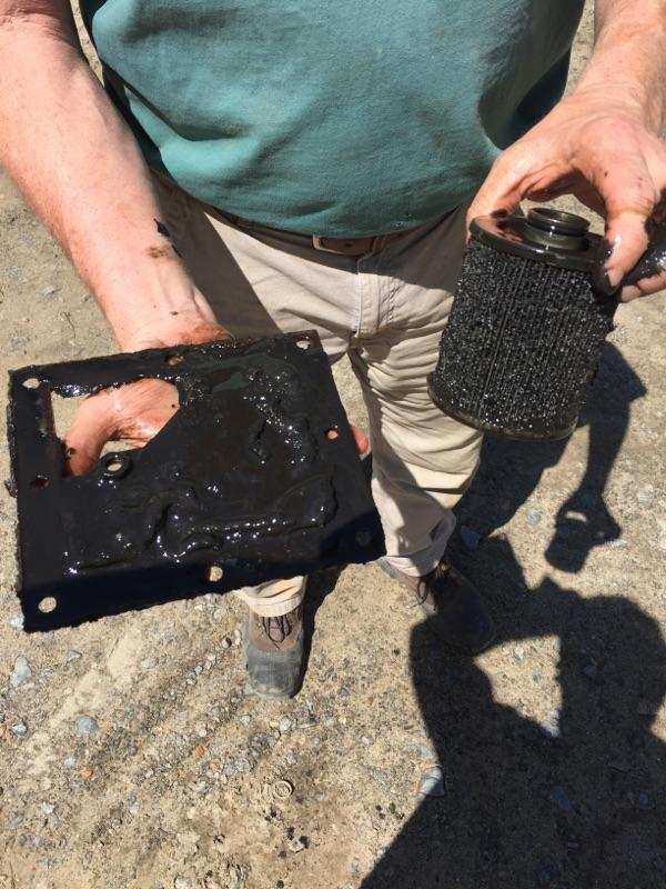

This is what I found in the strainer. I'm sure it is the first time we have had it off. Most likely first time ever for life of tractor. I will see if it increases the low RPM pressure.

After seeing picture of screen, I would say you need a pump and rebuild the PD.          MACK

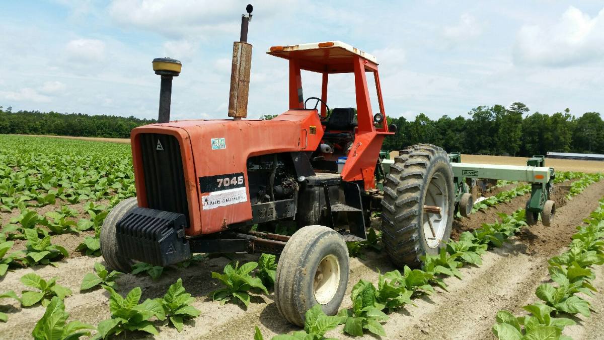

Yes, we are setting tobacco. These are tillage tractors from 70s and 80s. We pull them out once a year for this process. They are not pretty but wheel spacing is set for 48" rows so we do not have to move wheels in and out on our daily user tractors. I will try to get some pic of 7045 and 7060 working tobacco

Changing the filter and oil might help, but only for the short term. It looks like there's a lot of burnt stuff there.

Very cool pictures, thanks for posting them! Question? Do you grow the tobacco from seed or do you get the seedlings in trays from a nursery ready to set out?

As a Band-Aid to your problem, Caterpillar makes a 30 weight drivetrain oil (TDTO) that would be thicker than what you are using for trans oil.

Stan, we got coated seed and used 200 cell vacuum seeder to put the seed trays then put them on water.hydrophonics? A lot easier than the way we used to make tobacco beds and pull the plants to set.Looks like flue cured, a lot different than the burley we used to grow. Thanks for the pics Safe and good luck with the tractor. Scott

Cleaning the strainer and adding the 821 oil has picked up my low rpm reading to 135 psi. This should help, I would think. Still peaks at 190 ish when it is warmed up. Of course I will not know for sure until it is worked an hour or so. Thanks again
