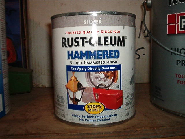

you can spray the orange... I do the "hammered silver" with a brush.. Resembles galvanized finish..
