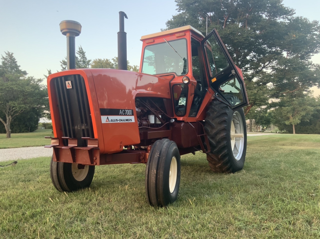

Keep those pictures coming! The more I see the more I like.

I think there is supposed to be a trim piece that holds the floor mat right at the door opening...... Great job though. Trade a 200 for it??? Wink

Very pretty inside and out. Great job!

I must say that sure looks good to me. I am not a good judge of these series, as I am stuck in the WD series tractors. But I see great attention to details and fresh clean look to all the areas. I agree that having a project during this pandemic is a good thing to keep us busy and keep our minds busy too.
The tractor looks new to me! Really rattle caned the whole thing Wow your finger must be needing a break!:)

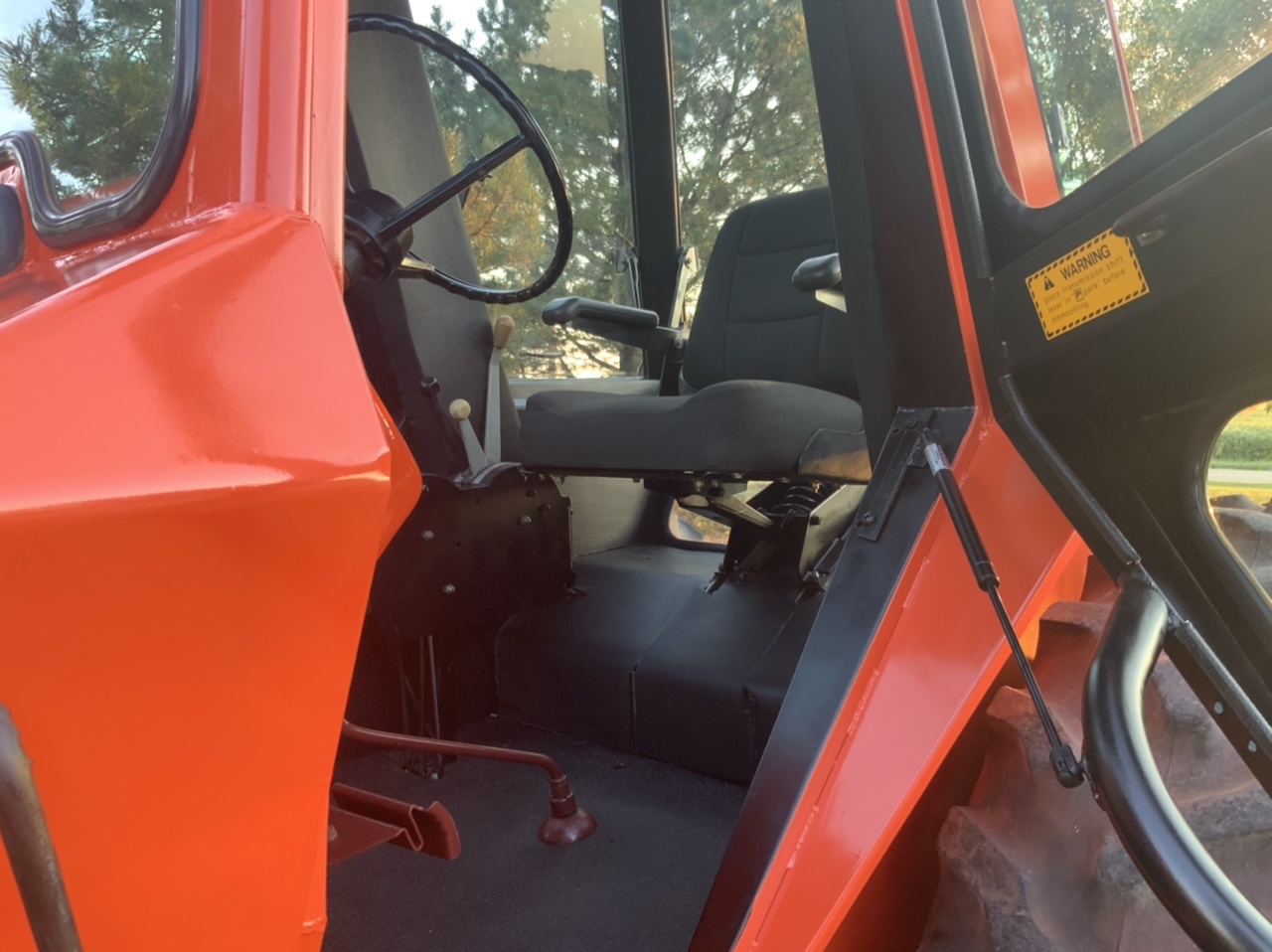

I'd like to see more pics of the door shock setup.

thanks. Actually, I do have a gun (not experienced) and since I wasn’t doing any large panels (body panels in front of cab are original paint), I worked small areas, then wet sanded larger areas before painting small areas and wet sanding again. The final coat, I did as large of an area I could and still recoat  wet on wet. Top and lights came off, windows and fixed door came out, all gaskets removed and a ton of Cleaning and masking done. I was amazed that what worked the best for removing overspray and light polishing was a clay bar treatment. I consider the clay bar to be probably the most important tool for restoring and maintaining paint. The original paint had darkened considerably, requiring polishing compound, clay bar and slightly abrasive polish like Nu Finish. Repeatedly. I hate re-painting faded panels in good shape. I always restore if possible. The paint job could still use more polishing, but that can be done later. These kinds of projects bring out the anal in me! Agco paint is expensive, but good paint. Did notice some variation in shades. Good luck finding maroon in stock that is still in decent shape. Best thing is to order in a 6pk for $15/can.

[QUOTE=AllisFreak MN]I'd like to see more pics of the door shock setup.[/QUOTE
I spent a lot of time on this. The idea behind a door shock is that as door closes, it goes negative (reverses direction), helping to hold door shut and a little push to open. I tried to achieve that by adding the tubing. It would have to spaced further away from Door to really fully achieve that.

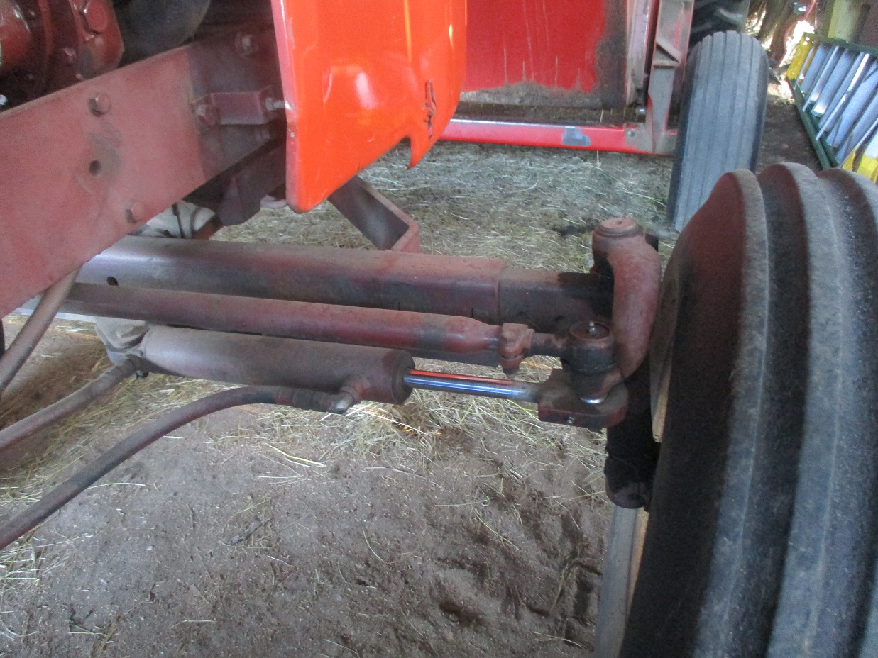

I was amazed at how well your dash came out. I noticed your temp, fuel gauge and steering cylinder are different than mine. My 7000 serial number is 4967.
The front axle was exchanged with our 7010 years ago. We needed the heavier axle for loader work. I had the cylinder rebuilt and told them it was a 7010 cylinder. They said it was the ordinal 7000 cylinder. Gauges are original. Serial 4216.

I took Tom's kit and mounted it where you did on 3 of my tractors. My doors didn't seal very well when I installed it on top.

Does that pipe get in the way getting in and out of the cab? How much further out do you think it needs to be?

Lonn I don't have a pipe on mine, I went straight to the door. That pipe might be a nice handle when a fella gets a little older.

the original idea with the pipe on the door was to get the cylinder at an angle to either stop moving or move back out as the door closes. This makes a huge difference on how the cylinder acts. Go look at a modern tractor door. Also, the door is capable of opening considerably more than original, and this one does, so pipe doesn’t get in the way and does make a good handle. Don’t think for a minute that I shaped that pipe. It was already that shape and I adapted it to the door. I would love to take credit, but I’m not that good.
