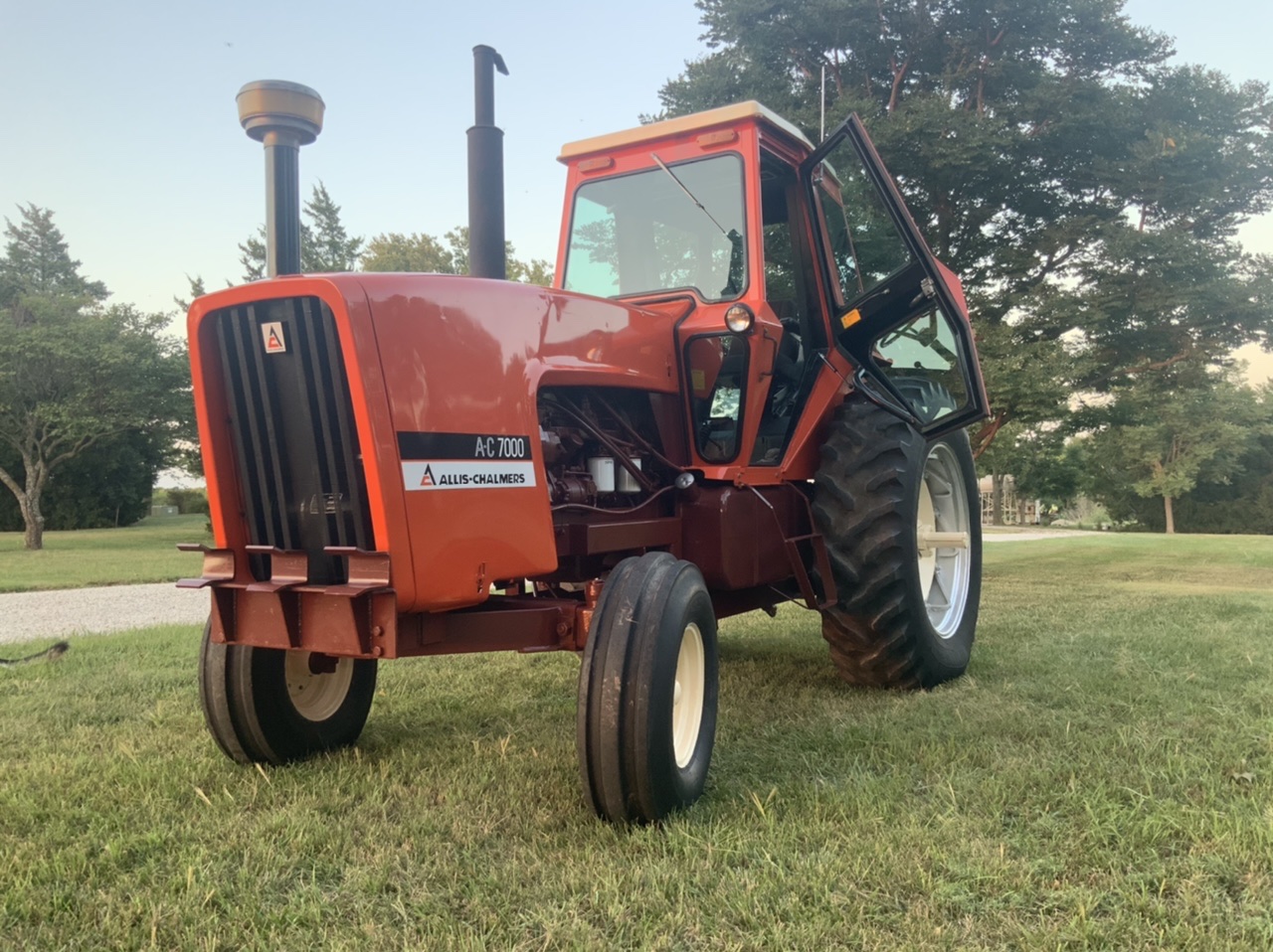

I uploads/20613/1E4C3347-7454-4644-BADB-639B30E53BE1.jpeg" rel="nofollow - uploads/20613/1E4C3347-7454-4644-BADB-639B30E53BE1.jpeg uploads/20613/10856E22-1187-45B8-A74C-BAE75CA6D262.jpeg" rel="nofollow - uploads/20613/10856E22-1187-45B8-A74C-BAE75CA6D262.jpeg
This has been my 6 month Covid project. This is a one owner tractor. The hood and grill are original paint. Black belly upholstery kit in the cab.

Awesome job ,looks great. Credit to you.👍👍
Posted By: Play Farmer
Date Posted: 31 Aug 2020 at 5:41am
VERY nice!
Posted By: T-bone_indy
Date Posted: 31 Aug 2020 at 5:46am
Now that's one nice tractor! looks great

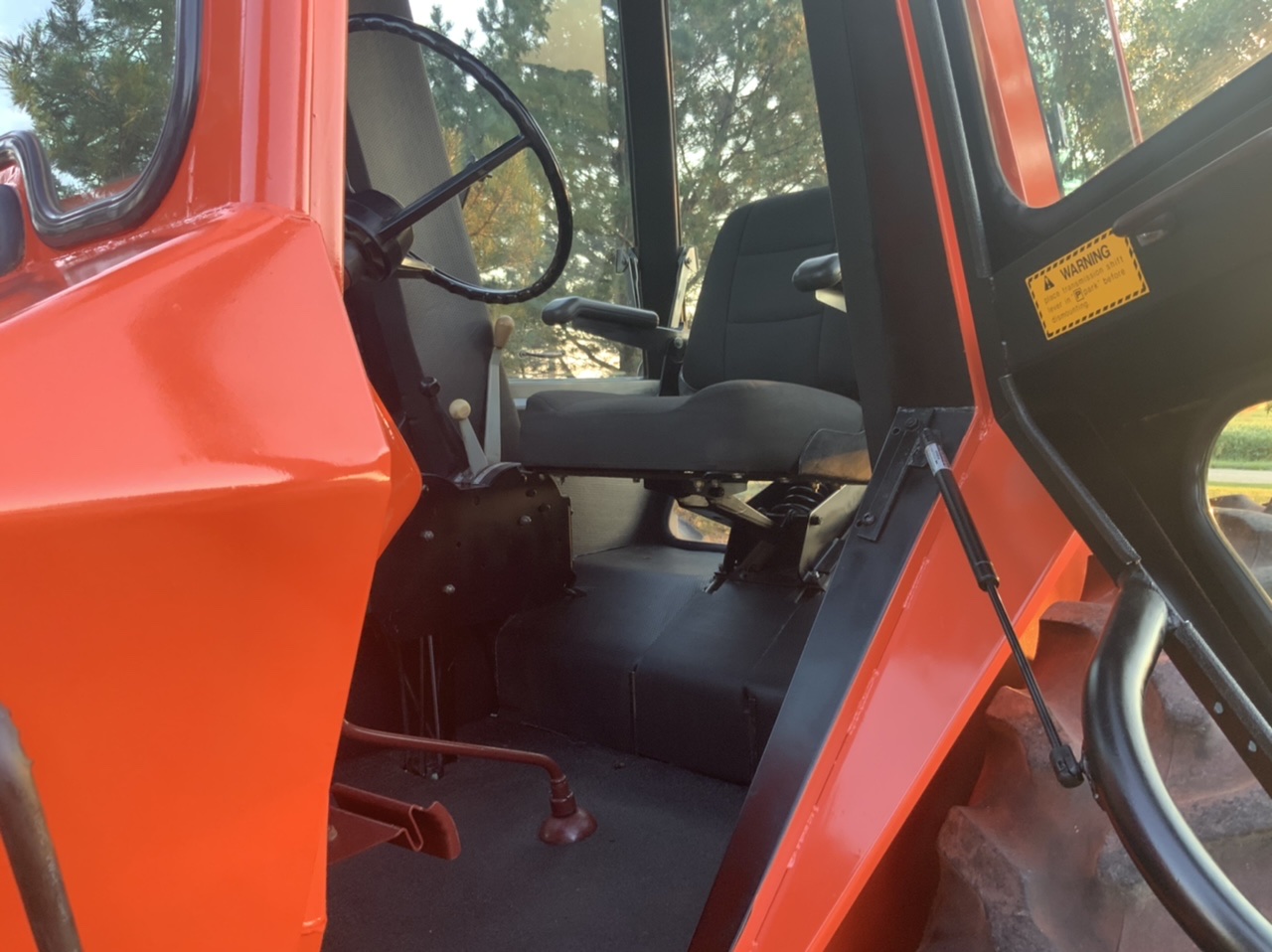

You did a nice job. I see you have a custom gas strut and bracket for opening the door. What did you use for the maroon paint.
  Tim
Posted By: Maroon belly
Date Posted: 31 Aug 2020 at 12:20pm
the door kit is from tomNE. It’s supposed to be mounted at top of door, but I didn’t like how it torqued the door, so I moved it mid door. The bracket I made to get the strut to work better. The paint used was ac Persian and ac maroon in rattle cans and lots of wet sanding before and between coats. The front axle was exchanged off our 7010 for loader work. The additional frame was the quick mount for the farmhand loader now used on my jd 7700. It benefited the tractor by eliminating the twisting that caused oil leaks. There is around 7400 hrs on the tractor. It had an preventive underhaul at 5000hrs. I appreciate all the kind comments.

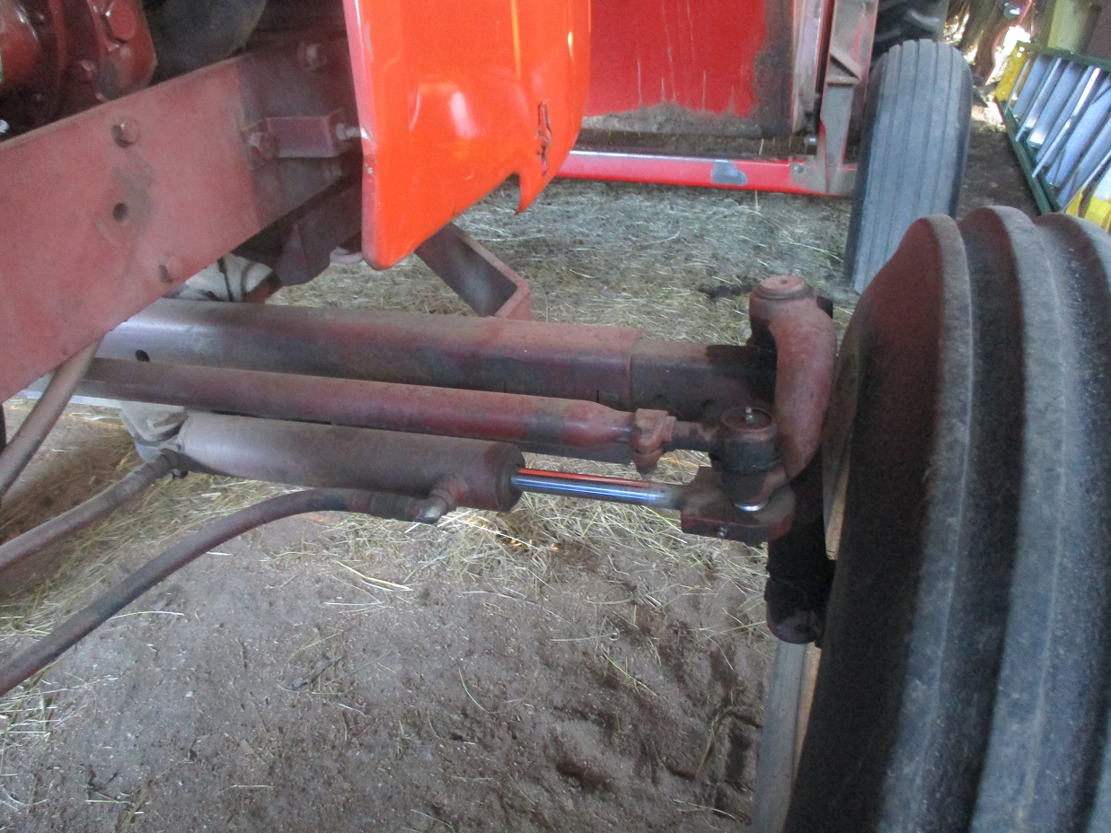

Looks great!  When you say oil leaks from twisting, is that from the front cover and engine plate area?  I'd be interested in seeing a close up of how it reinforces the frame rails because mine leaks there again after all new gaskets and seals on the front plate several years back (along with a patched oil pan where it cracked from the flexing).

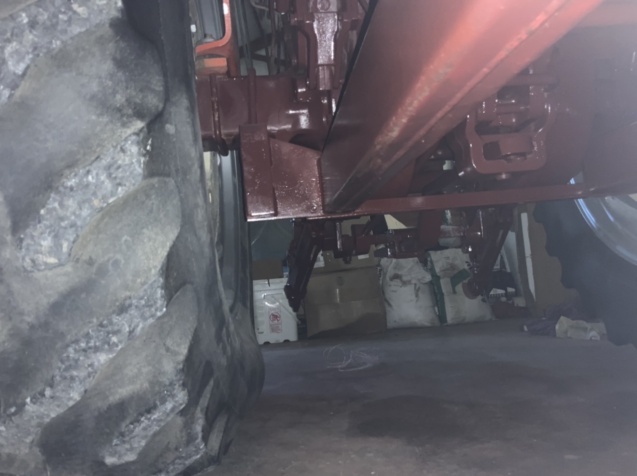

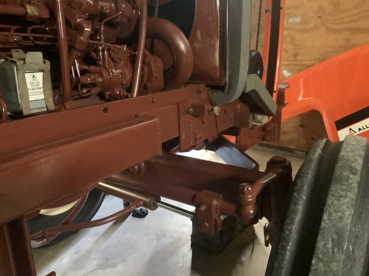

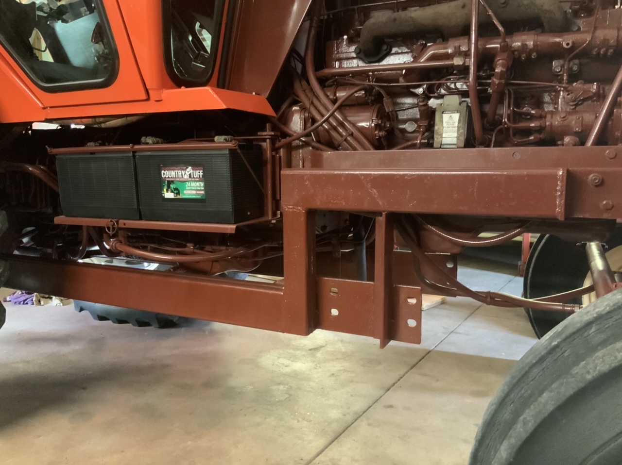

[QUOTE=Hurst]Looks great!  When you say oil leaks from twisting, is that from the front cover and engine plate area?  I'd be interested in seeing a close up of how it reinforces the frame rails because mine leaks there again after all new gaskets and seals on the front plate several years back (along with a patched oil pan where it cracked from the flexing).
Hurst
[/QUOTE
The reinforcement runs from the back axle (first pic) to the front of tractor to weight bracket (second pic). My loader mount takes place of weight bracket, but essentially same thing. Last pic shows center portion of framework.

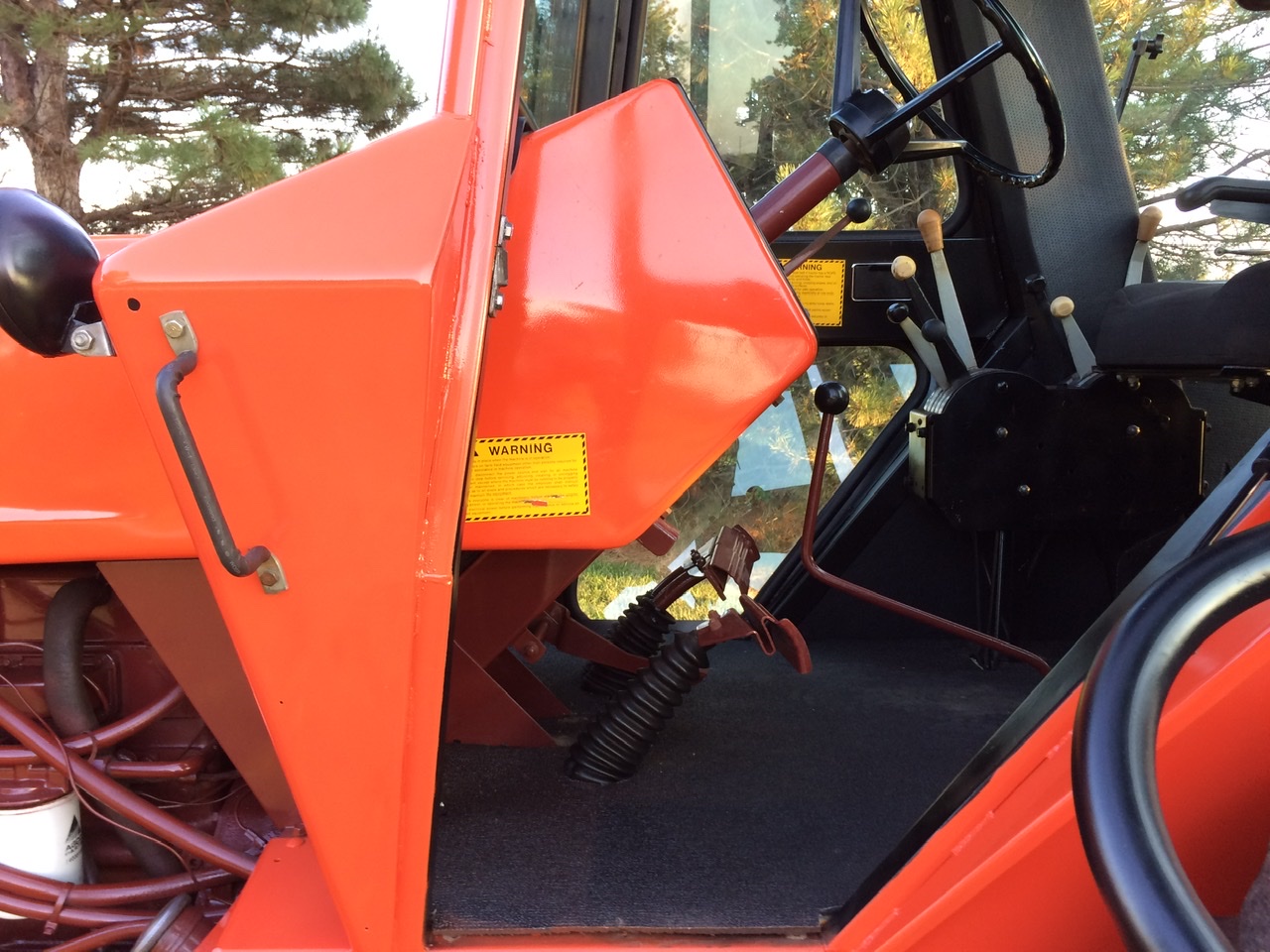

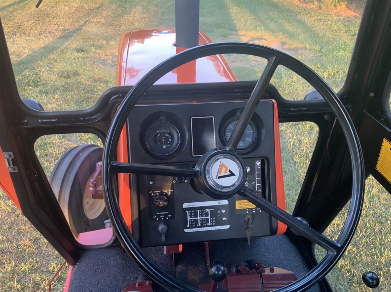

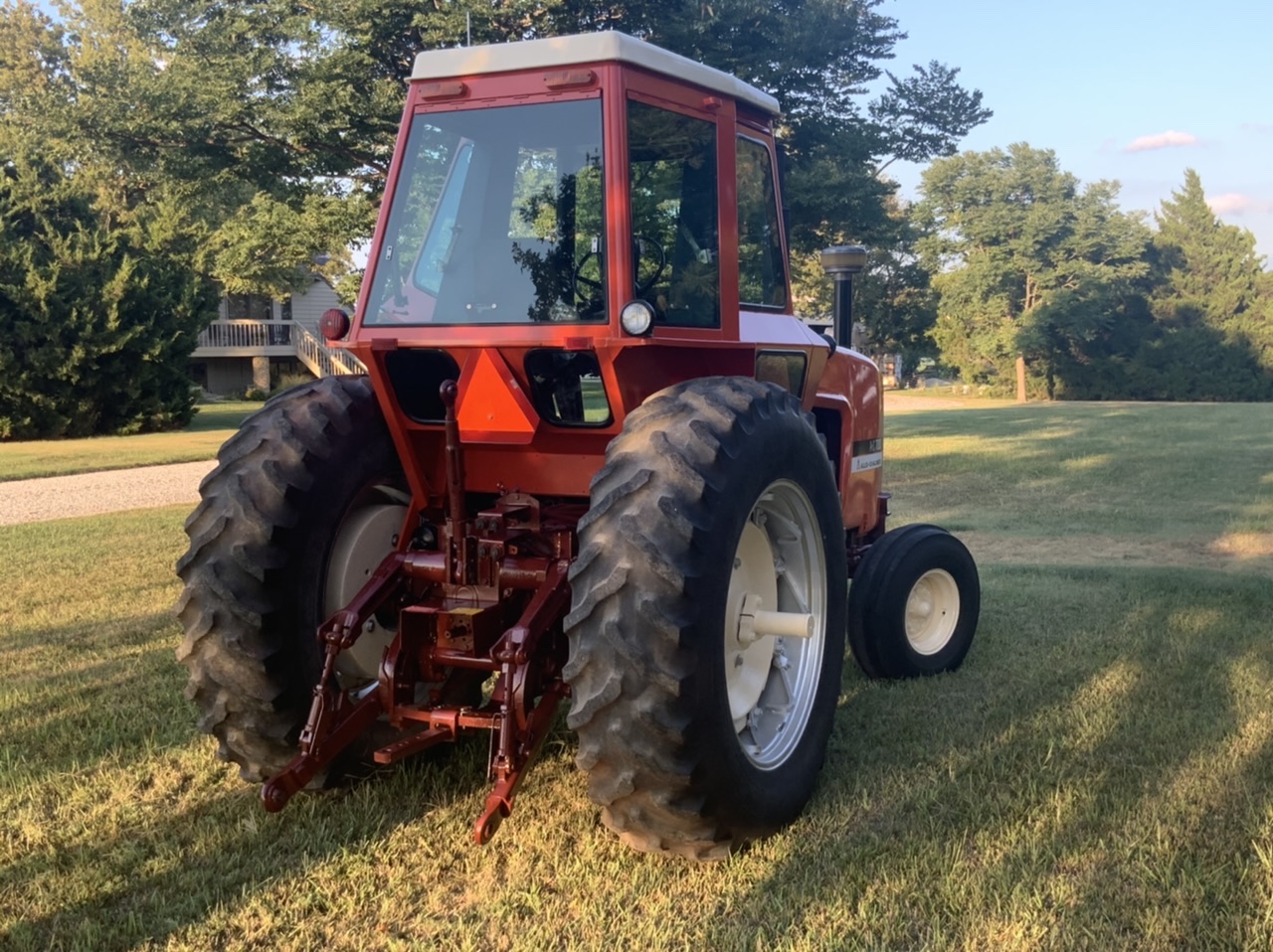

I thought I would add some pics of interior and rear end.  uploads/20613/62BB52E6-743F-406A-AFCC-F0C341876E95.jpeg" rel="nofollow - uploads/20613/62BB52E6-743F-406A-AFCC-F0C341876E95.jpeg

I think there is supposed to be a trim piece that holds the floor mat right at the door opening...... Great job though. Trade a 200 for it??? Wink
Yes, I think I lost it. Anyone have one for sale?

[QUOTE=AllisFreak MN]I'd like to see more pics of the door shock setup.[/QUOTE
I spent a lot of time on this. The idea behind a door shock is that as door closes, it goes negative (reverses direction), helping to hold door shut and a little push to open. I tried to achieve that by adding the tubing. It would have to spaced further away from Door to really fully achieve that.

I was amazed at how well your dash came out. I noticed your temp, fuel gauge and steering cylinder are different than mine. My 7000 serial number is 4967.
Date Posted: 04 Sep 2020 at 9:51am
The front axle was exchanged with our 7010 years ago. We needed the heavier axle for loader work. I had the cylinder rebuilt and told them it was a 7010 cylinder. They said it was the ordinal 7000 cylinder. Gauges are original. Serial 4216.

After years of yanking it in and out, the plastic cracked and I riveted in a metal plate.

I took Tom's kit and mounted it where you did on 3 of my tractors. My doors didn't seal very well when I installed it on top.
Posted By: Lonn
Date Posted: 08 Sep 2020 at 10:08pm
Does that pipe get in the way getting in and out of the cab? How much further out do you think it needs to be?
Wink
I am a Russian Bot
Posted By: DIESEL
Date Posted: 08 Sep 2020 at 11:31pm
Lonn I don't have a pipe on mine, I went straight to the door. That pipe might be a nice handle when a fella gets a little older.
Date Posted: 09 Sep 2020 at 8:08am
the original idea with the pipe on the door was to get the cylinder at an angle to either stop moving or move back out as the door closes. This makes a huge difference on how the cylinder acts. Go look at a modern tractor door. Also, the door is capable of opening considerably more than original, and this one does, so pipe doesn’t get in the way and does make a good handle. Don’t think for a minute that I shaped that pipe. It was already that shape and I adapted it to the door. I would love to take credit, but I’m not that good.
