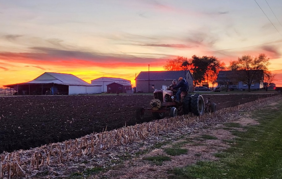

Post Options Post Options   Thanks (0) Thanks(0)   Quote Skip, W.Pa Quote  Post ReplyReply Direct Link To This Post Posted: 02 Feb 2026 at 7:03pm

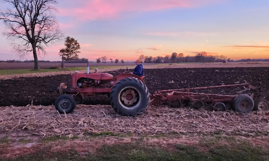

Must be a pretty good running 45 to pull that plow. I bet that makes her bark. Nice to farm table top flat farms. Don't think she would like to pull that here in Pa. on our hills!

Post Options Post Options   Thanks (0) Thanks(0)   Quote Ed (Ont) Quote  Post ReplyReply Direct Link To This Post Posted: 02 Feb 2026 at 7:06pm
Is that 4 furrow? How wide?? Wow.
Points: 8970
Post Options Post Options   Thanks (0) Thanks(0)   Quote SteveM C/IL Quote  Post ReplyReply Direct Link To This Post Posted: 02 Feb 2026 at 7:23pm
4-16's...8 inches,2nd gear. Was giving grandson some fun. Wanted to take his place. Lol

In this pic i was cheating on the plowed ground so the final pass was full and followed the edge.

Post Options Post Options   Thanks (0) Thanks(0)   Quote Steve in NJ Quote  Post ReplyReply Direct Link To This Post Posted: 04 Feb 2026 at 8:56am
Great pics Steve! The sunset one is a Calendar pic! Ya did great with the pics! Thanks for sharing!

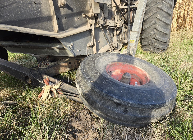

Walking on eggshells. Can't see if got corrct pic til"post". Oh well. Locked brake and spin F2 around in grass. Cracked weld and uneven ground combined for disaster. The 62 had broke the fan pulley the night before while unloading on the go. Warning light and beeper. WTH! Killed everything quickly! Never heard an engine boil like that. It went on and on. Left it set and grabbed the F2 next day while waiting on parts and this happened. Depressing to have 2 machines broke at same time. Complete salvage yard axle the next day got the F2 going and new parts for the 62 allowed "field repair" so only down 2 days.

Post Options Post Options   Thanks (1) Thanks(1)   Quote AC720Man Quote  Post ReplyReply Direct Link To This Post Posted: 04 Feb 2026 at 10:48am
Steve, you can hit the preview button and it should show the pic before you post it. If it’s not the one you want just hit the clear button and start over. You’re lucky to have salvage yards near by, we have none. Thankfully Gary Burnett has some good parts and he is only an hr away.

Ugghh! Seen that before. Uncle was mad saying that should be a warranty item. Me? I rolled my eyes, jacked it up, took the axle back to the shop and welded it back together. Added a 3” strap formed around the end and welded it in for extra strength. Took a day
Considered the same but it bent tie rod ends and snapped the steering cylinder so complete assembly was the easiest.

SteveM C/IL, most every 70s mfg gleaner that breaks off its rear steer spindle will tear it’s RIGHT spindle away from axle tube frame. Why? Because ALL of the steering shock loads from both steer tires transfer back to the hydraulic steer cylinder. The hydraulic fluid in the steer cylinder isn’t going to compress from the shock loads, so the adjacent weak point is just beyond the cylinder - the right wheel spindle. It flexes some for every shock load (years/decades?)until it finally fatigues & then breaks loose from the axle frame.
And it will most likely happen again after an axle swap repair unless the steer cylinder base mounting along with its corresponding right spindle push leg are completely cut-off from the rear of the axle tube frame & right spindle and then the entire cylinder is remounted onto the leading left front of the axle tube frame where the cylinder’s base can be welded near the center of the axle frame & the cylinder’s push leg (from right spindle)can then be welded directly to the tie rod close to left spindle.
After the cylinder is repositioned, steering shock loads will still happen. But the tie rod becomes the sacrificial item & mostly it just flexes. Have done several this style & never seen any breakage afterwards.

It really is surprising they never put a little heavier rear axle on those machines with all the issues people had. It "looks" like it would be a weak spot and it is.
