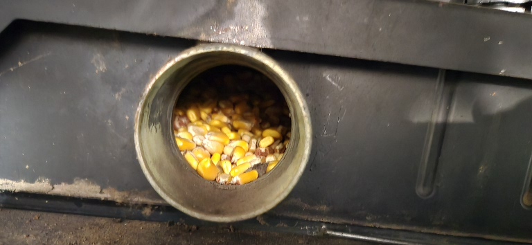

Had upper rad hose off a couple days...Mr mouse thought that looked like a good spot to nest. Vacuum cleaner and some bent wires got it. On my R62.Had it drained to replace thermostats. Took too long....
