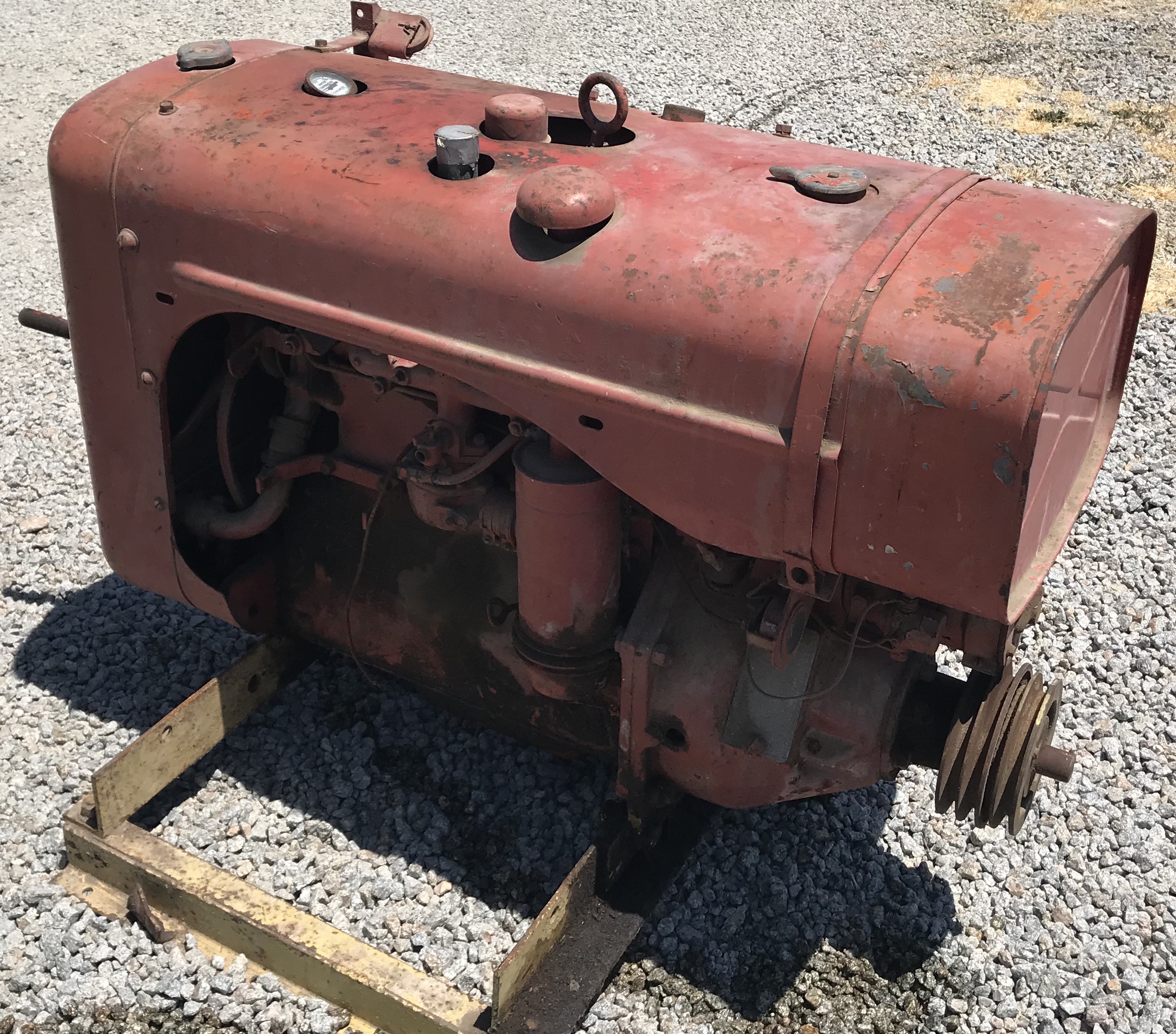

Got this yesterday not seized but don't know if it runs was stored inside for 20+ years old guy said it was on a lettuce harvester.  Missing the generator and cap for the gas tank and the muffler. It's got the distillate tank and gas tank on it.  How do I figure out what year it is?

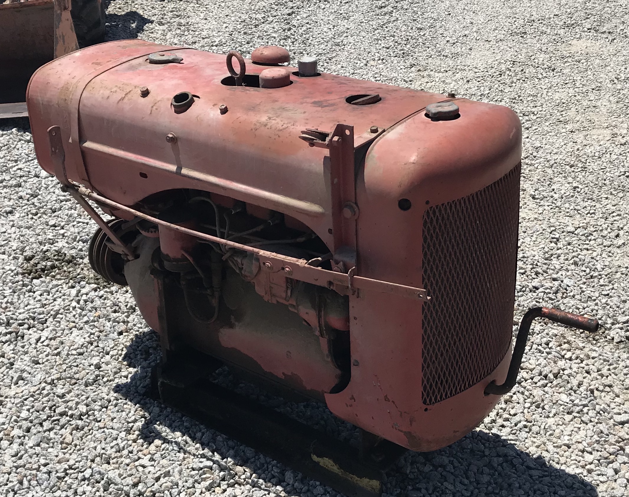

here's another shot of it

I think I can see some numbers stamped behind the air cleaner, in your pecs.  Look on the flange of the motor, area in question is sloped downward, at 45º, last inch of the motor casting, at the back end, left side, as viewed from operator's position, if it were a tractor.
Looks like a B power unit...Wink

Ok so I pressured washed all the gunk off of the unit.  Found an aluminum plate stamped with Allis Chalmers Power Unit Model B-125  Serial number as best as I can see it is
 PU-87246 followed by a B.  So if I just go by the numbers on that it is a 1947

Ok guys I found the serial number for the engine on the B125.  It is as best as I can tell
CE168259KA.  So if I read that correctly it was built in 1951 and the KA means it is a kerosene engine.  What does the CE mean?

I think CE means that it is a C Engine.  The only difference is in how the HP was rated, at a higher RPM, to give the C engine about 2 more HP. If yours is a distillate (kerosene) engine, its not much more HP, than a B engine, due to a lower compression ratio...
It is possible that an engine from a tractor was swapped into the power unit, at some time in the last 60+ years...Wink

DIY  That's what I was able to find out too about the C engine.  Just needed to confirm it. So that means it was off a C tractor but also a kerosene tractor.   That is what was confusing me.  Still pretty cool though.

“CE” at the beginning of the engine serial number, means it left the factory as a 125 CID engine.

Looks like CE 168259 KA would be an early 1952 as per Bryan Clemson website.
