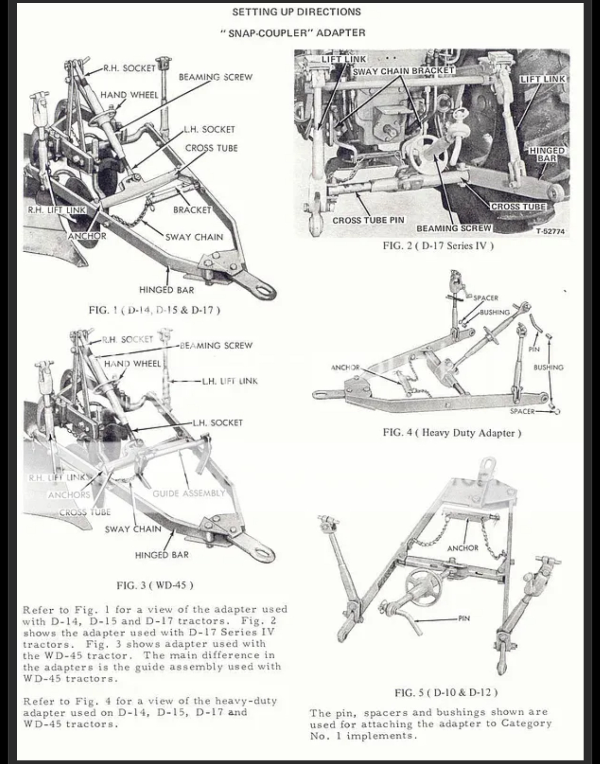

Kinda re-inforces how far ahead of the game an AC snap coupler hookup is...Wink

  Still nothing can be as easy as the SnapCoupler or FastHitch systems. The SnapCoupler has the advantage in that ALL adjustments stay with the implement and each is adjusted just as it was unhitched ready to work exactly as it did the last time it was used.

The factory Allis 3 point adapter could be left on the implement..
