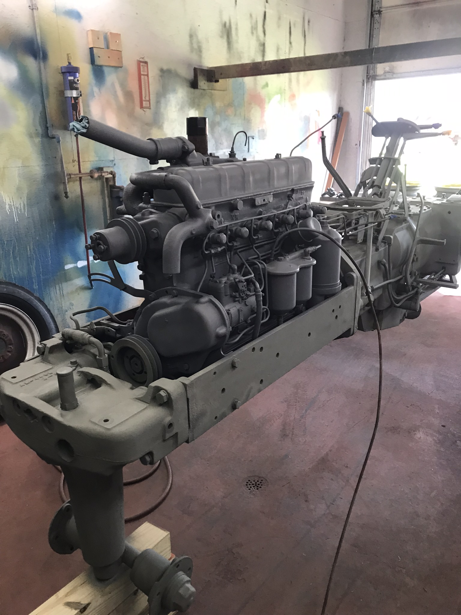

I only use PPG single stage. It sprays smooth and I’m not sure why but I’ve had really good luck spraying it right from the beginning when I had very little experience. Nothing fancy, Harbor Freight HPLV spray gun, the purple one. Less than $20. My buddy has a farmers paint booth, closed in a 12x30 part of his hay shed. Concrete floor, OSB walls painted white with angle lighting about 8’ off the floor. On one end there are 2-20”x20” fresh air vents with a filter. At the other end is a double fan sucking air/paint fumes out. I usually wear a white paper paint suit and dual filter paint respirator also sold at Harbor Freight. Always make sure the room is clean and I spray the floor with water to prevent any dust from getting in the paint when I’m spraying. Good prep work is necessary to get a nice job. The paint job will only turn out as good the hard work that you put into it. I sand blast all my sheet metal, also the entire tractor years ago outside until I started using a air powered needle scaler. Works great on cast, the frame and wheels. Do not use on sheet metal! I do all my own body work if possible, but a really good friend of mine(ACMutt)helps me when I need it. He has also given me painting advice over the years. Started painting my own tractors and garden tractors about 12 years ago. Patience is key, my 190XT, and my D17 Diesel were12 month projects including repairs. I repair, rebuild, or replace anything that needs it. I like to take them to events to show but they get worked on the farm as well. Especially during hay season.

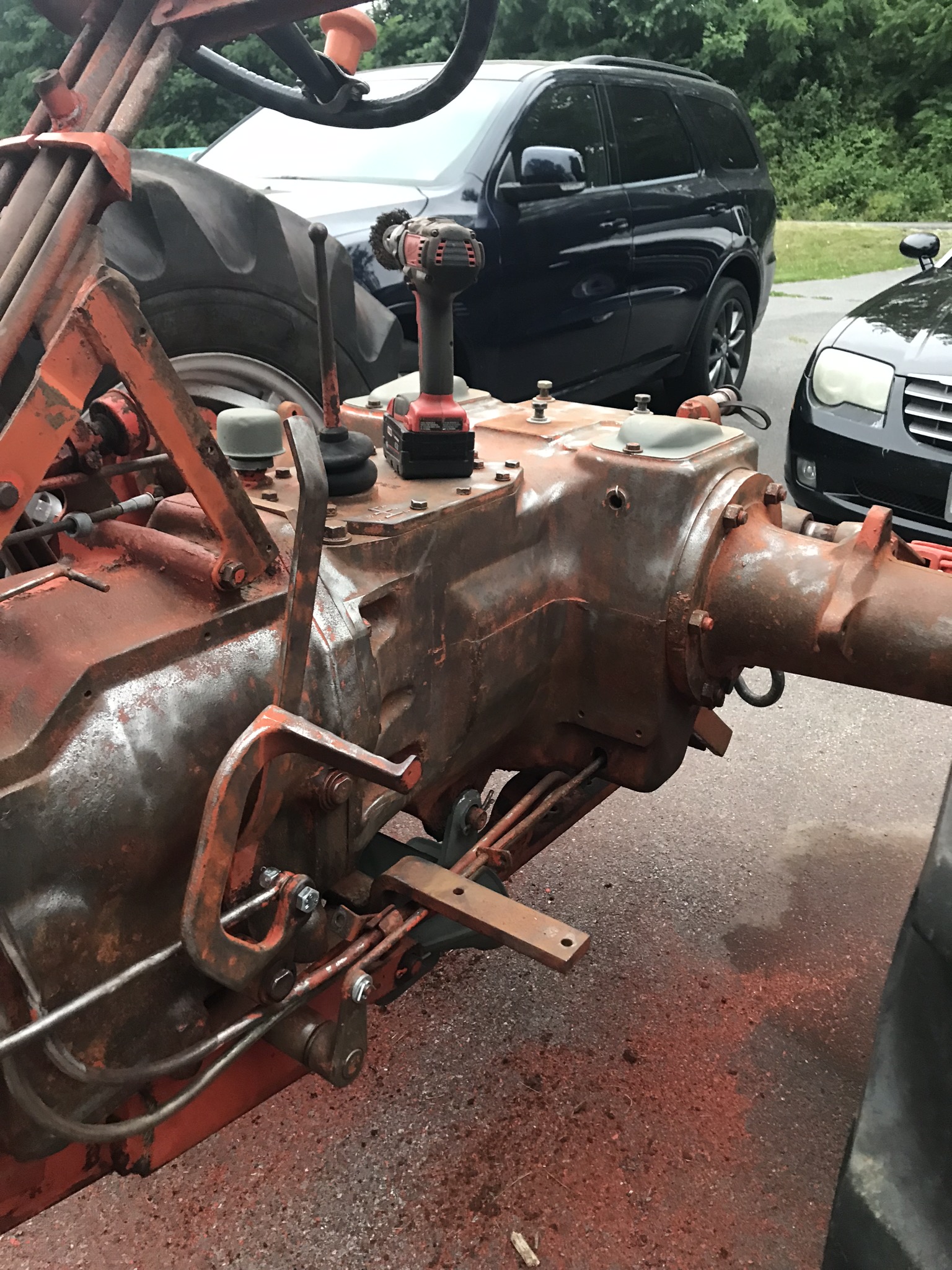

Forgot to add, I spray green etching primer. Prevents rust and gives the paint a good base to stick to. Usually 3 coats of paint to make sure everything is covered well and to have a nice deep shine.
Just a few of my projects.
Points: 5246
Post Options Post Options   Thanks (0) Thanks(0)   Quote AC720Man Quote  Post ReplyReply Direct Link To This Post Posted: 31 Jul 2025 at 11:06pm

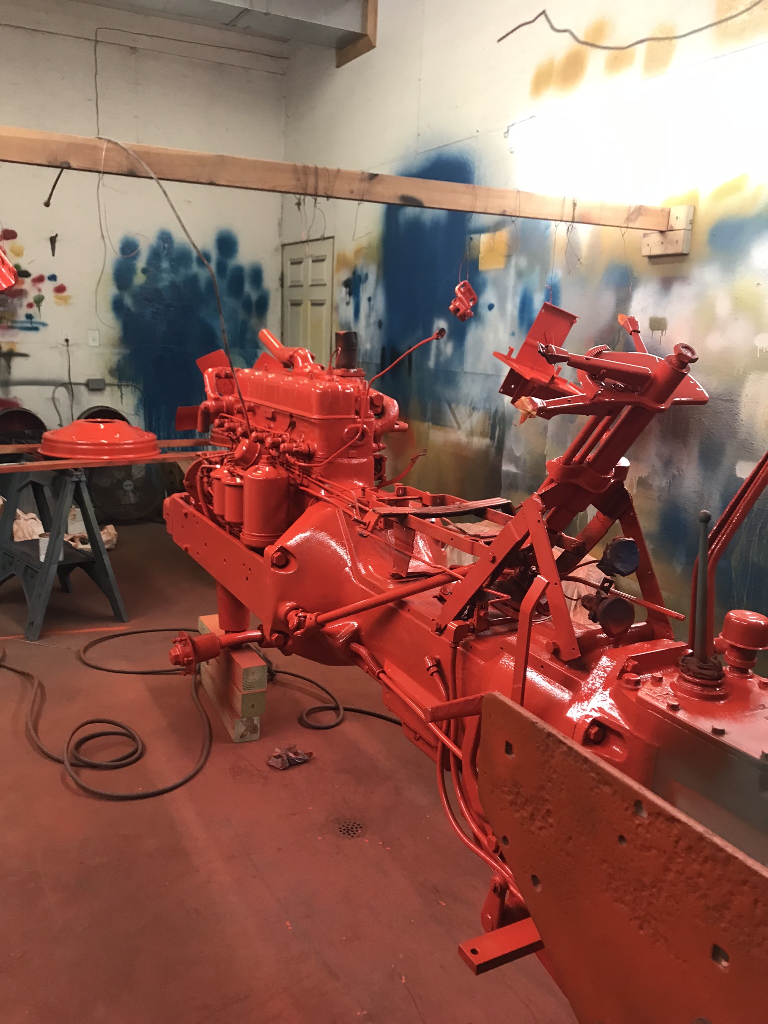

Honestly, lay down on my back. Also on my knees when I come up from the bottom of the tractor at an angle. Just have to angle the paint gun anyway possible to get paint where you need it. Not easy to do at times. The last picture was of some of my 190 parts, just showing how parts get hung. That picture was 9 years ago, since then, new fans have been moved to the end of the room instead of the side.

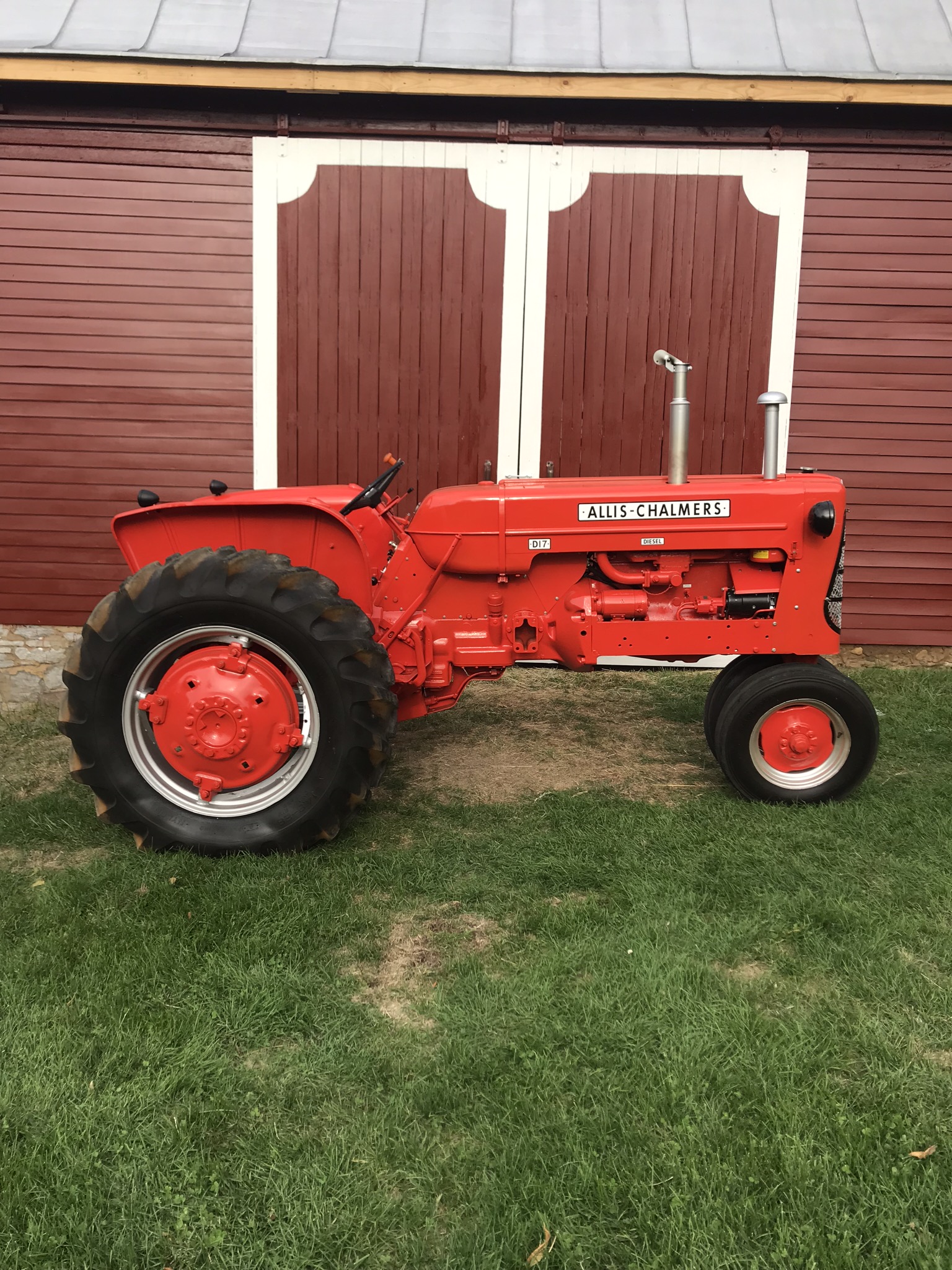

Thanks for the paint information.  I get overwhelmed reading about the myriad of paint formulations and choices, so it's good to have a solid recommendation for something that has worked for them.  I guess the only question is if the color of the new formulation would look too reddish on a full tractor, compared to the pictures of your older restorations.  I would think a difference in color on a smaller part wouldn't be noticeable, whereas a full tractor color might really jump out at you.  I wonder if anyone on the forum has tried the PPG "Range Rover Red" on an entire tractor, and how they liked it?
Points: 5246

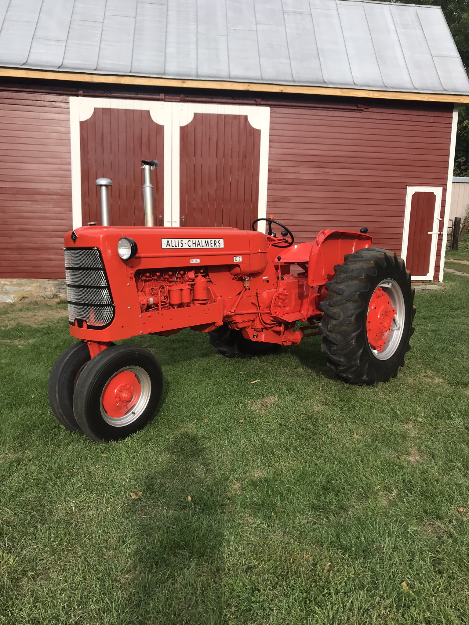

Post Options Post Options   Thanks (0) Thanks(0)   Quote AC720Man Quote  Post ReplyReply Direct Link To This Post Posted: 02 Aug 2025 at 11:03am
My D17 is entirely that color. Painted it last year and I just purchased more paint for my D14 project. I’m happy with it, I’ve had a lot of good compliments on it and I have never had anyone doubt its PO2. The more coats of paint you put on the deeper and more rich it will look.
Edited by AC720Man - 02 Aug 2025 at 11:21am
Points: 5246
Post Options Post Options   Thanks (0) Thanks(0)   Quote AC720Man Quote  Post ReplyReply Direct Link To This Post Posted: 02 Aug 2025 at 8:23pm
This is what it looks like, you be the judge if you like it. You won’t hurt my feelings if you don’t like it.

Post Options Post Options   Thanks (0) Thanks(0)   Quote WF owner Quote  Post ReplyReply Direct Link To This Post Posted: 03 Aug 2025 at 6:11am
It does look a little redder than PO2. It almost looks like a cross between PO1 and PO2.
It looks pretty darn good to me!!!

Post Options Post Options   Thanks (0) Thanks(0)   Quote Oldwrench Quote  Post ReplyReply Direct Link To This Post Posted: 03 Aug 2025 at 7:06am
Thanks again for the information.  It does look a little reddish, but is still a vibrant, great looking color.  Now I've got a lot of work ahead of me to strip and prep the tractor for new paint.
