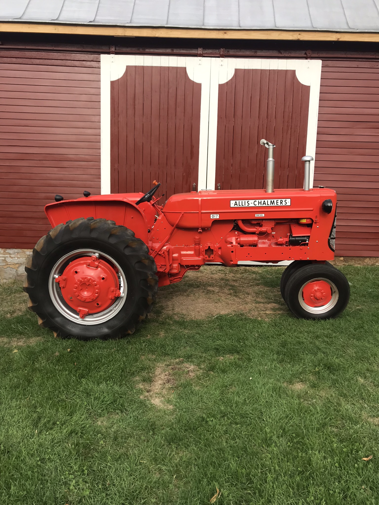

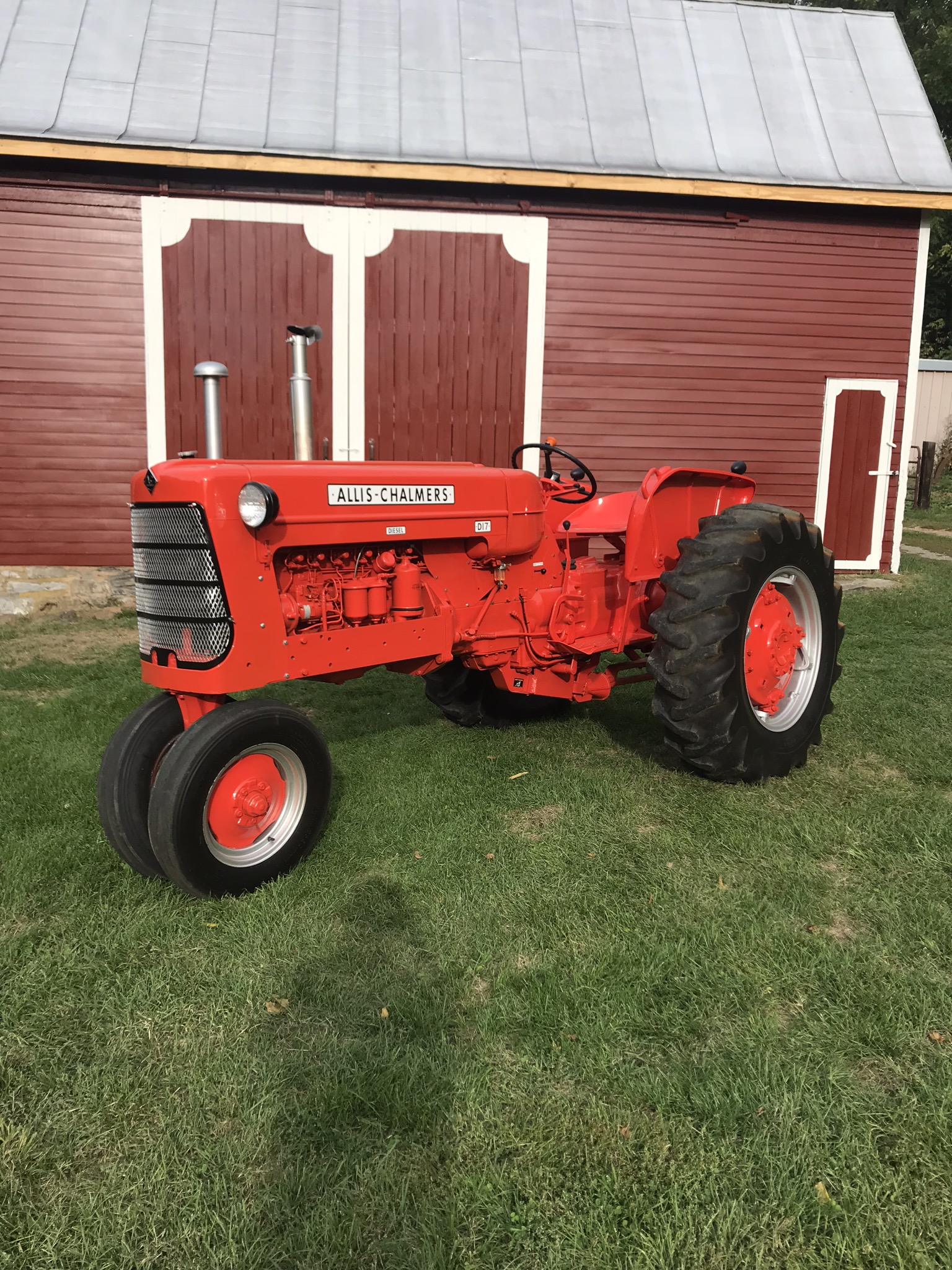

Thanks for the paint information.  I get overwhelmed reading about the myriad of paint formulations and choices, so it's good to have a solid recommendation for something that has worked for them.  I guess the only question is if the color of the new formulation would look too reddish on a full tractor, compared to the pictures of your older restorations.  I would think a difference in color on a smaller part wouldn't be noticeable, whereas a full tractor color might really jump out at you.  I wonder if anyone on the forum has tried the PPG "Range Rover Red" on an entire tractor, and how they liked it?
Posted By: AC720Man
Date Posted: 02 Aug 2025 at 11:03am
My D17 is entirely that color. Painted it last year and I just purchased more paint for my D14 project. I’m happy with it, I’ve had a lot of good compliments on it and I have never had anyone doubt its PO2. The more coats of paint you put on the deeper and more rich it will look.
Posted By: AC720Man
Date Posted: 02 Aug 2025 at 8:23pm
This is what it looks like, you be the judge if you like it. You won’t hurt my feelings if you don’t like it.
Posted By: WF owner
Date Posted: 03 Aug 2025 at 6:11am
It does look a little redder than PO2. It almost looks like a cross between PO1 and PO2.
