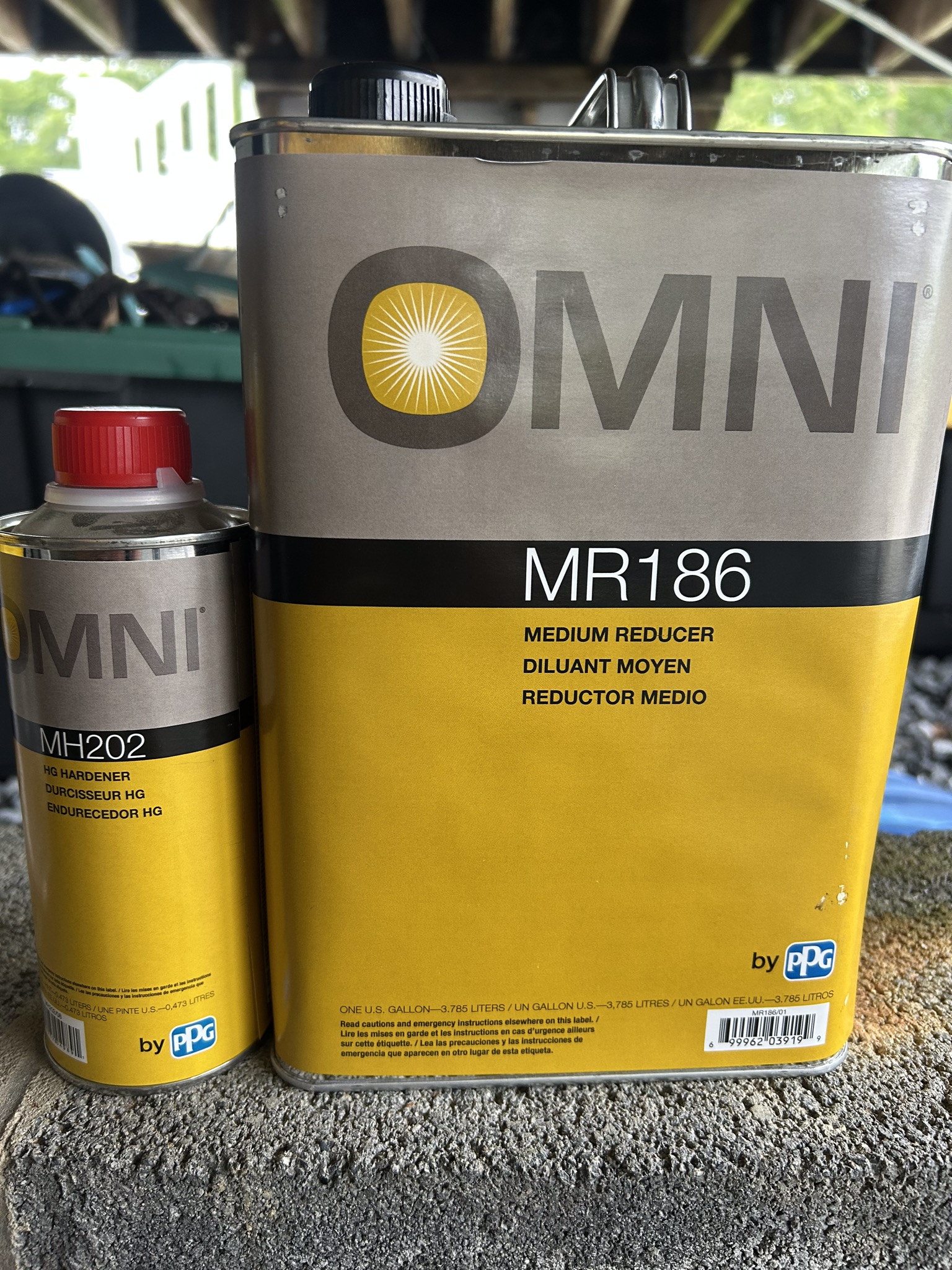

Again, really nice work.  For the record, could you provide the PPG paint code or product number for the PO2 paint?  I think the color is spot on in all of your pictures.  Do you use hardener with it?
Points: 5209
Post Options Post Options   Thanks (0) Thanks(0)   Quote AC720Man Quote  Post ReplyReply Direct Link To This Post Posted: Yesterday at 11:25am
I will get you a picture later this afternoon . Paint, hardener, thinner. 8-1-1 mix rate in that order.

First off, according to my PPG dealer, some pigments that make up PO2 orange are not available anymore. Not sure if that’s correct so I took a part off my XT that was PPG PO2 from 2018. Computer scanned and they came up with Range Rover red. Personally I think it needs more orange tint to it but it has grown on me.p
