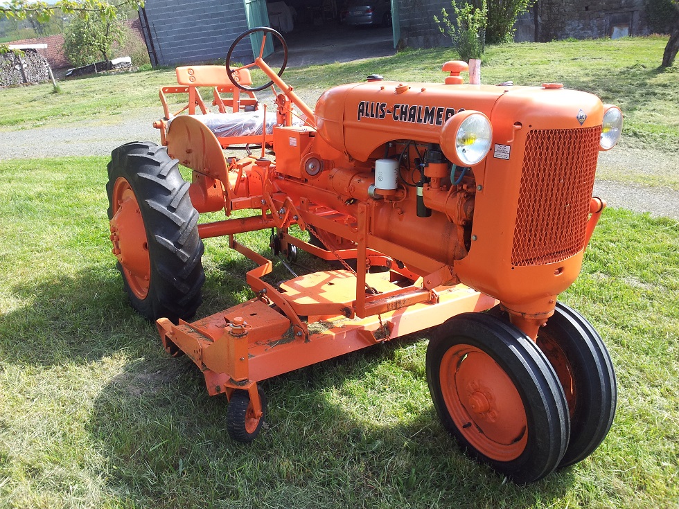

Glad to hear you found the problem. Super nice looking tractor and mower. Leon

Nice looking!!!  Glad you figured it out.  They ARE simple.
Looks like you have some kind of horn hooked up and what's with those headlights?  They look oversize and Yellow bulbs?
