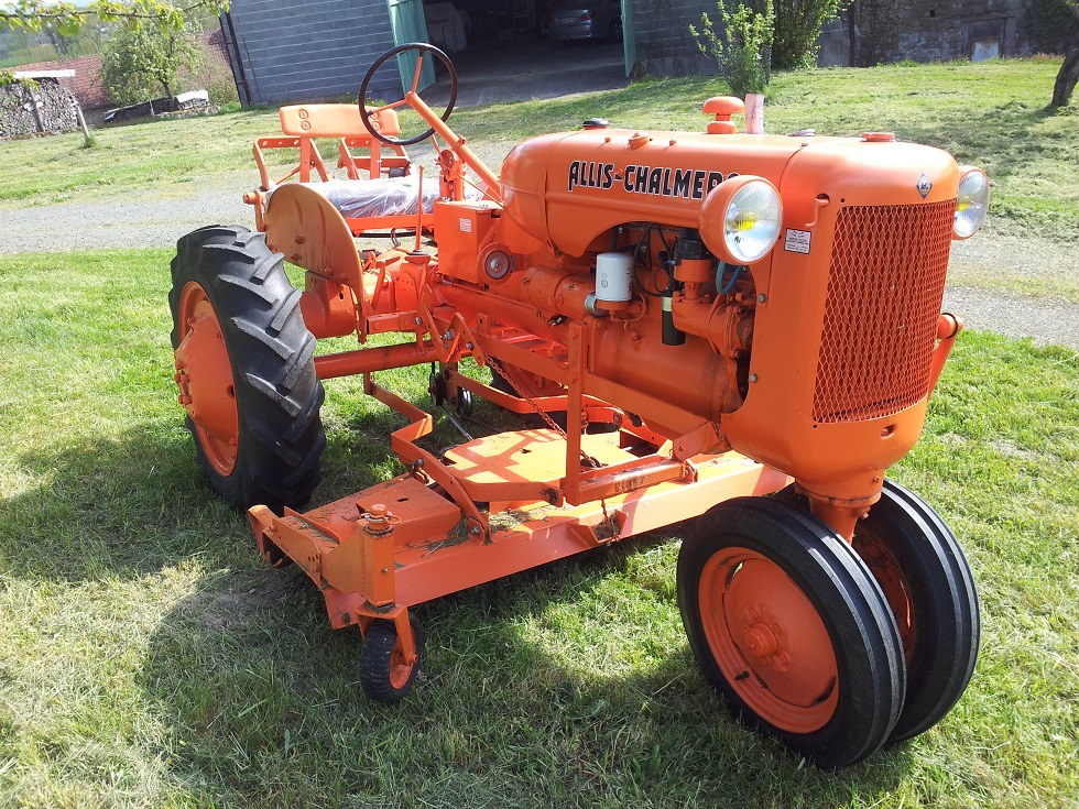

Glad to hear you found the problem. Super nice looking tractor and mower. Leon
Points: 18943
Post Options Post Options   Thanks (0) Thanks(0)   Quote Ted J Quote  Post ReplyReply Direct Link To This Post Posted: 03 Apr 2018 at 9:24pm
Nice looking!!!  Glad you figured it out.  They ARE simple.
Looks like you have some kind of horn hooked up and what's with those headlights?  They look oversize and Yellow bulbs?
