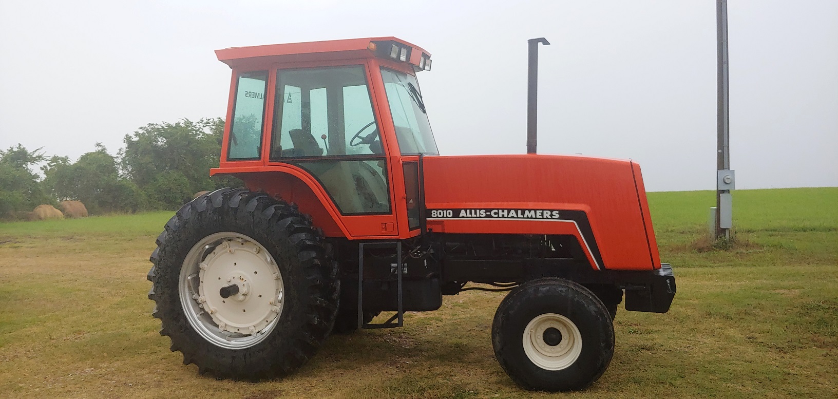

Just got delivered and it brought rain.  Real rain.  Decided to pull the trigger on the 8010 Pd.  It's much bigger than my 185's.  Should be nice.  Will keep my eyes out for 6080 next.

Wow, that looks as if it was just pulled out of a time capsule.

Very nice looking outfit! Thumbs Up

That sure is pretty! Hope it runs as good as it looks too! Congratulations! First projects for it after it dries up??

It's beautiful on the out side.  The cab is pretty clean.  Has some moisture issues from from bad window and door seals.  A little disappointed on few things.  I bought the tractor from a long time dealer collector.  He overstated some of it's condition, but it is 37 years old.  Main worry is the AC he said his mechanic of 41 years went through it and said the AC was perfect.  Except it only cools when you but a garden hose to the condensor in the front.  The blower on high sounds like it's getting ready to jump out.  Some lights don't work which he was proud to say they all worked.  All in All the tractor is sound mechanically from all appearances.  We'll find out.  I will call him on Monday and see what he says.   I bought the tractor seeing only pictures and had it shipped down.   It has 4600 hours.  I'm going to take the top off and clean everything inside and replace the stereo and speakers while I'm there.
